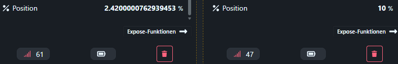

I have two W600 via Zigbee2MQTT installed and received 0.0.0_2543 on both yesterday. Zigbee2MQTT was updated to 2.7.2 with the former firmware _1839 already.
Since _2543, the valve position only shows a maximum of 10% or an unrounded percentage. 10% seems to be actually 100% since the radiator is hot.
I just updated 4 of 5 W600, and im receiving now positions like 3.3700000762939455%. The local temperature is 19°C actually on this trv, and the setpoint is 21°C. So 3.37% is pretty false. Did they probably changed the decimal numbers? like 0.1?
That could be the only valid reason.

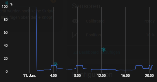

I experience the same issue. Yesterday, I updated my W600 to version 0.0.0_2543 (Zigbee).
At 8:30am I opened the window to ventilate the room. After closing the window the thermostat opened fully but the valve position was set to (only) 10%.
In my opinion the valve position needs to be multiplied by 10 (since 0.0.0_2543).

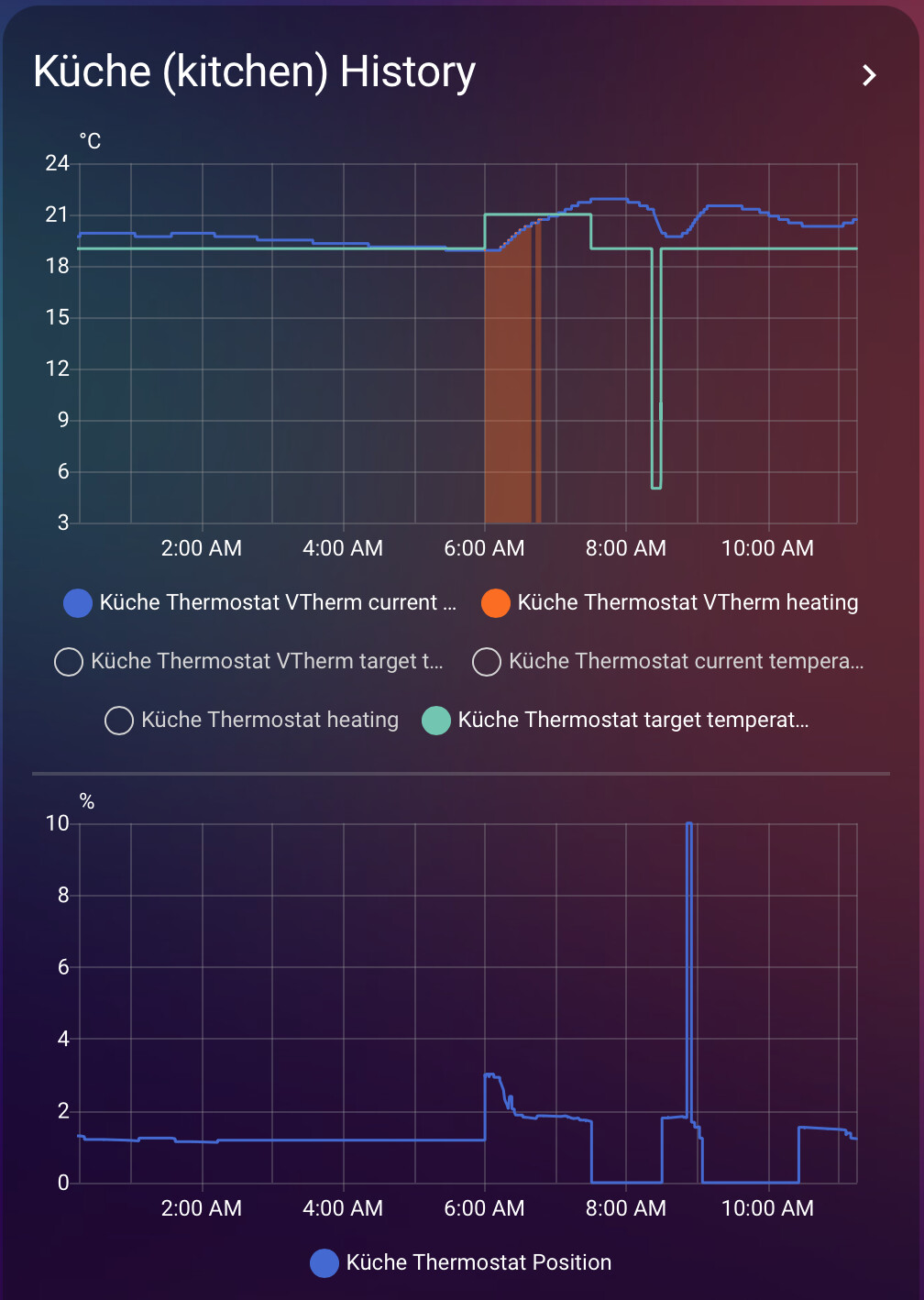

Have had the newest update for a few days. And it’s does seem to be better? But in a different way.
It now over heats my rooms by 2C. So iv got it set to 20C and my T1 temp sensor typically is saying it’s 22C. It then turns off and cools down again to a out 19.5C before turning the valve on again.
So the 2C dispersion still seems to be there, but unlike before where it would only heat up to just above 20C then allowing it to drop to say 18C before turning on again it’s doing the same thing but just over heating the room more. I mean this is more comfortable, but doesn’t seem like a good solution as do still feel the chill difference between the two temps.

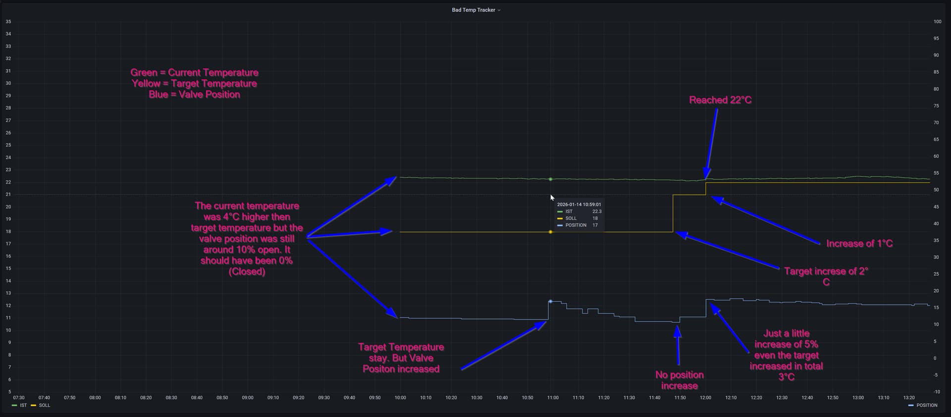

I checked them since yesterday. At all it looked abit better. But still dont understand the algoryhtm:
You can see the current Temp is 4°C above the target, and the valve position wasnt fully closed and it even opened afew percent more. without any interaction or changing setpoints.
I dont know if its maybe related because of the local measurement and the local calibration. Maybe with an external sensor input it would be better… I dont know.
I guess @AqaraOfficial should still improve the algorythm and even enable the external input!
An addition to the TRVs behaivor. I think this is unacceptable. thats around 4hours of graph shown in the screenshot.
What do you guys think about this one? Ive submitted a support ticket because of this.

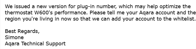

Aqara support contacted me back because of my ticket. This was their answer:
I told them im using 0.0.0_2543 already. Hopefully this will be a newer firmware then 2543.
