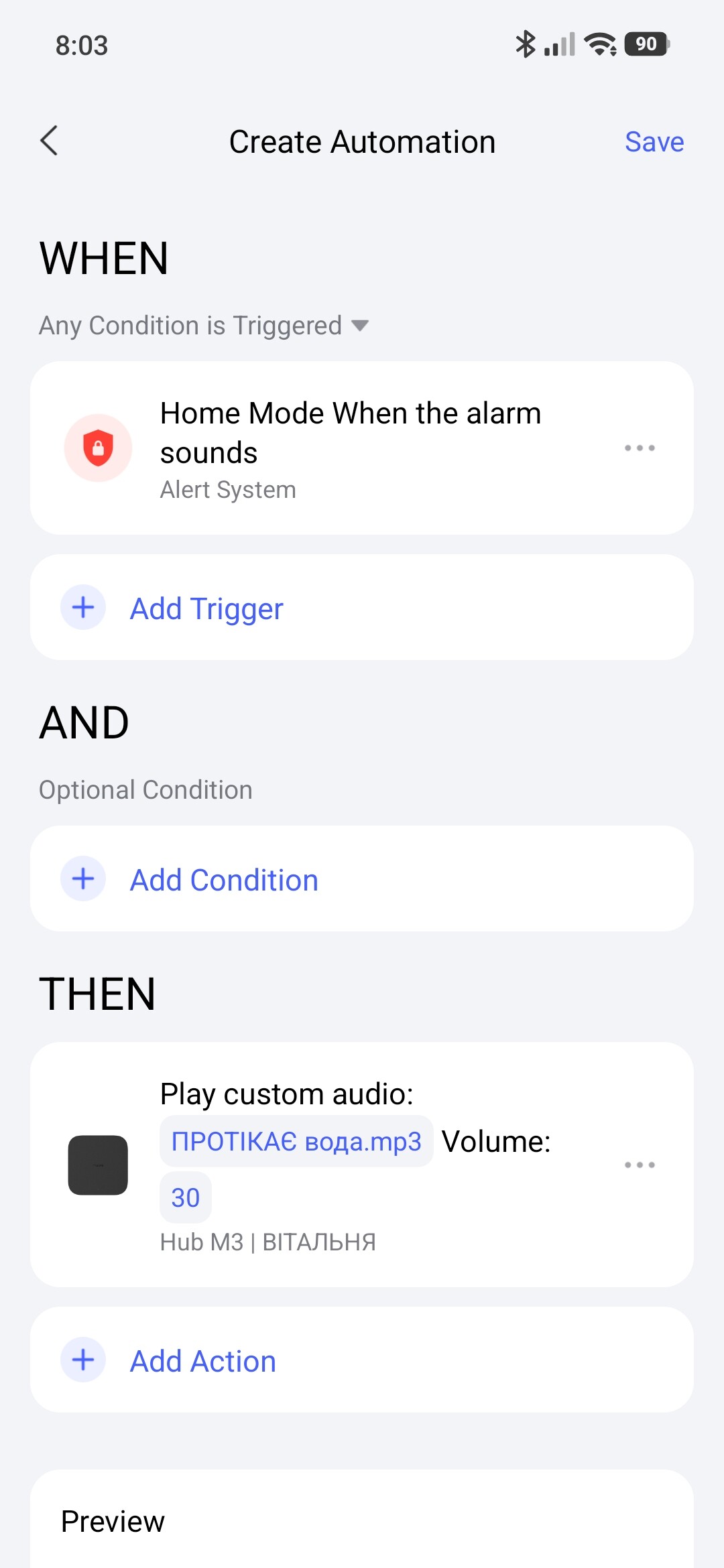

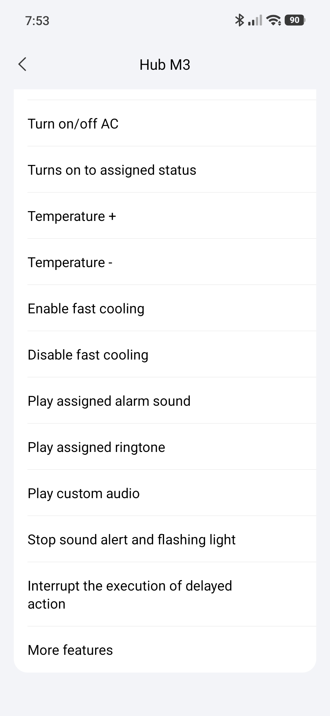

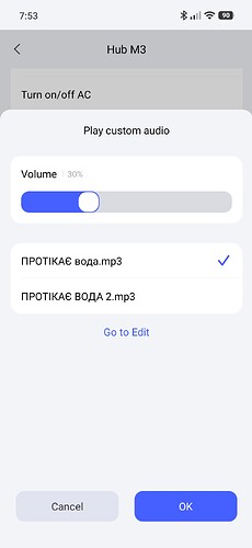

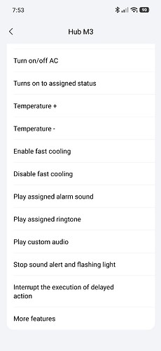

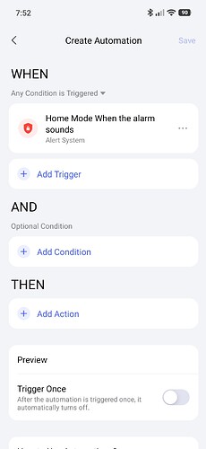

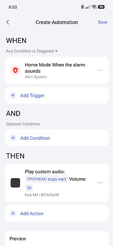

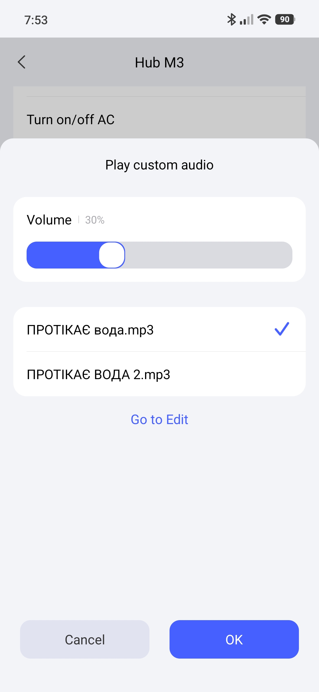

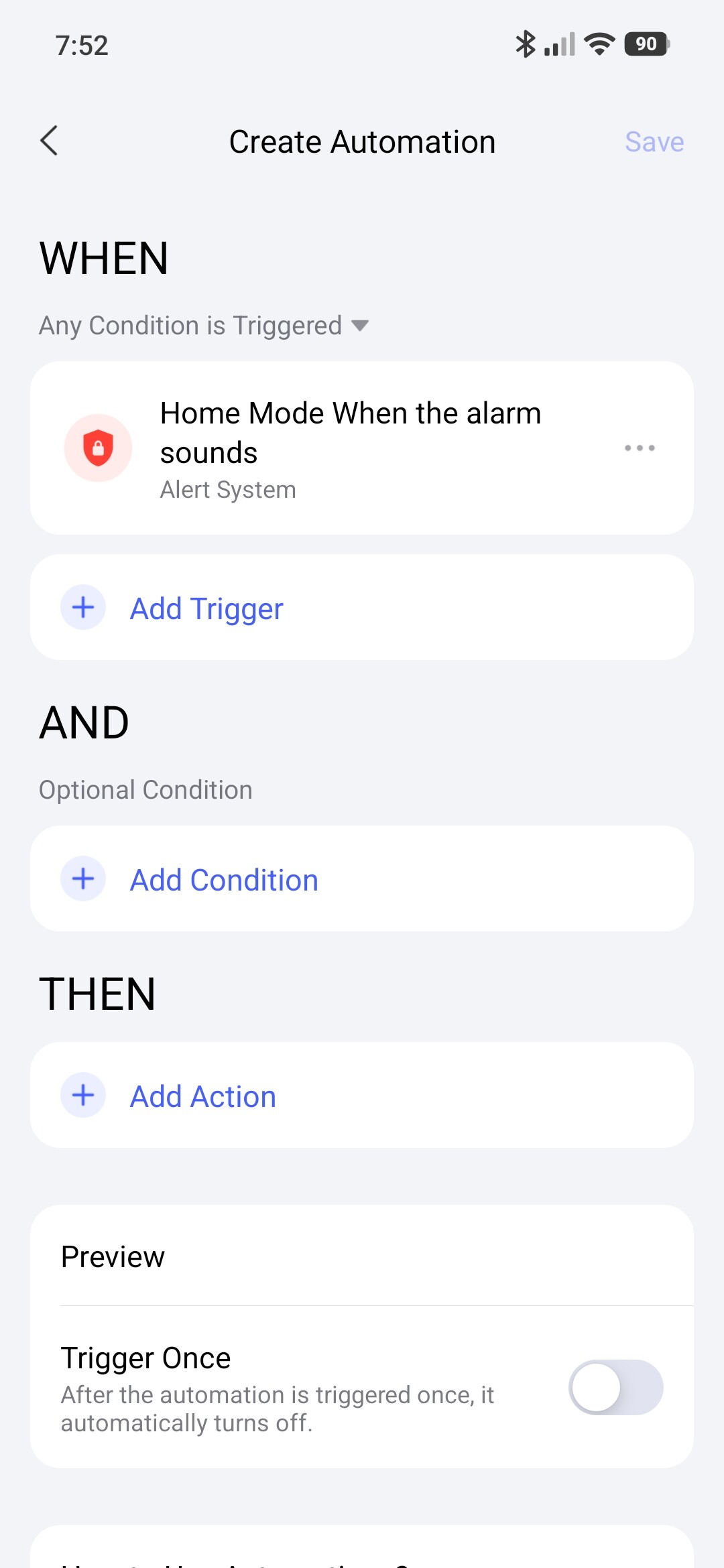

Hello, I checked. Yes, it is impossible to add your own melody from the security alarm settings. I think this is due to the possibility of synchronous sounding on different gateways. You can add your own ringtone from automation, I will say even more, you can adjust the sound from 0÷100%, in the security alarm settings.
Ok I will try this method.
