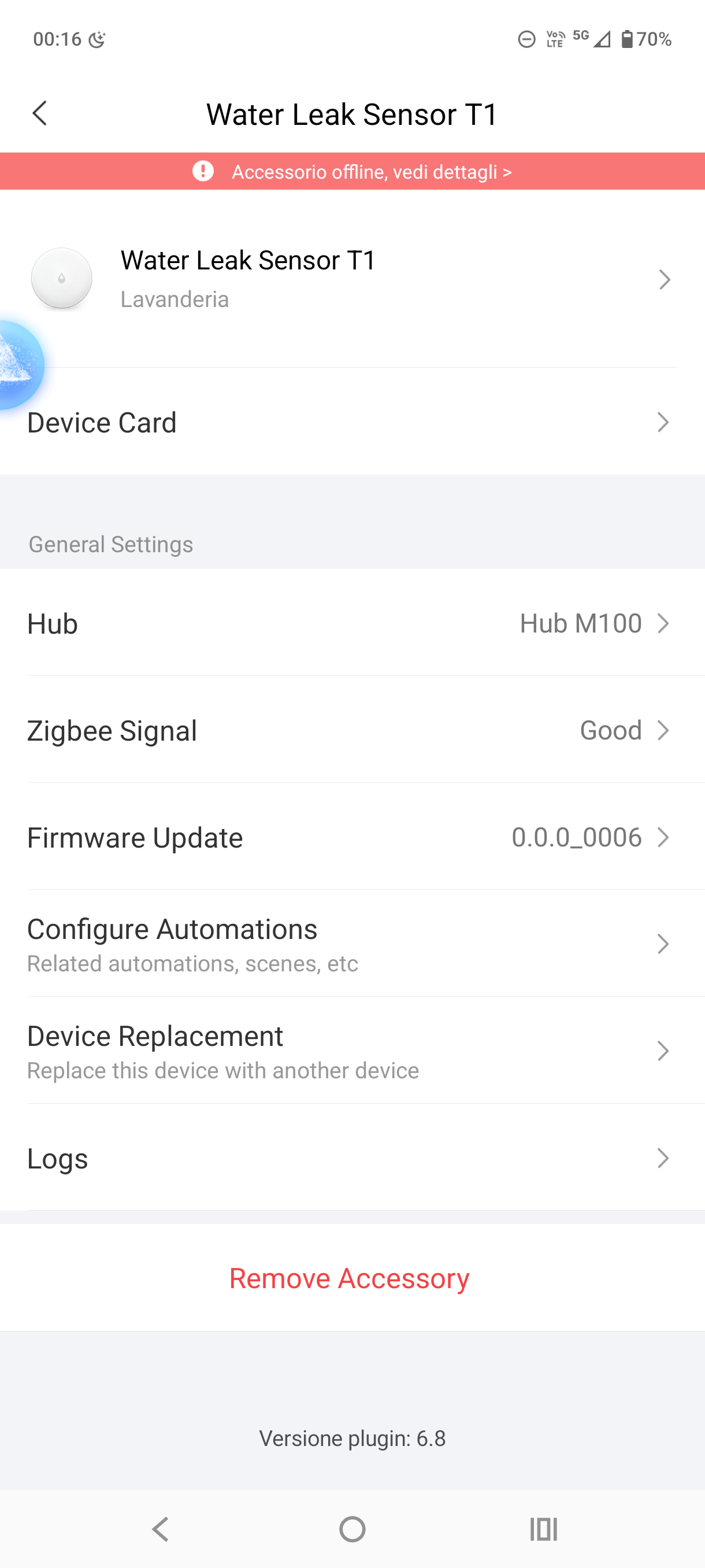

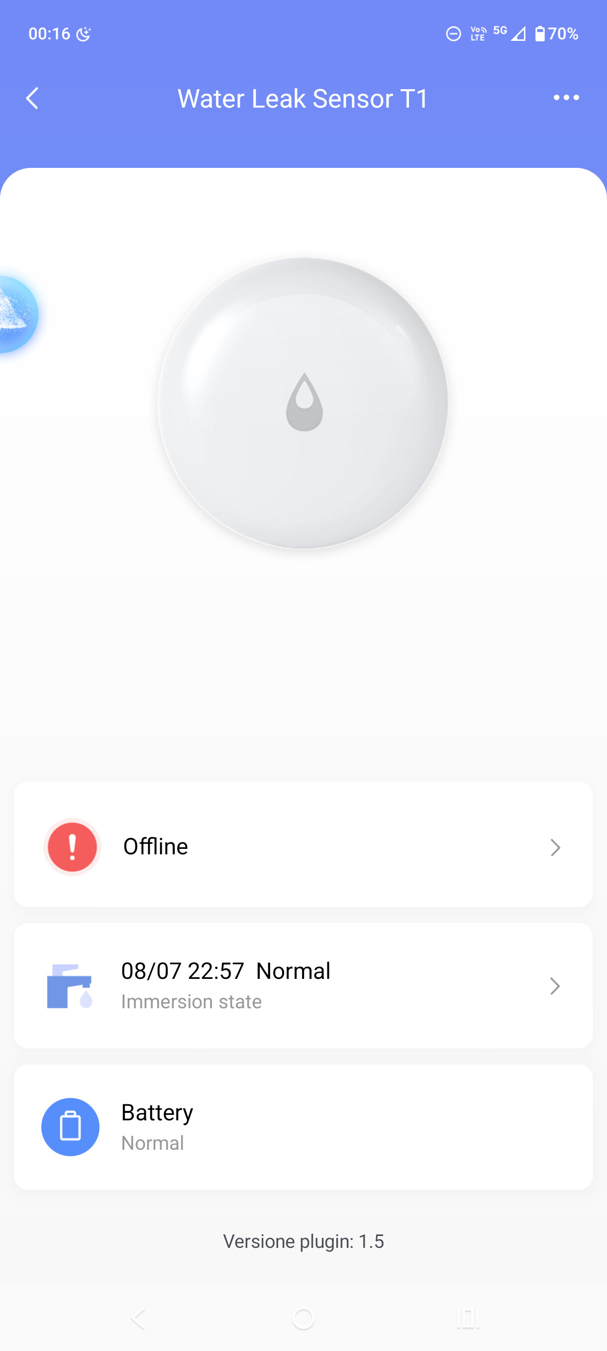

The water sensor has disconnected from the M100 Hub twice in one week.
I left it on the table (not under the hatch) and the distance is less than 2 meters from the hub!
I also changed the battery, even though the previous one gave a good level.
If I press the sensor to make the little blue light appear, it then reconnects by itself
M100 firmware Is Latest Version: 4.3.8_0023.0017.
At this point, could the sensor be faulty?
Although I don’t understand why it worked so well for 3/4 of its life, I never dropped it, and it hasn’t had to come into contact with water yet…

Hello, does the gateway have constant power? This is a prerequisite for stable communication.
If the sensor falls off, it is not necessary that it has left the system, it may be in standby mode. This can be checked by soaking its contacts in water.
This situation occurs when the gateway is turned off and then turned on again.
gafich10 thanks for the reply.
The M100 comes with a generic 2A USB power supply, I can try putting a Xiaomi power supply on it, maybe it’s better, but the M100 has never lost the Wifi connection.
wifi signal strength is -48 should be good.
The Zigbee channel is 20, can I change it or does the M100 choose it automatically?
if I understand correctly you are telling me when the water sensor goes offline to try with water to wet its contacts and see if it comes online … I understand correctly?
so it would be normal for the sensor to go offline after a while, as if it went into sleep mode…
I bought the sensor in April, and up until 2-3 months ago it never did this.

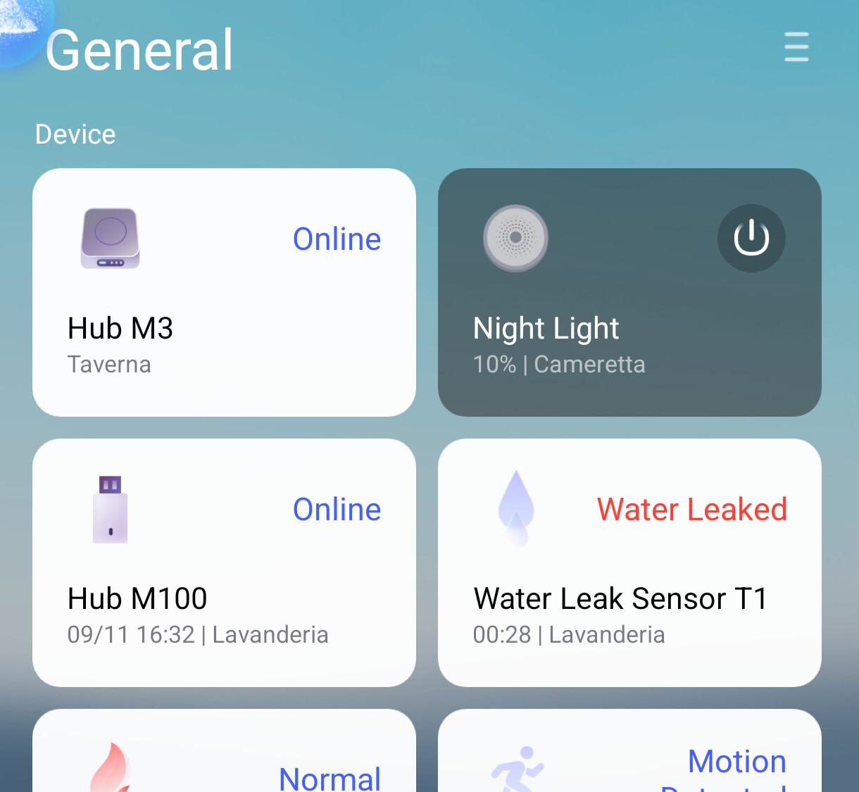

I tried wetting the water sensor contacts, and after a good minute it came back online and reported the fake flooding.
How do I remove the alarm in the sensor icon now?..or does it automatically clear after some time by app?

Hello, the alarm signal disappears after about 5 seconds (for me) after the sensor contacts dry out. The application sometimes gets stuck, you just need to refresh (swipe) the application window. Event notifications are very dependent on the quality of the Internet.
The speed of operation is best seen when you make automation for the lamp (I see you have it on the screen): wet->on, dry->off.
