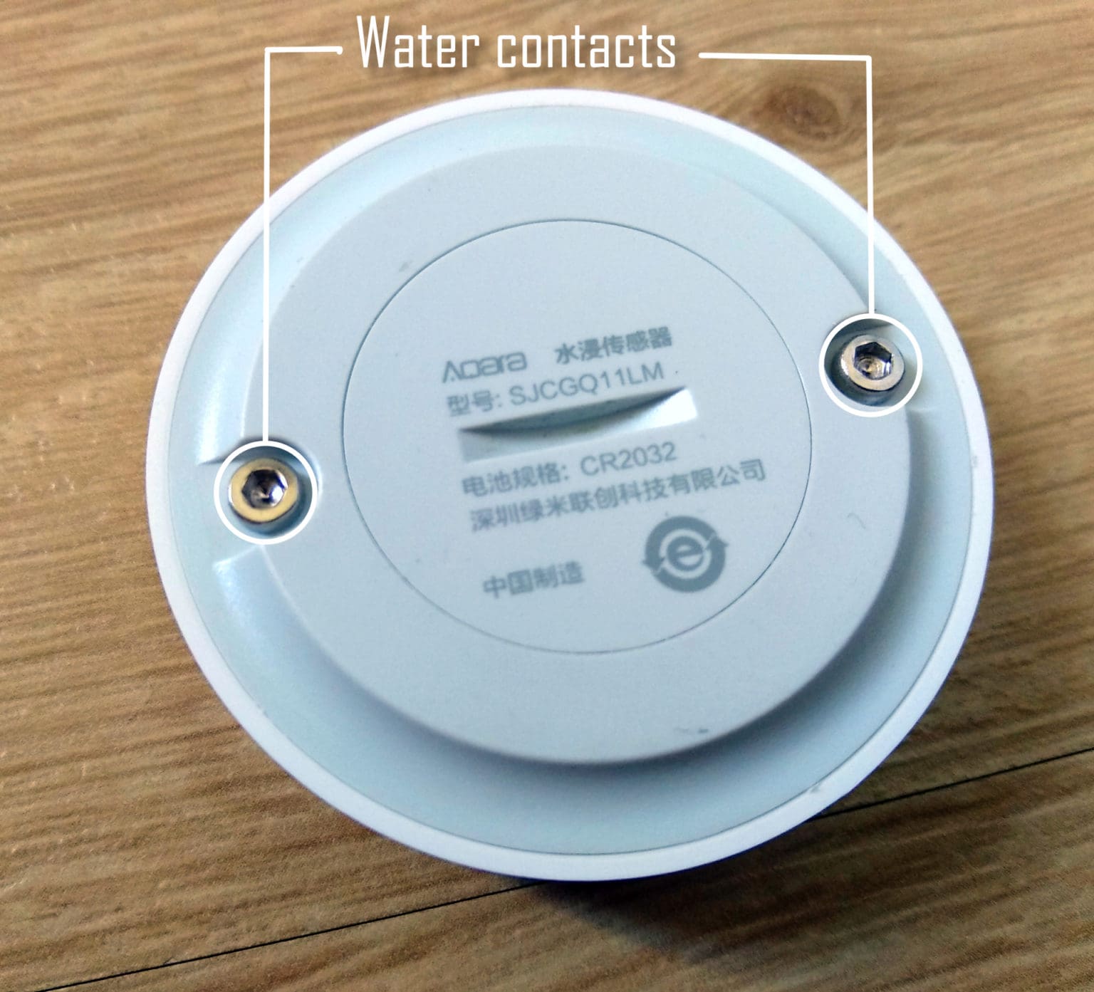

The Aqara leak sensor is an underestimated device. The main advantage of this sensor is the electrodes that can be unscrewed and a wire that can be connected to the desired dry contact. We get a remote informer about the state of the surveyed signal.
Fig.1

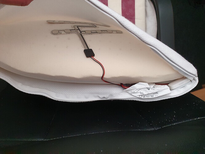

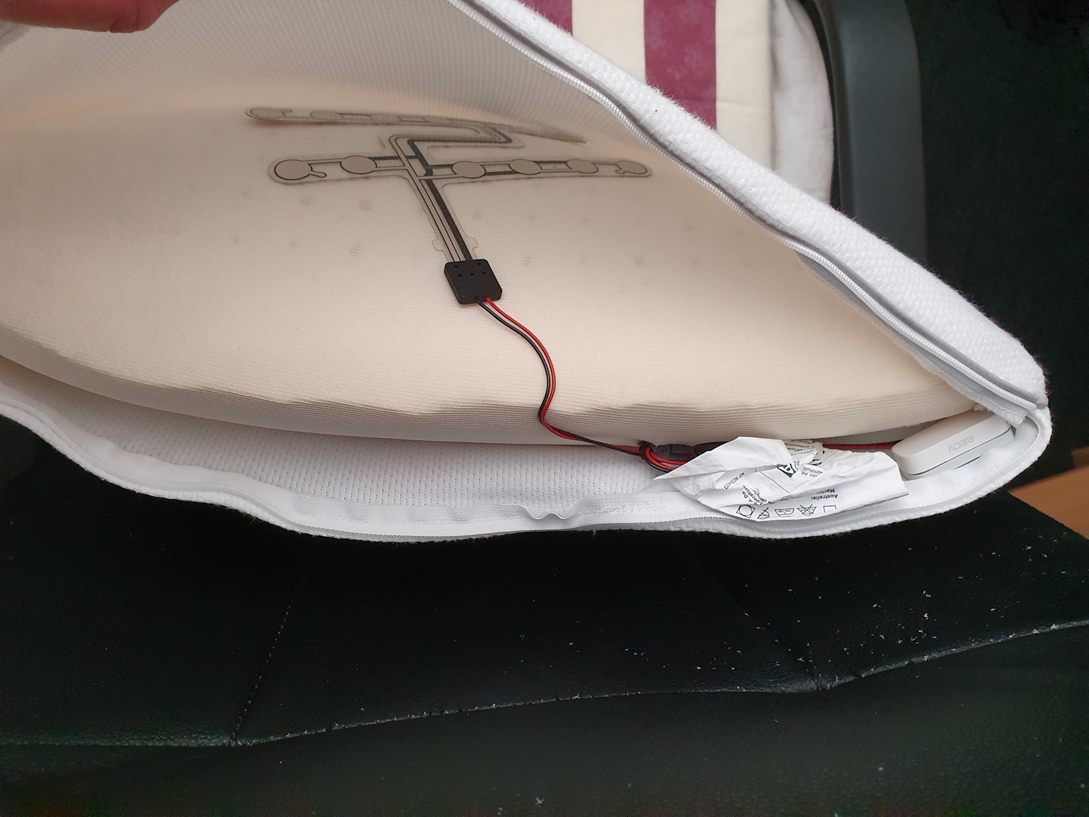

First hack I saw for these a while ago was a DIY pressure pad sensor:
Yeah, I have a few pressure sensors hooked up to Aqara leak sensors for chair occupancy. mmWave makes this somewhat unnecessary nowadays, but I see no reason to re-implement a functioning system.
Others have done a similar thing for bed occupancy, too.
