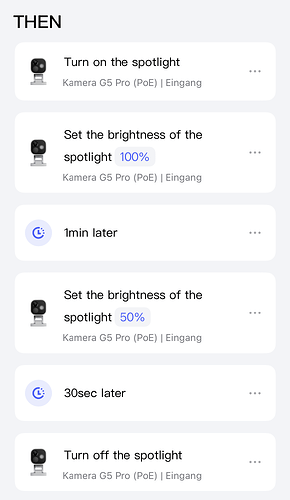

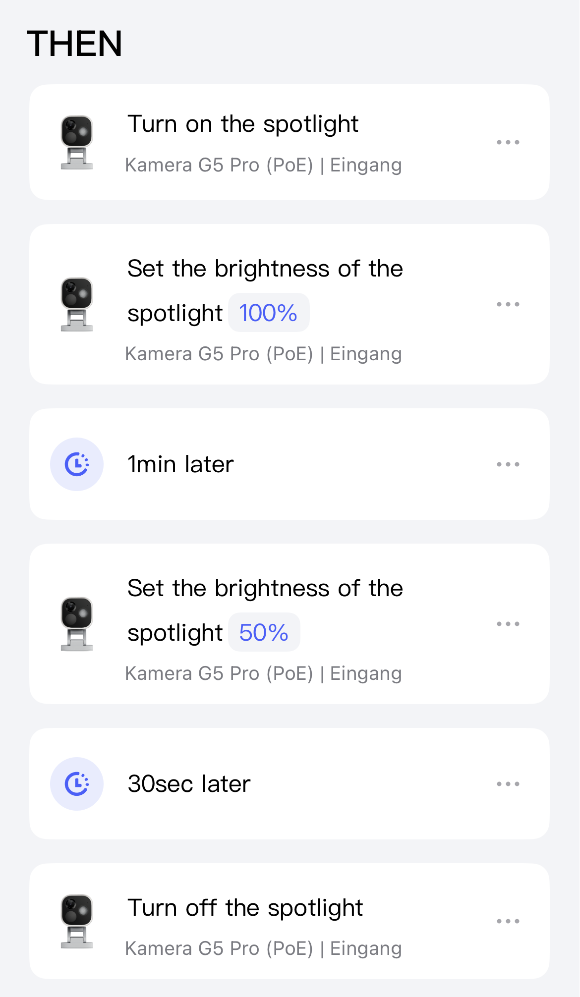

With this, you can do something like what is shown in the picture here:
I always do it this way for motion sensors that control lighting. That way, you see the light dimming and know it’s about to go out.

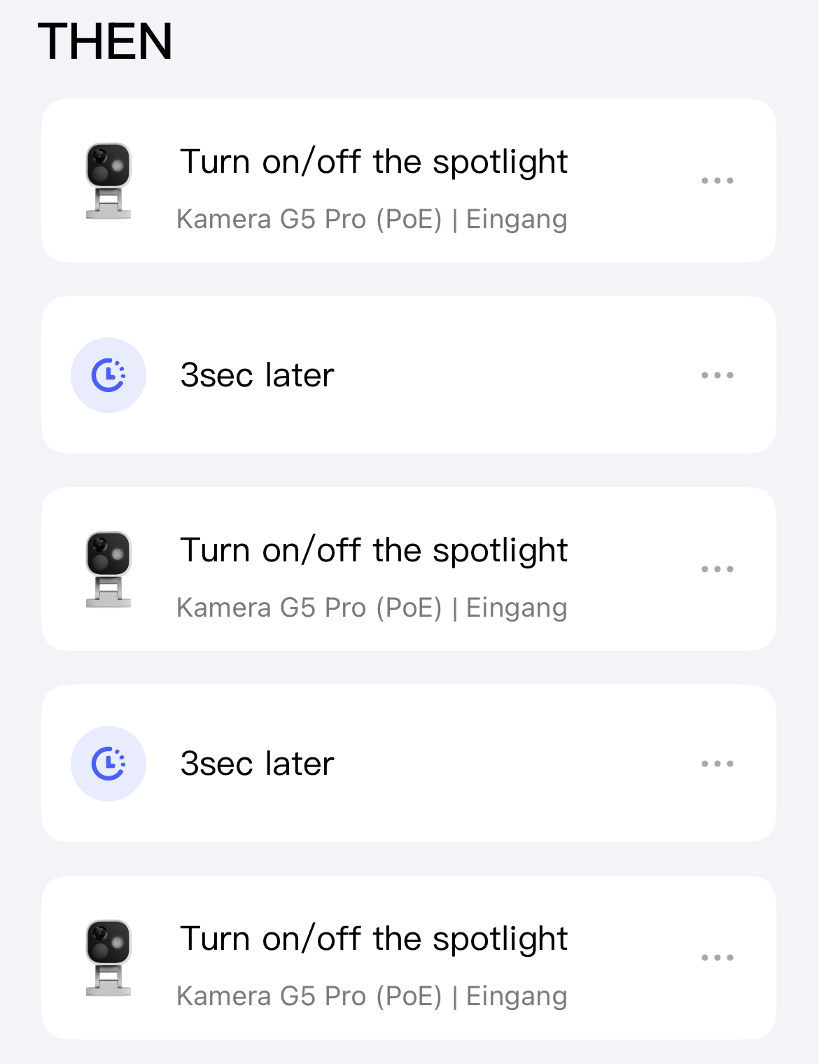

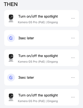

You can also make it flash. Afterward, it will return to its previous state (whether it was on or off). Just make sure to use an even number of repetitions, meaning at least one more than shown in my picture.
