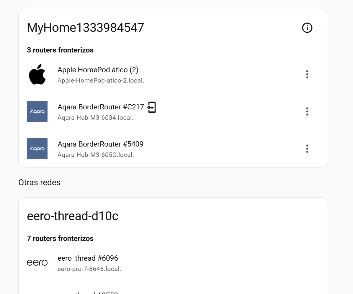

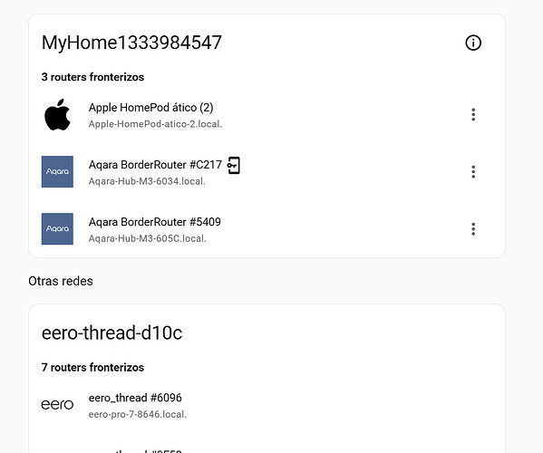

I use Home Assistant mainly as a bridge, not my main UI. It connects my Hikvision gear (security, cameras, intercom) and solar system to HomeKit. Most of my smart home is Aqara on Zigbee, with other brands onboarded via Matter.
I first merge my Aqara M3 hubs into the HomeKit fabric—so Aqara and Apple devices share the same network—then link them via Matter for full interoperability.
Other systems (Hikvision, Fronius, Tado, MQTT, etc.) go into Home Assistant and are exposed to HomeKit through the HomeKit Bridge. This way, HomeKit is my main control layer: a Hikvision PIR door contact can turn on Aqara Wall Outlet H2 EU lights, or low solar battery can automatically cut power to selected Aqara Wall Outlet H2 EU plugs or Aqara Dual Relay Module T2 relays.
Since the Apple HomePod, Aqara M3, and the mini-PC running Home Assistant all operate on both 2.4 GHz and 5 GHz bands, my IoT devices don’t suffer from Wi-Fi band conflicts. This is because their communication happens over dedicated sub-layers such as Zigbee, Thread, RTSP (Real-Time Streaming Protocol), ISUP, and 6LoWPAN, which keep them isolated from standard Wi-Fi traffic.
