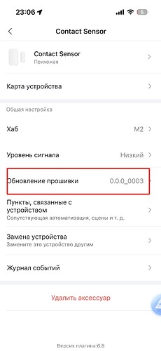

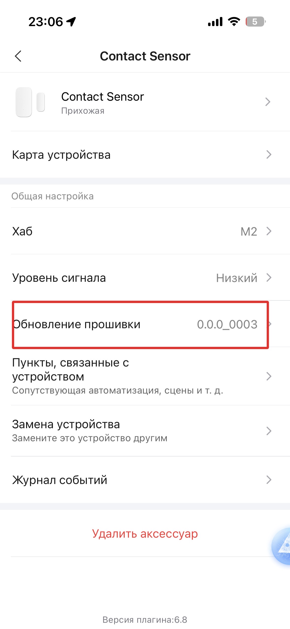

What is your sensor model? To update the firmware you need a hub from aqara and the Aqara home app.

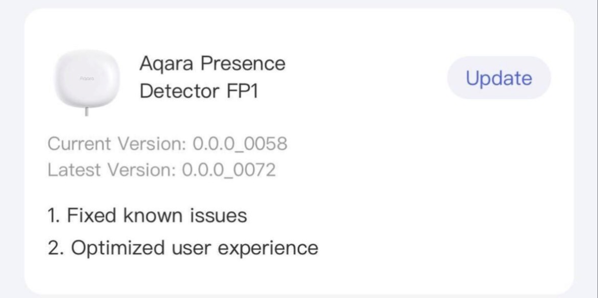

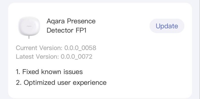

Are there FP1 and or P2 updates? Where, how?
Hello , There is no update for the P2 series sensors yet, and for fp1 there is a new firmware v72, but so far I have seen this update on the Material China server.
