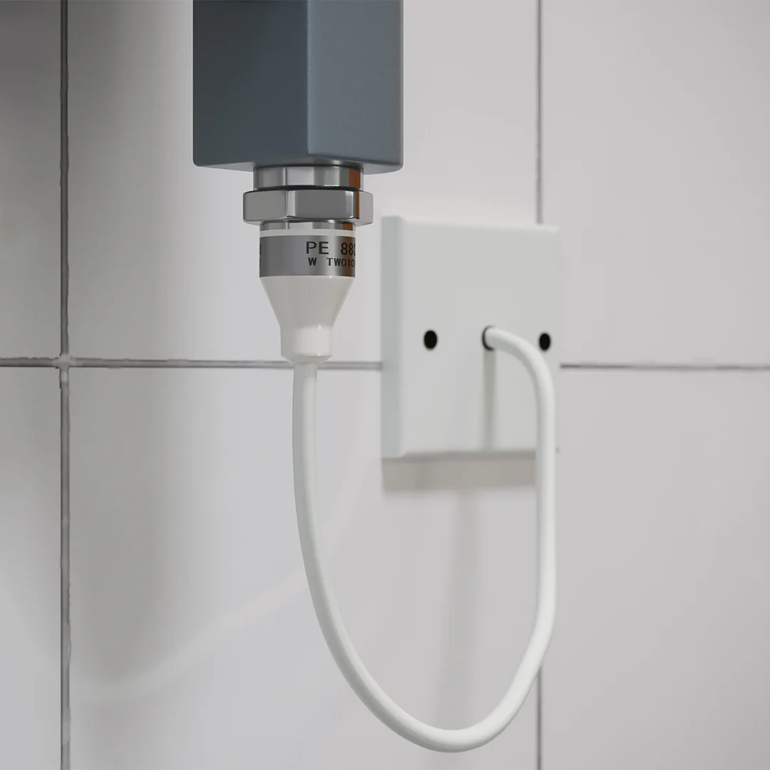

In my bathroom I have / had 2x Heatmiser neaStat-2 V2 controllers and 1x Heatmiser neoHub Gen 2 Wi-Fi gateway which allows them to be controlled on-line.
One Heatmiser neaStat-2 V2 was for UFH and I have now replaced this with a W500. It was only controlled by a floor temperature probe and the W500 works great.
The second Heatmiser neaStat-2 V2 controls an electric towel rail element which acts as an on/off switch based on time and does not use any temperature input at all.
I’m now looking to convert setup the second Heatmiser neaStat-2 V2 that controls the electric towel rail element to Aqara and needing some advice.
What would be the most appropriate device and setup to control the electric towel rail element? T2 Relay? Another W500? Something else?
Thanks!
Hello, judging by the picture you are from England (sockets in the bathroom are prohibited). A T2 (T1) relay will suit you, the dryer does not have a powerful load tag. You can use a wireless button as a control tool. I described controlling the dryer by time in my lesson. Automation 2.0, lesson 6, bathroom automation on a working example
