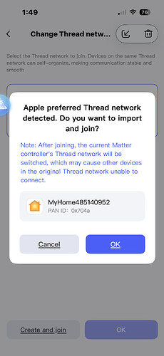

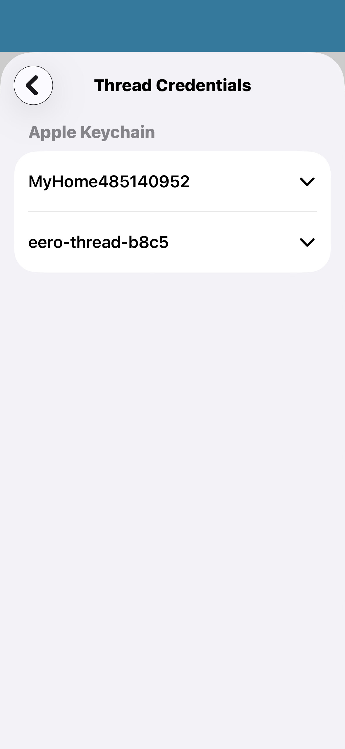

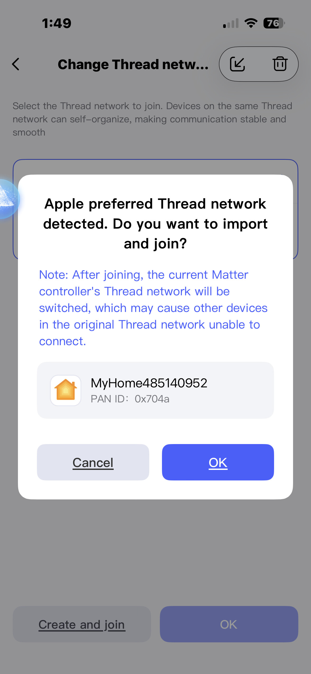

Why is the thread network menu locked to Apple Thread Networks?
I’m trying to change my M100’s thread network to use the eero thread network since I have multiple eero products spread around my house and they each extend the thread network, but when attempting to import the thread network, it says that it found an Apple thread network and it’s preferred to use, but does not offer an option to use other thread networks in the credentials even though they are in the Apple keychain, I can’t remove the Apple thread credentials as when I try it never gets removed and jus stays there, how can I get it to use the eero thread network?
