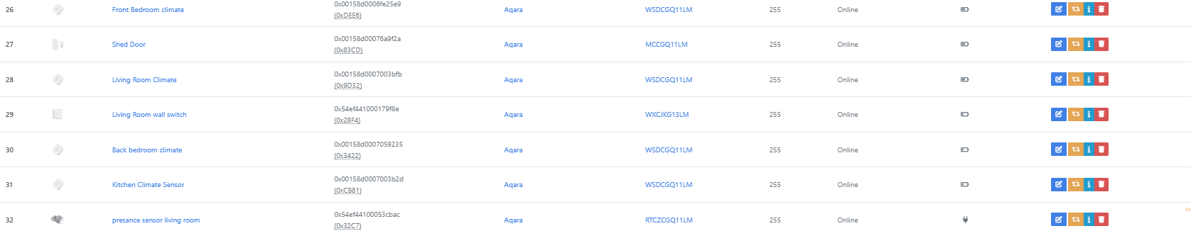

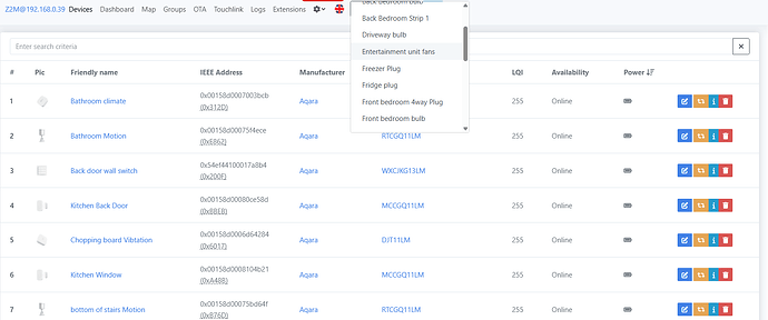

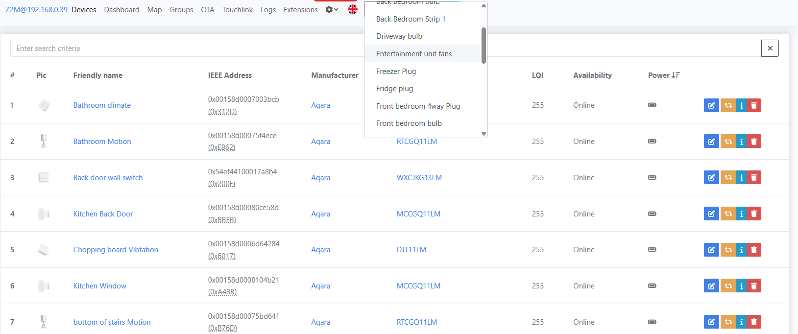

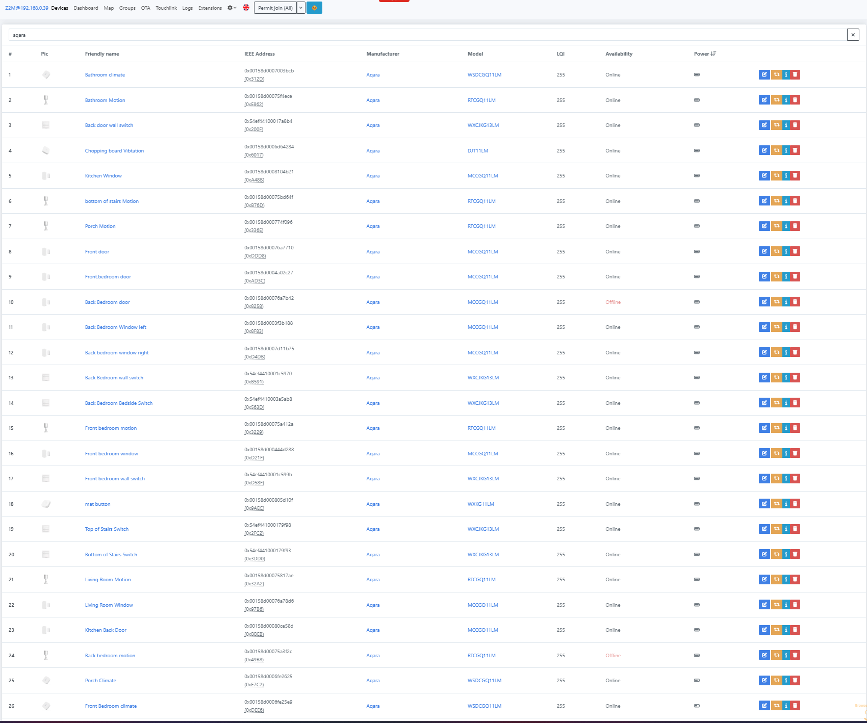

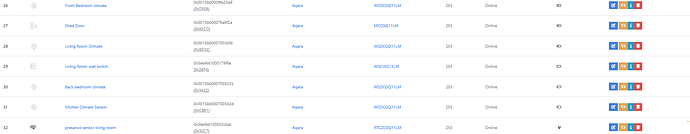

Zigbee2mqtt works fine with aqara zigbee products I should know
these are just the aqara product :slight_smile:
edit just reminded me screen shot of this, I forgot to change battery in the back bedroom door sensor and motion when I done the others (60% of these were very low about 3 to 4% yesterday, but had done well at 18 months or so.

Sorry about late reply was camping for a few days, I use a combee 2 stick as its been the most repliable for me, in total I have 64 devices connected through zigbee2mqtt.
The setup was easy as I run Homeassistant OS, so a case of just ticking advance user to enable the addon menu, then zigbee2mqtt there, the instruction and setting config our pretty straight forward you start it and then start adding devices.
I add all the mains powered devices in each room first so that i can use the pull down list to add the battery devices to that router (closes one to the battery device).
this keeps the network stable and I have not had issues
