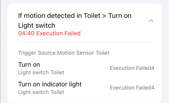

I am having some issues when a simple if motion then turn on light automation.
In the logs of the automation I see that the automatons fails to be executed.
Is there a way to access debug logs or understand better why the automation failed?

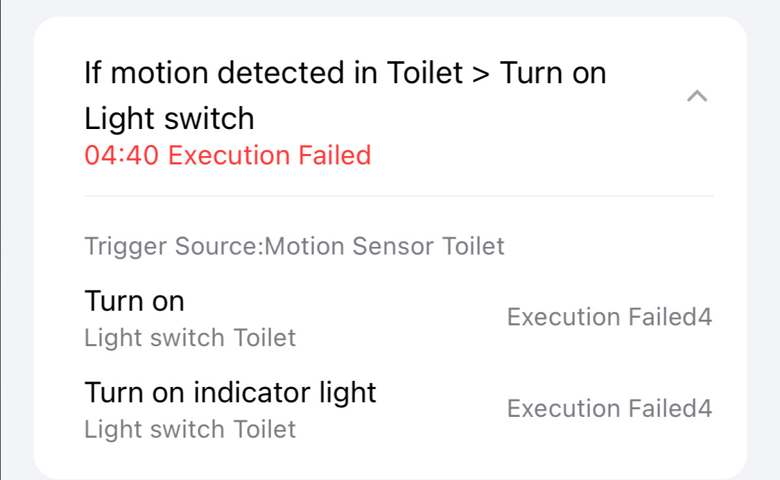

Hello, I had this happen when there were conflicting duplicate automations. One worked then didn’t. Do you have a group of automations or one that is related to sensors and actuators?
thanks for your tip. This brought me to the right direction: Both of my buttons on my relay switch had the same name. Making them unique solved this issue!
