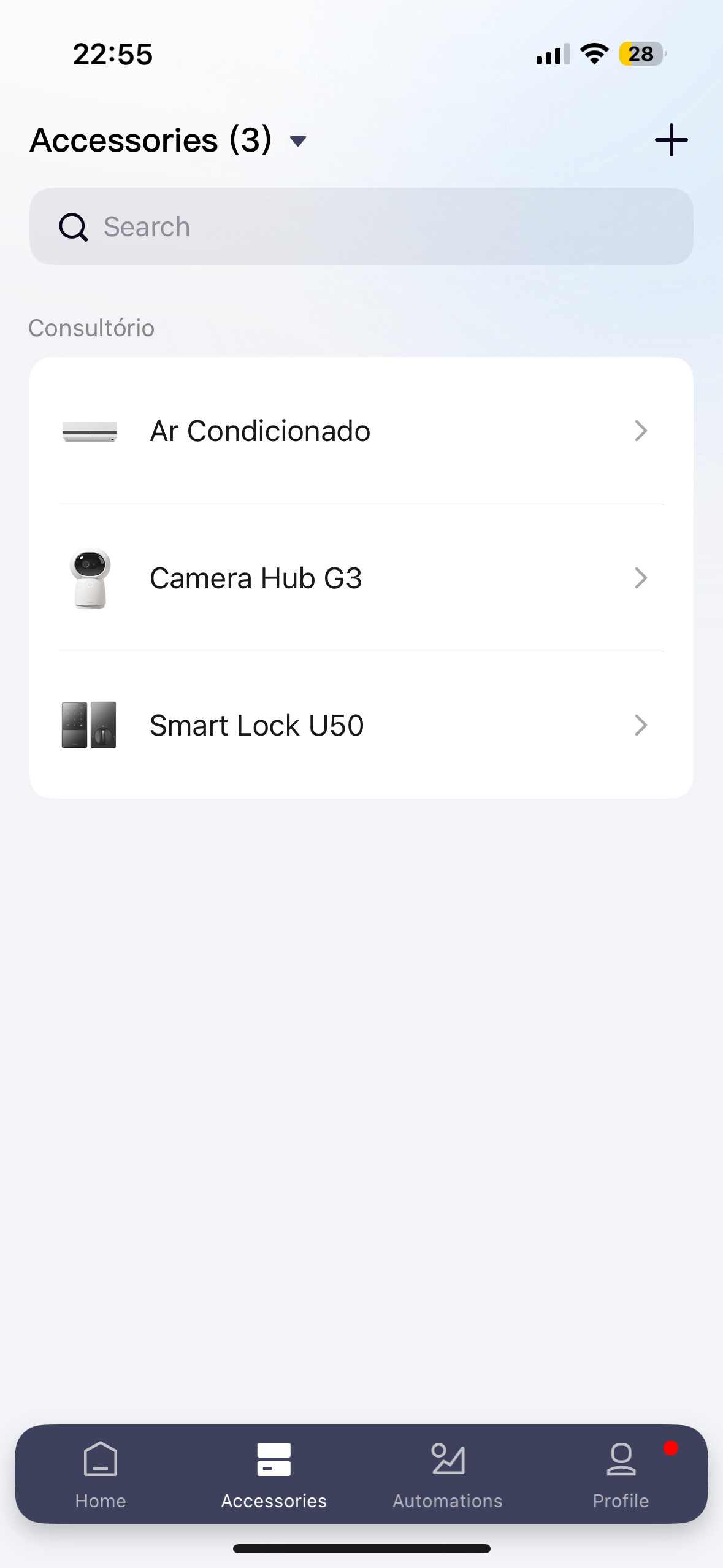

I have the following aqara devices
Camera Hub G3
Air Conditioner (Samsung) - IR Connection
SmartLock U50

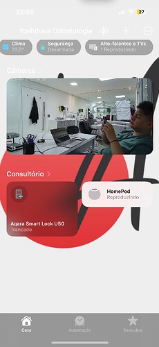

The camera and the smartlock show in Homekit, but the air conditioner does not. Is this due to the IR connection?

Hello @andre_yoshihara Unfortunately, the G3 camera will not be able to pass your air conditioner with IR to Homekit. For this, you need the M3 smart home center, it can pass the air conditioner to Homekit and even supports feedback.
@andre_yoshihara Another solution! You can create scenes in the Aqara Home app to turn the air conditioner on/off or adjust the temperature, then use the Scene Sync feature (Profile > Third-party Ecosystems > Apple Home) to sync these scenes to HomeKit. This way, you’ll be able to control the air conditioner in the Home app or via Siri.
