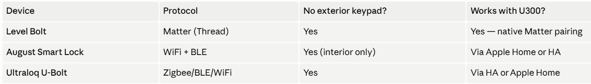

I have had a need in the past to do something similar but I was looking for a smart lock for storm doors. I am running several U300s and don’t believe they support any stand-alone deadbolts.
While the U300 may not support it, there are smart locks out there that will integrate through Home Assistant or Apple Home. A small automation could link the deadbolt with the U300. The U300 exposes a “lock.” entity so that automation could be as simple as unlock the deadbolt when lock. changes to “Unlocked”.
