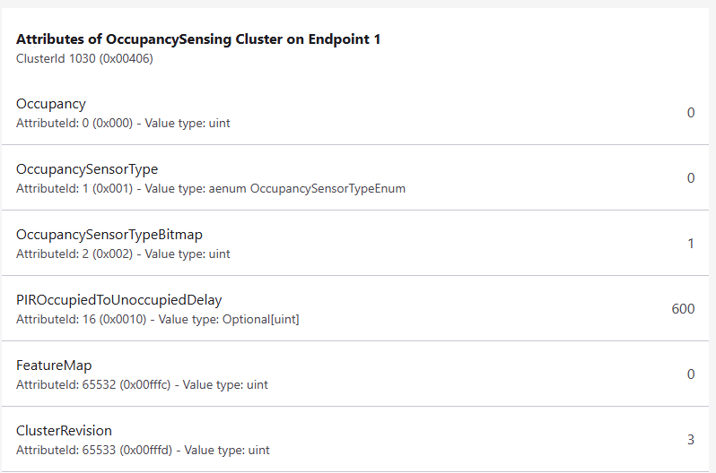

Could you add the attribute PIROccupiedToUnoccupiedDelay for next firmware release?
Eve motion sensor implements it already

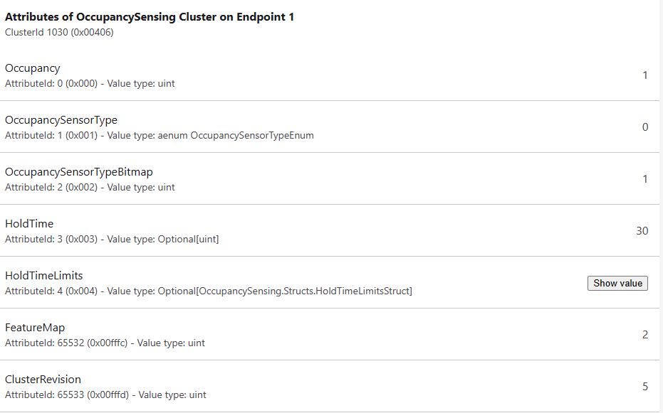

Attributes for OccupancySensing:
Thanks, that confirms the HoldTime part.
I guess it also includes the BooleanStateConfiguration cluster for the sensitivity level configuration with CurrentSensitivityLevel, which is the other new feature of the firmware.

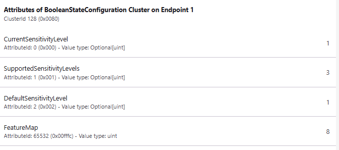

Yes BooleanStateConfiguration Cluster on Endpoint 1 too:
Perfect, thanks again!
