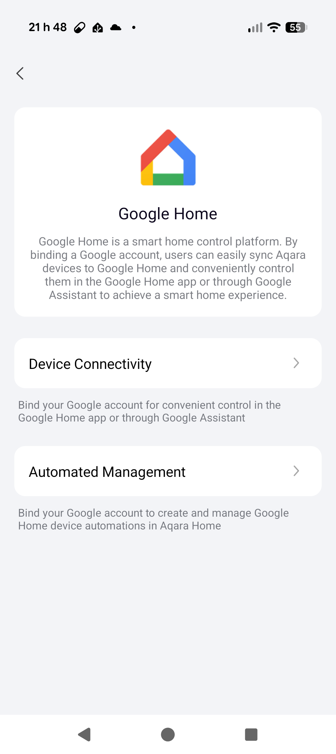

The Google Nest Mini (2nd Gen) does not have a Thread and cannot act as a Thread border router. Only certain devices like the Nest Hub (2nd gen), Nest Hub Max, and Nest Wifi Pro have a built-in Thread border router to connect to a Thread mesh network for Matter devices. Therefore, your Nest Mini will only connect to your home via Wi-Fi.
You can still use the Google Home option in the Aqara app to bind your device but it will work on the cloud.
