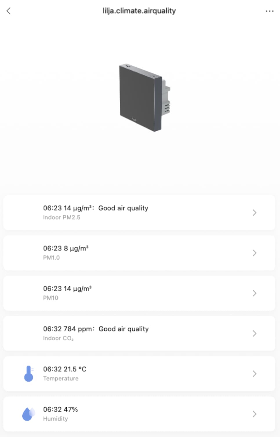

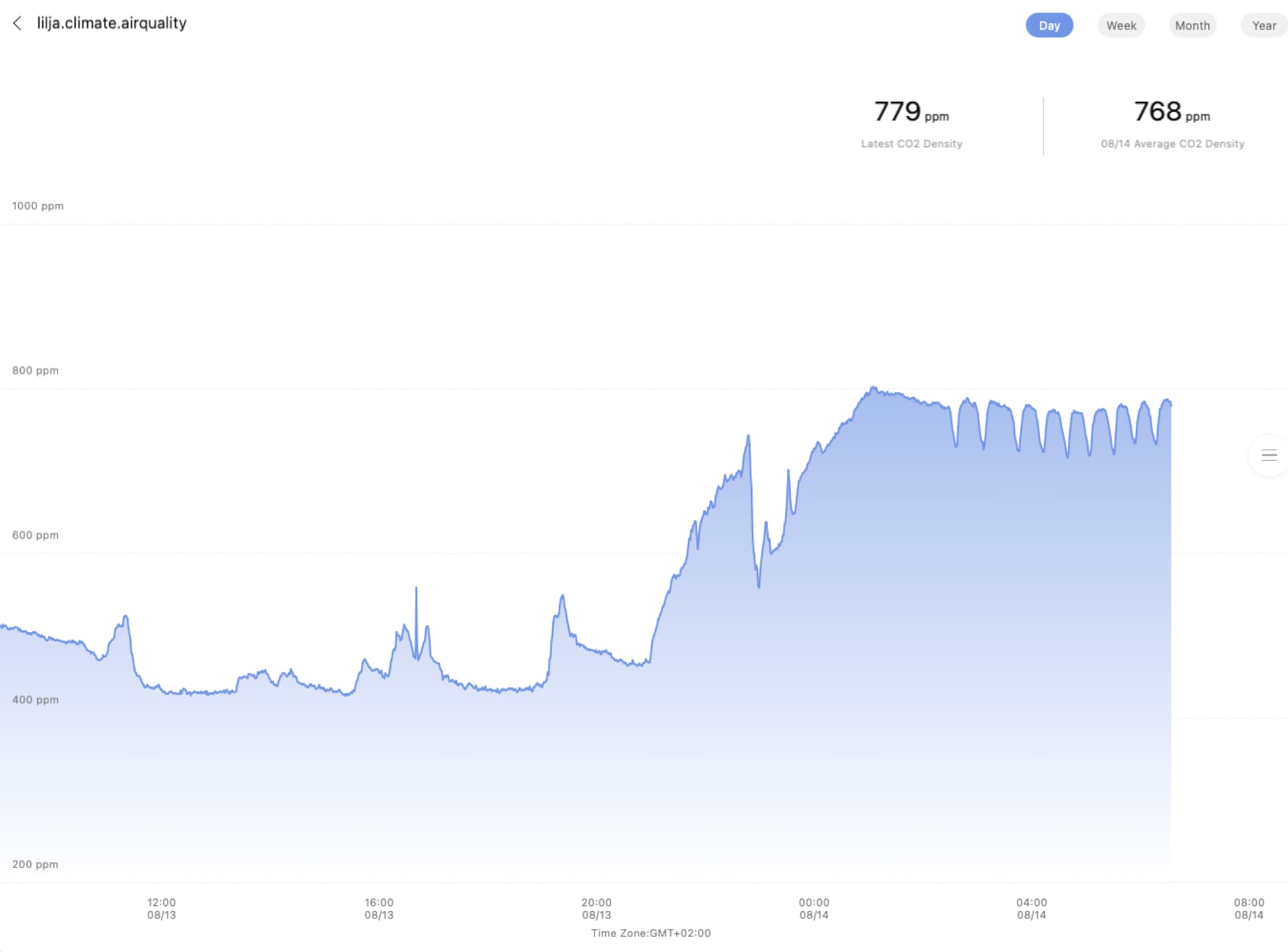

Yes, I do – although not in a completely straightforward way. I imported the Aqara air quality sensors (Aqara 空气监测面板 S1- Aqara 全屋智能) directly from China and installed them in bedrooms and bathrooms. These sensors measure temperature, humidity, fine dust – and most importantly, CO₂.
CO₂ is crucial for sleep quality: once the level goes above 1000 ppm, your sleep suffers. In those rooms, I’ve installed decentralized ventilation units (SIKUSphere). The air quality sensors send Matter signals to Home Assistant, which then controls the fans – deciding whether to pull air out or bring fresh air in, and adjusting the power level.
This way, I keep the air quality high and ensure a restful night’s sleep.
