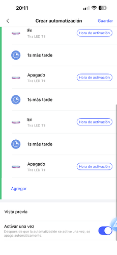

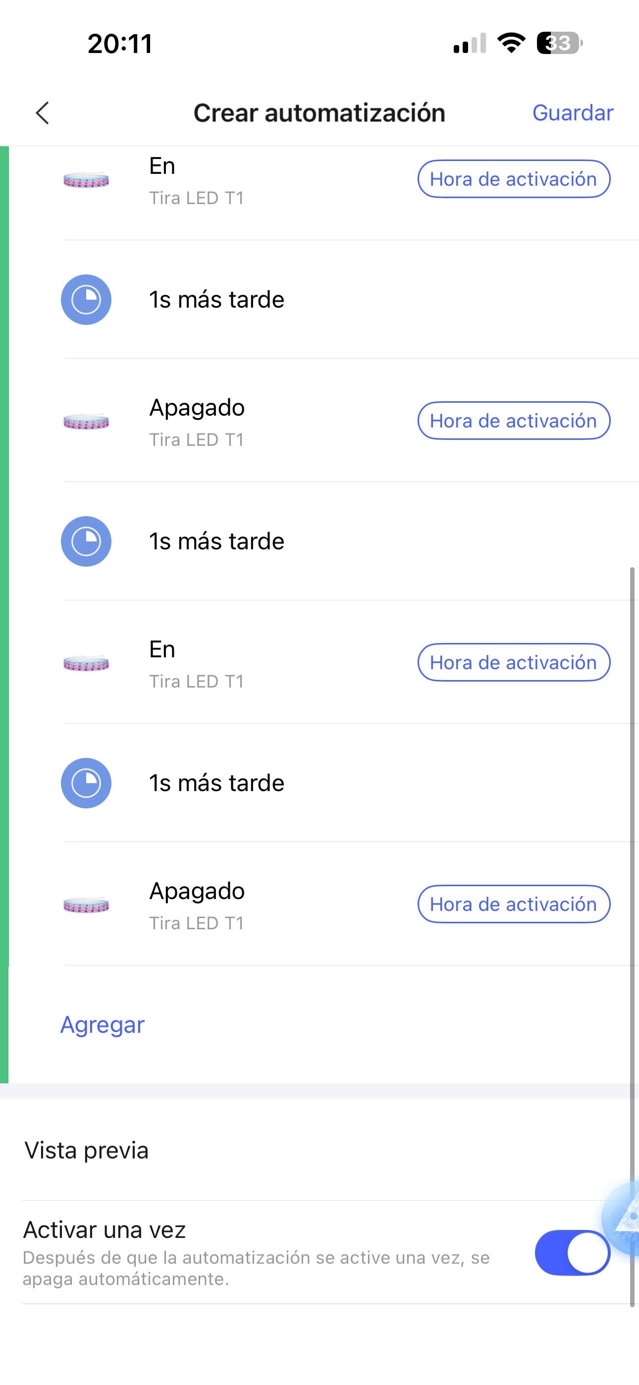

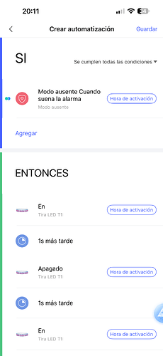

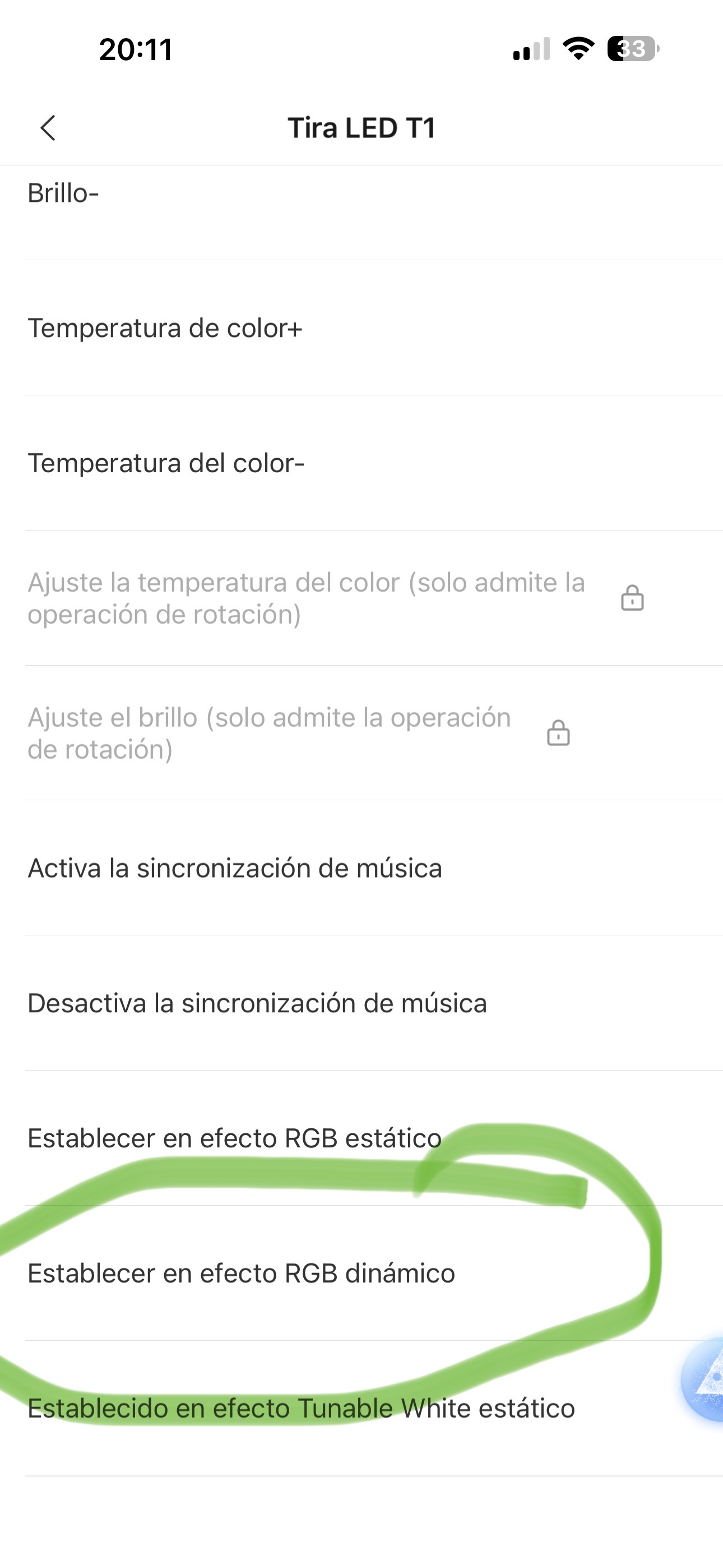

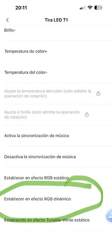

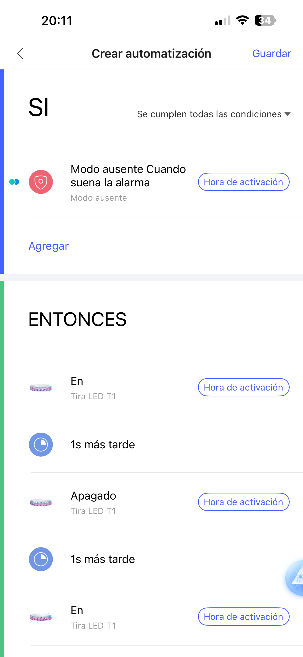

Hi @k_beach You can do it if you have an @AqaraOfficial switch, lamp or bulb or other Matter devices added on Aqara App.
There are some Aqara bulbs and lamps that let you set. THEN lamp/bulb dynamic RGB effect, if not, you can use de automation IF X alarm sounds, THEN lamp/bulb/switch ON, THEN 1sec delay THEN OFF, repeat it for the times you want
