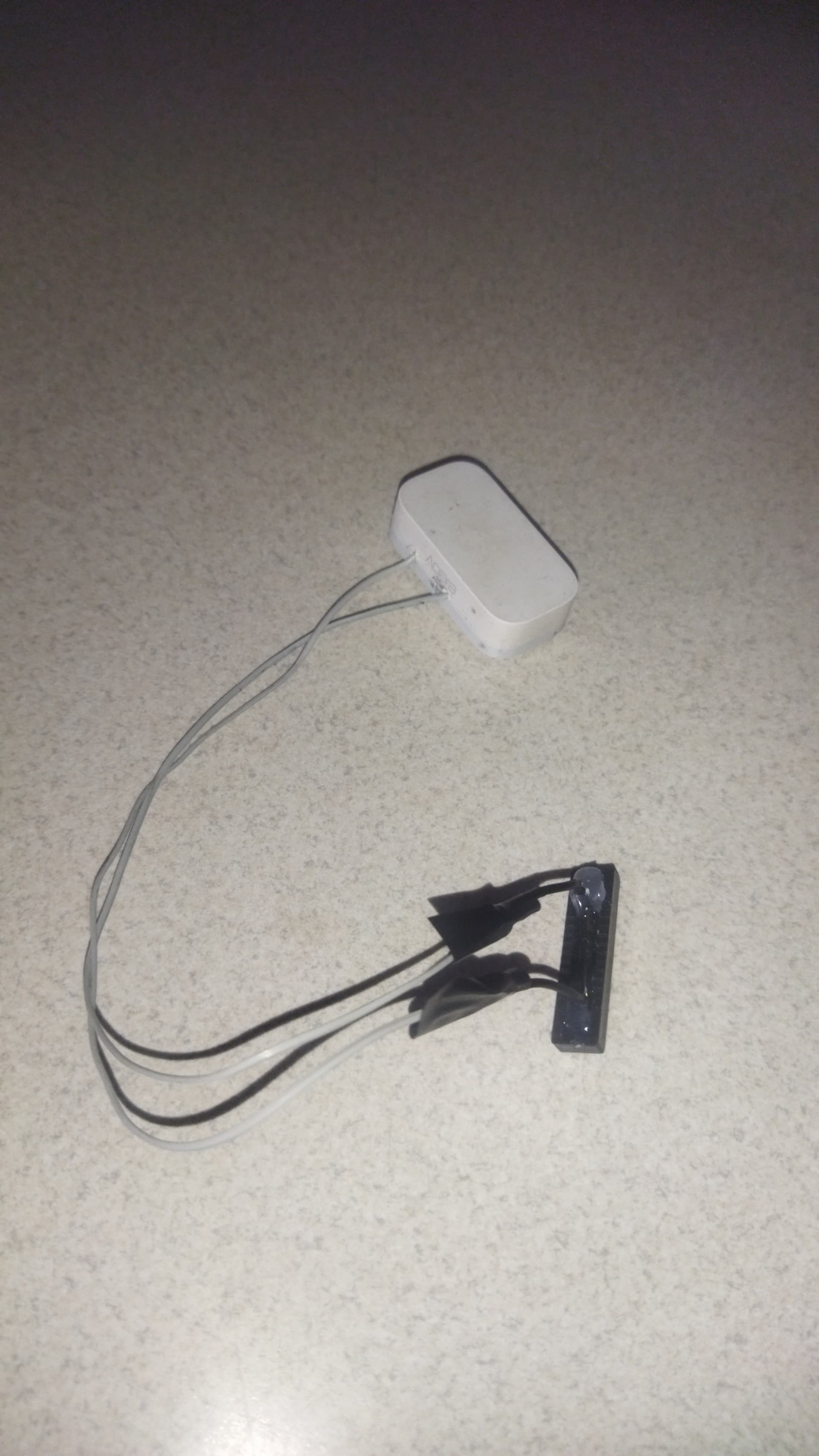

I upgraded the old Aqara sensor. I soldered two wires to the internal reed switch and brought them outside. I use this sensor to
(a) control the water level,
(b) control the operation of a stupid home thermostat to know the state of the heating system (On/Off),
(c) connect it to the reed switch located in the water flow sensor (protection against dry running of the pump),
(d) control various states of equipment where there is a relay with dry contacts.
Conclusion, I always ask myself why Aqara does not make a small connecting contact in sensors where a reed switch is used where you can connect an additional wire (analogous to a leak sensor, where there is a bolt). In the photo, a sensor with an external reed switch to control water leakage (c).
