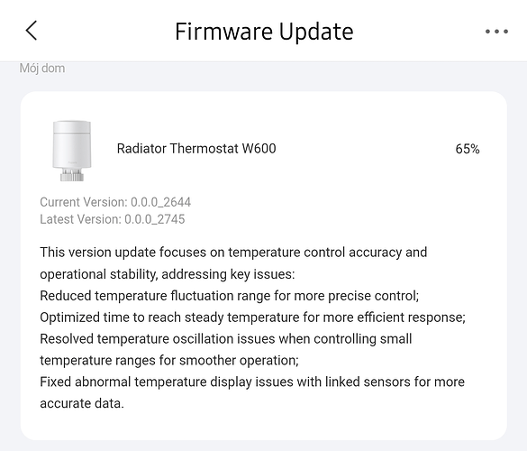

New Update is here. I’m curious.
Hope this version correct issues

Thank you, it became available today a few hours ago.
How are the experiences? Nothing has improved for me. The thermostats are still not working.

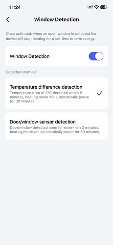

We have small text describing the logic for opening windows for testing, and there are two triggering methods you can take a look at.
I have noticed this, of course I was talking about detecting open windows without an external sensor. I think 3 degrees is an unrealistic setting. I suggest making the detection user-customizable: how many degrees in what ammount of time, also it makes sense to turn off the heating and switch to manual mode. No use turning back on if the window is still open.
