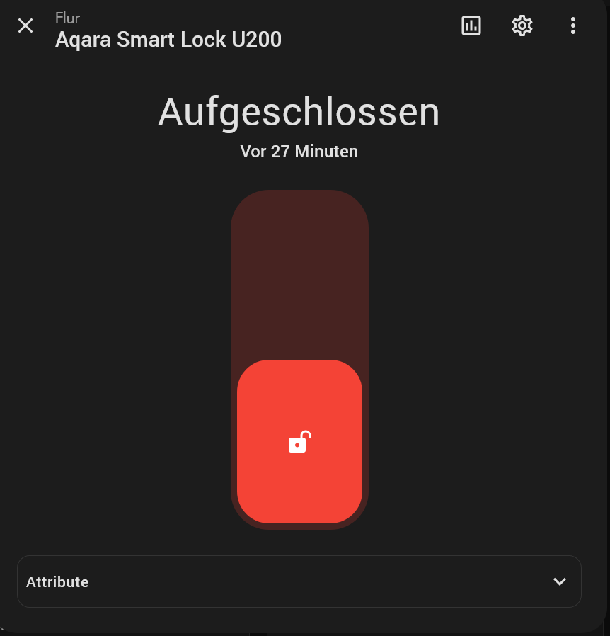

I have exactly the same problem. Home Assistant on Raspi 5 with ZBT-1 as OpenThread Border Router. The Extra-Button for the Latch is missing.

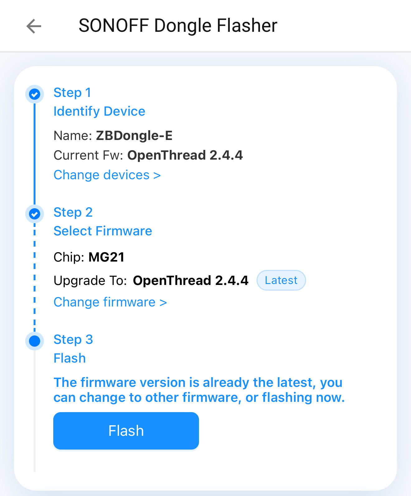

BTW I am using the Sonoff ZBDongle-E with the Thread-only firmware.

The “Open Door”-button is still there in Home Assistant.
So, Aqara, please fix this bug asap. Home Assistant is the most popular smart home ecosystem, at least in Europe. Matter integration is useless without an extra button for the latch.

I installed beta firmware 084 (beta firmware must be activated under “Profile”). Now I see a new button for the latch in Home Assistant. It was not necessary to remove and pair the lock again. As soon as the new beta firmware was installed, the extra button was there.
Thanks.
with that beta version installed it works as i wanted to have it.
Lock, unlock and a button for open
