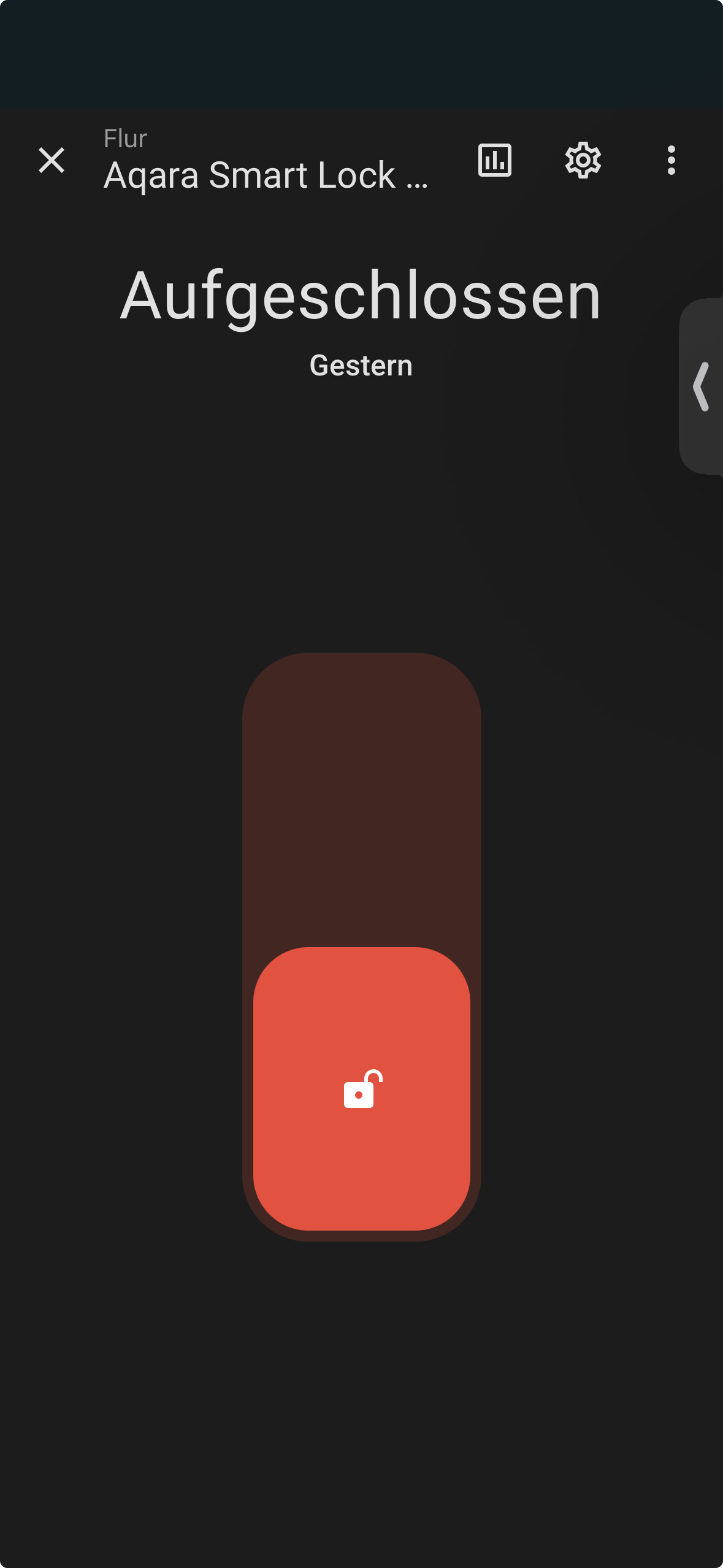

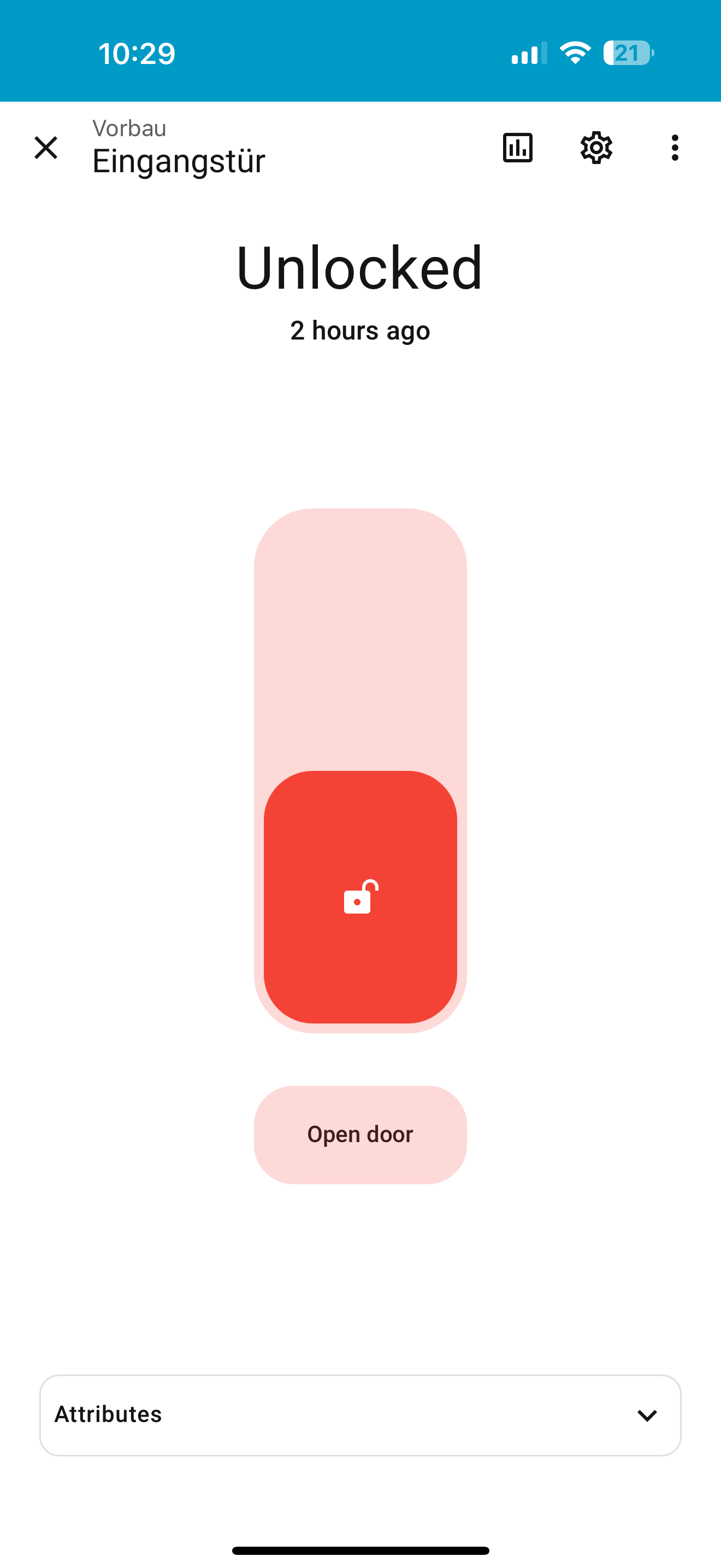

That looks great, however i can‘t see the open Door button when the door is unlocked in HA. I added the Lock (U200) via Matter over Thread.
I added the Lock first to Apple Home, then to HA

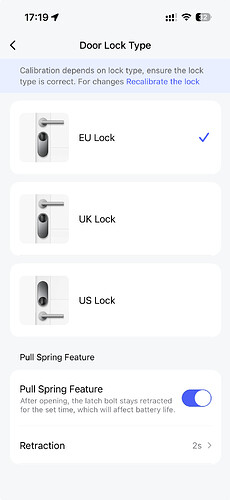

Hi, to enable the pull-spring function in HA , please use the Aqara app and enable the pull spring function. It will appear once activated.
I use the lock in Home Assistant via Matter over Thread. It works really well, and I’ve got the new latch functionality.

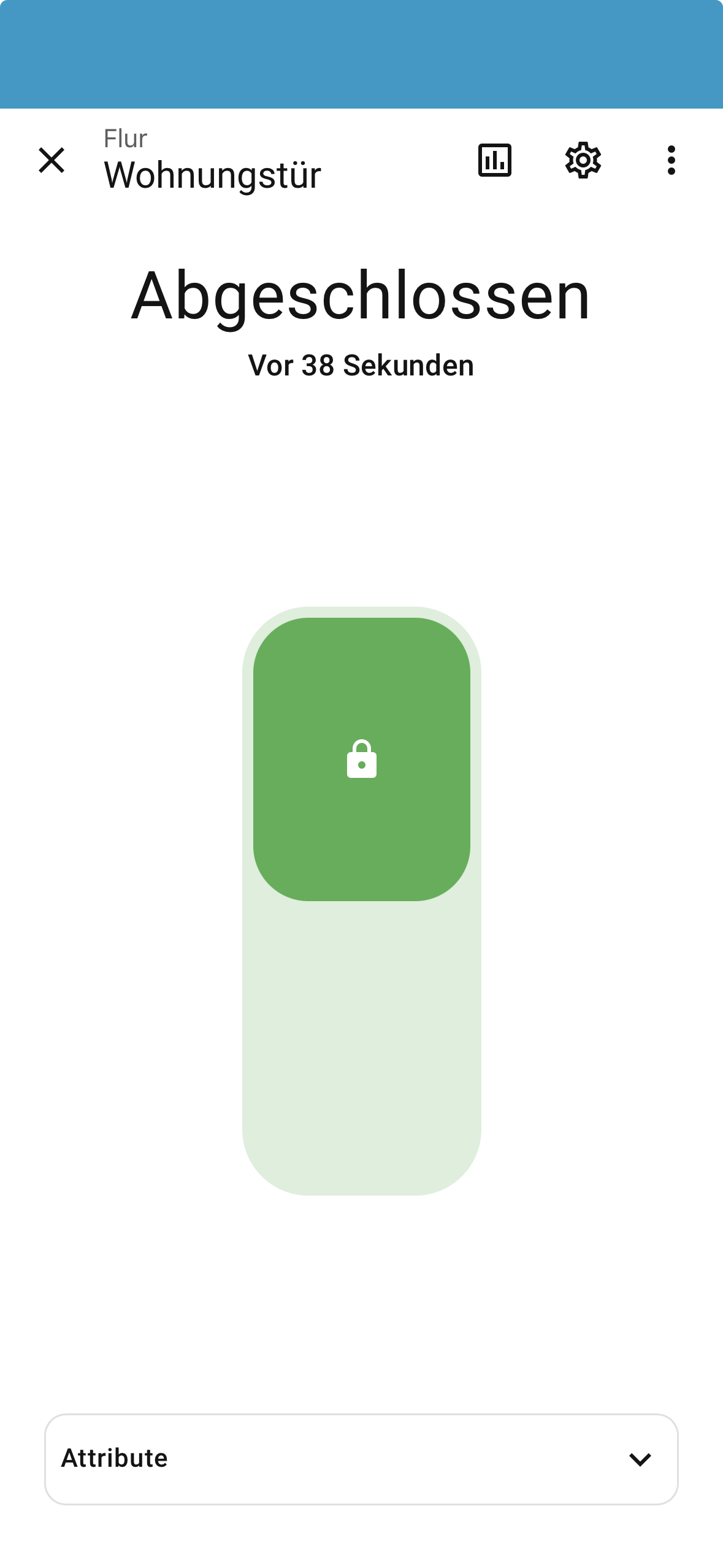

I am unable to get this to work. The Pull Spring feature is enabled, bit no „Open Door“ button appears.
@KinseyCreateGoods Do you have feedback for me?
Hi mate,
If you got the pull spring feature enabled then the door will open if it is unlocked and you trigger an unlock (by Bluetooth, HomeKit, Matter, Keypad with fingerprint, code or NFC).
There’s no extra button.
But according to the posted Video posted by @KinseyCreateGoods there should be an extra button labeled “Open Door” when “Pull Spring” is enabled.

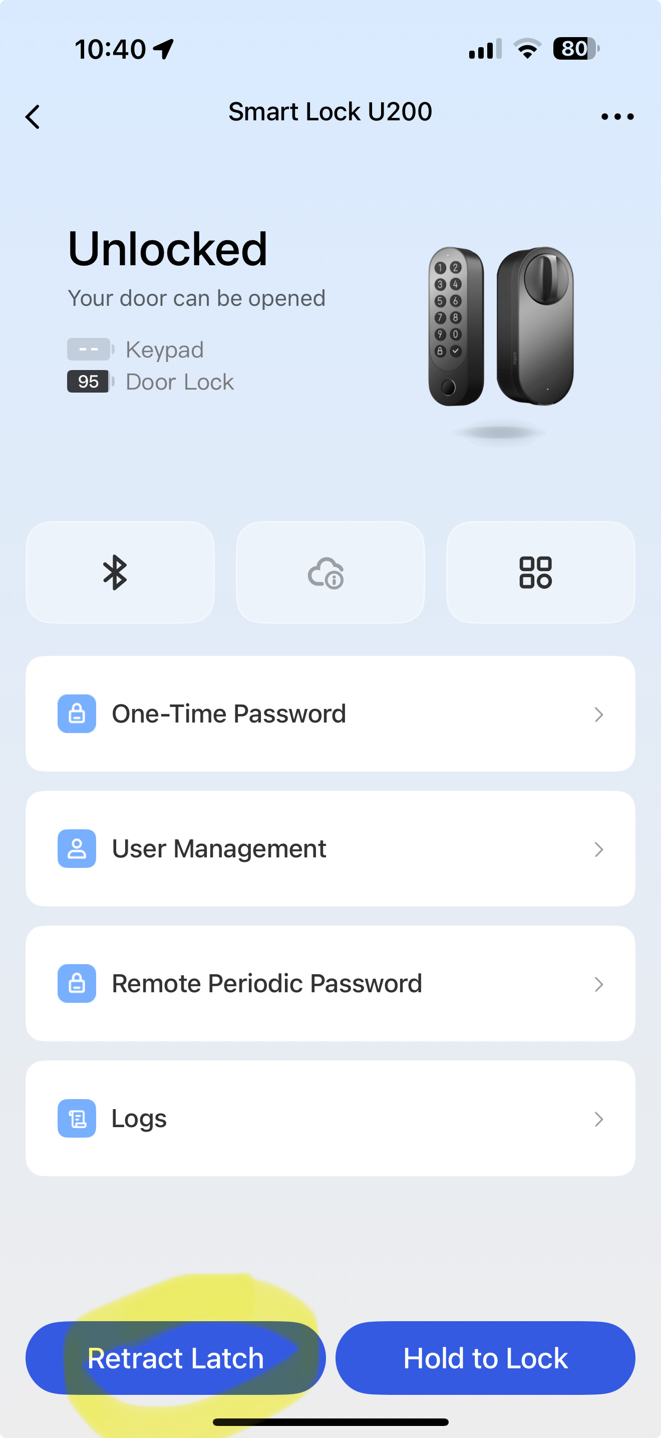

I just double checked. There actually is a button in the Aqara app. But it’s labeled “Retract Latch”. But it does what you are looking for.

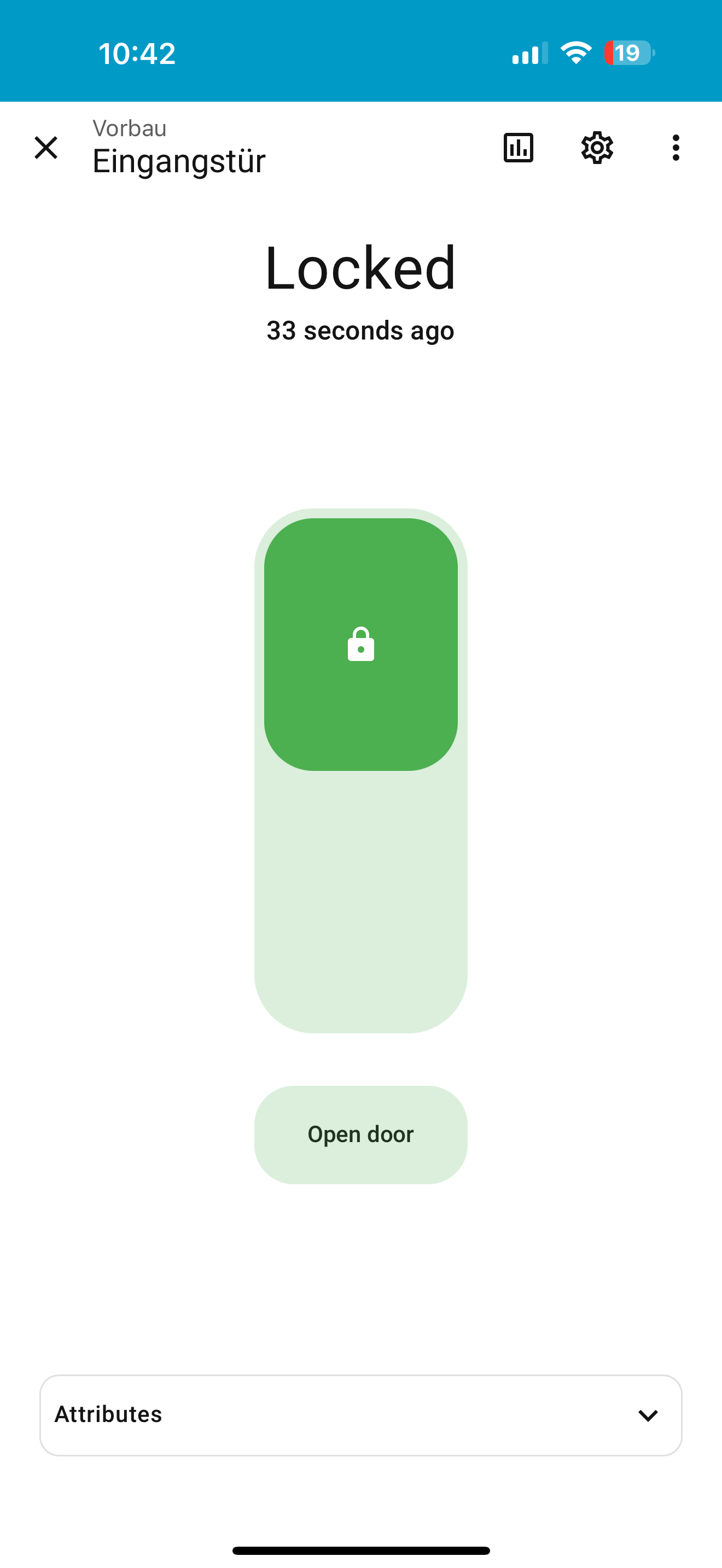

Yes, I do see this button in the Aqara App, but its not visible in the Home Assistant app.

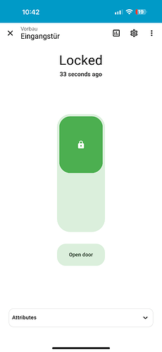

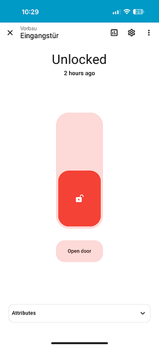

I just checked again in Home Assistant. And on my installation there is a button to open the door.
Just can’t recall if it was there all the time or it just appeared recently.
BTW your screenshot was taken when the U200 was locked.
Just verified if the button is still there when I lock the U200.
I am lost here, is there any feedback/help from Aquara?
