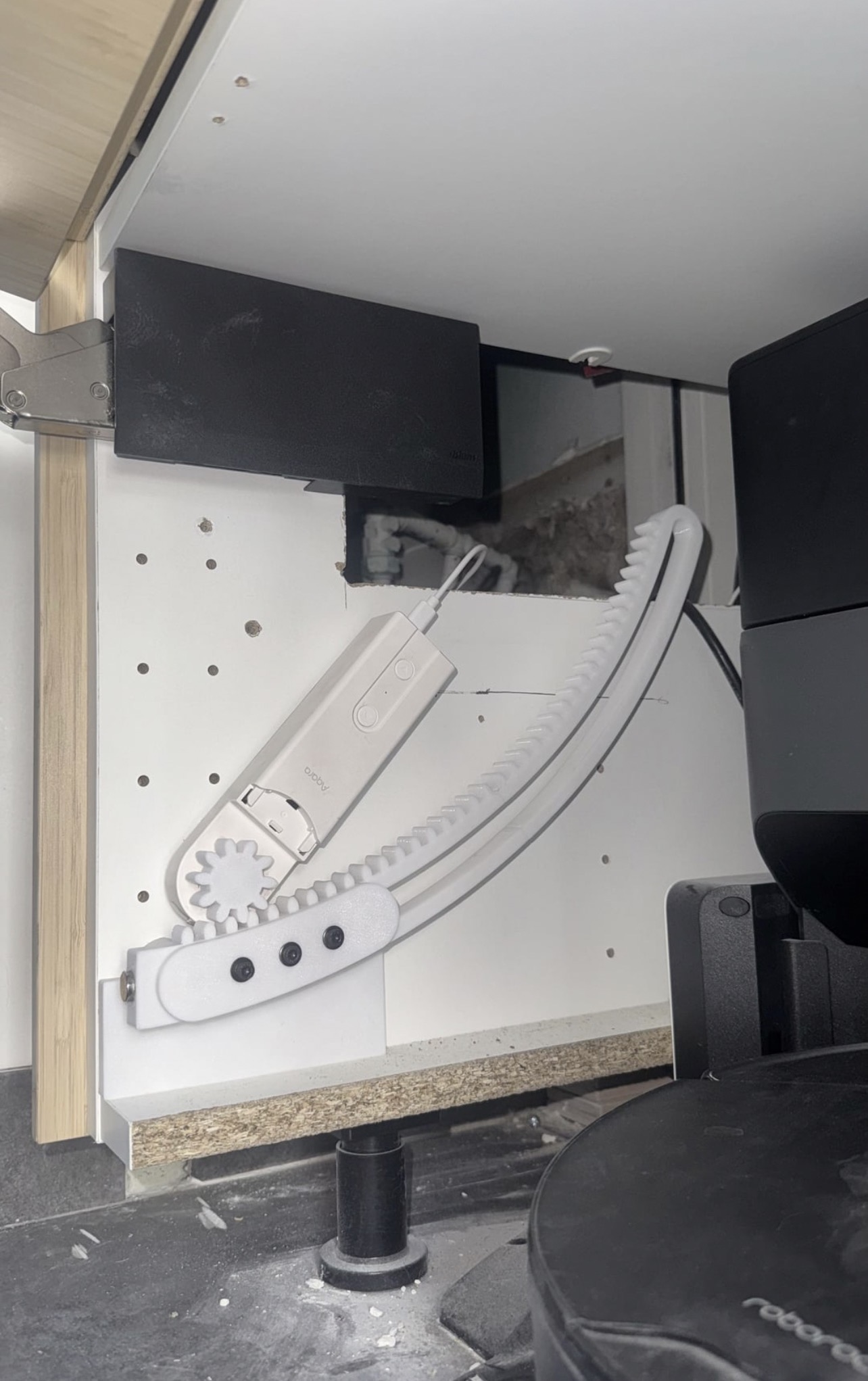

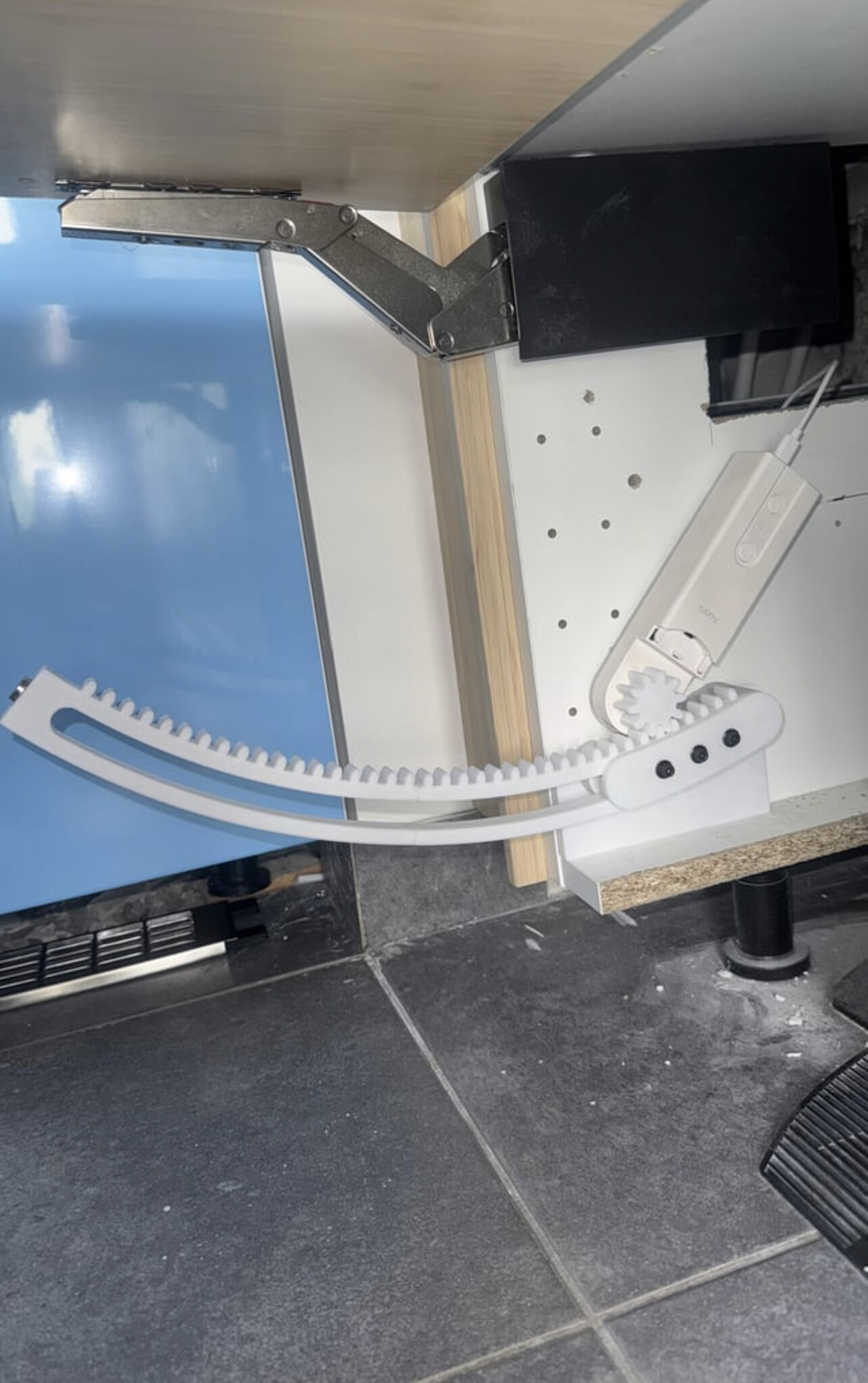

3D printed automatic cabinet door for a hidden Roborock station
I wanted to share my latest 3D print for anyone interested in integrating Home Assistant with their smart home hardware.
I keep my Roborock S7 MaxV station hidden under an IKEA Metod kitchen cabinet. Unfortunately, the vacuum is just a bit too tall to fit under the door, so I had to come up with a workaround.
I designed the entire mechanism in Rhino, calculating the exact opening angle so I could also add a kickboard and completely hide the base. For the motor, I went with an Aqara E1, normally meant for smart curtains, because I didn’t want to bother with more complex custom electronics. It still provides more than enough torque to easily swing the door open.
The door opens automatically based on the robot’s status, and the Aqara is plugged into a smart outlet that turns on depending on the battery level, so it’s only powered when needed.
I’ll be uploading the STL to Printables soon for anyone who wants to give it a try.

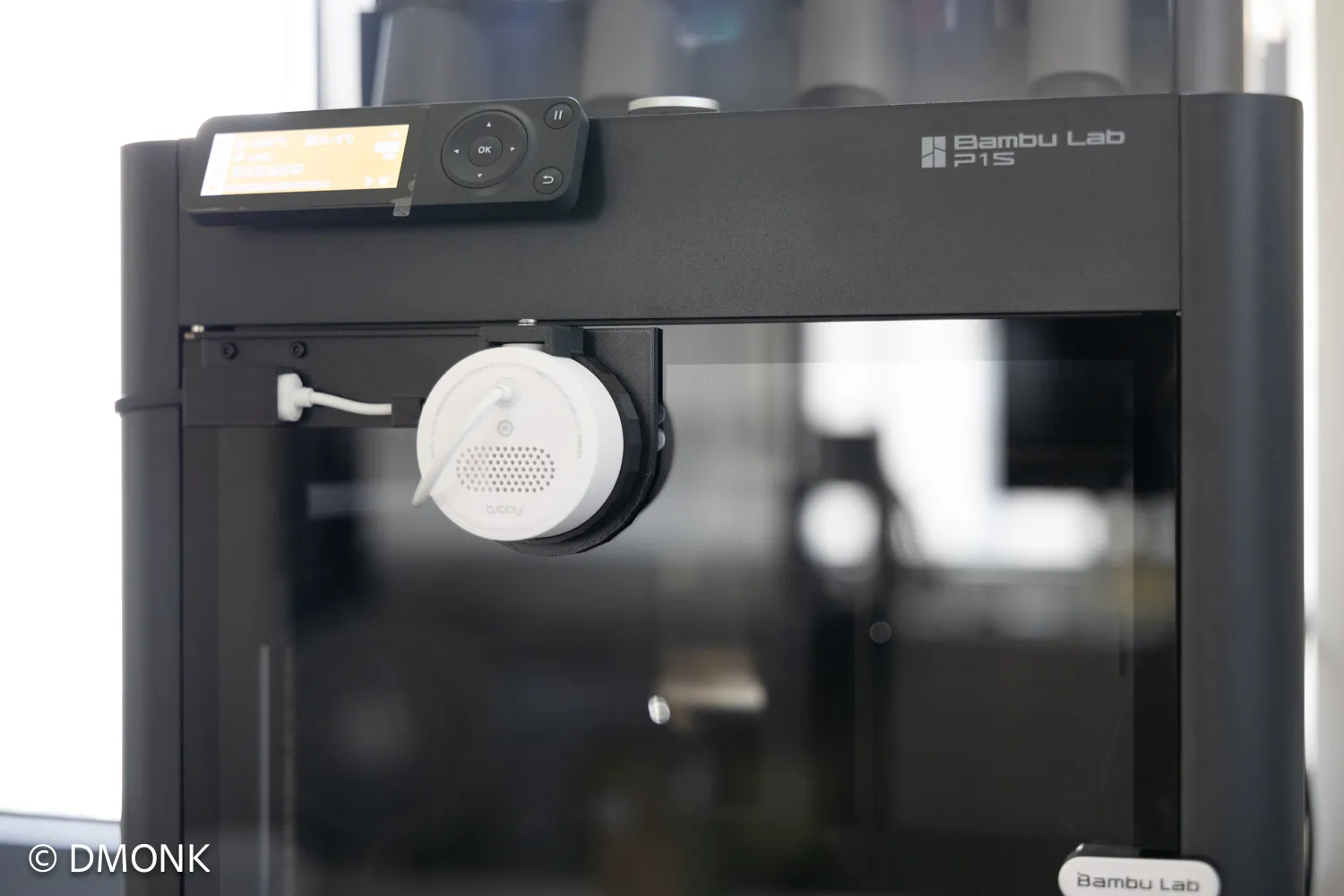

Bambu P1S External Camera Mount V2
Use Aqara G100
https://makerworld.com/en/models/1506159-p1s-external-camera-mount-v2
Hi , thanks for the Link! This a cool idea - I´m owning a X1 Carbon btw
It’s a very cool design for Ikea Skadis for M3 from Jakub Kasparek m3 holder
