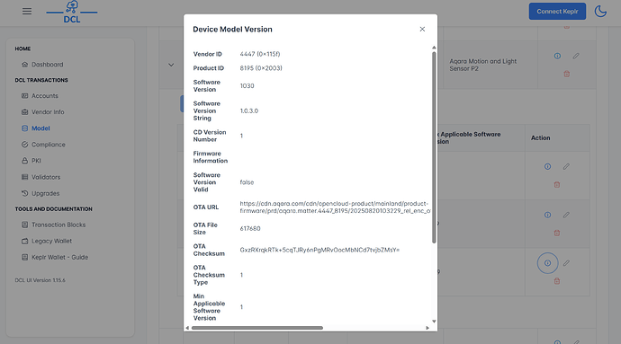

In answer to your specific question:
Yes, Aqara provides a link to the firmware update in the Distributed Compliance Ledger (DCL) for certain Matter devices. In this case, you can update the device via Home Assistant.
I have upgraded my Aqara P2 Motion Sensor (Matter over Thread) to version 1.0.3 in Home Assistant. However, this update has now been marked as invalid and Home Assistant no longer downloads it.
A link to the firmware for the W100 was also provided, for example. While there is an entry in the DCL for the P100 sensor, no firmware information was included. It therefore depends on whether Aqara has stored the firmware information in the DCL.
Why was it marked as invalid. Did they generally pull the firmware release back?
I’m just taking a guess here, but when you read about other people having faulty sensors after the update, it seems likely that this is probably the cause.
Here’s an example from Robert Coletti:
So, versions 1.0.2.0 and 1.0.3.0 of the P2 motion sensor and 1.0.1.1 and 1.0.2.0 for the P2 door & window sensor have been revoked, and the following statement has been issued to users by support:
