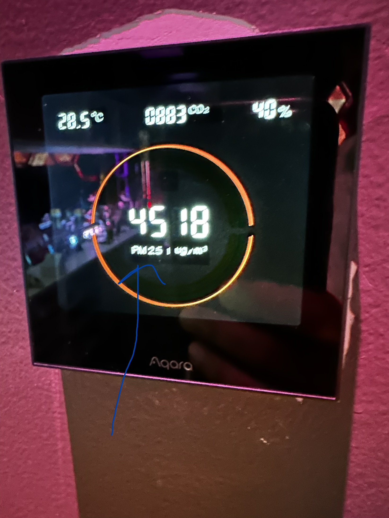

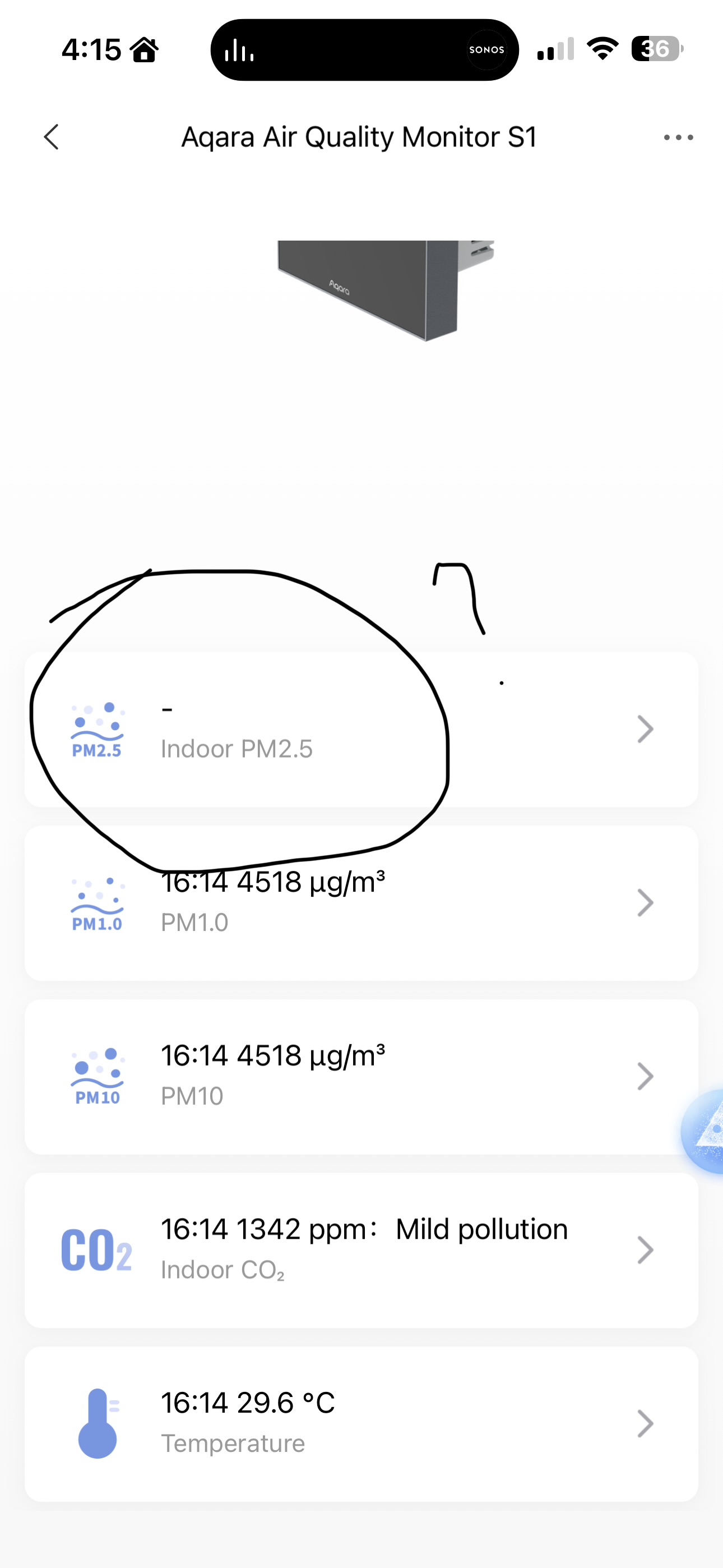

I installed the Aqara S1 Air Quality Monitor and noticed that the PM2.5 reading is not displayed in the Aqara app, even though the value is clearly shown on the device’s screen under the PM2.5 parameter.
Also, it is not clear how to navigate or scroll between the PM1, PM2.5, and PM10 readings on the device. The product information in the app indicates that the monitor supports PM1, PM2.5, and PM10, but I cannot find a clear way to access all three measurements.
Could someone please clarify how these particulate-matter readings are supposed to be accessed and whether PM1/PM2.5/PM10 are currently supported and exposed in the Aqara app?
PS: The PM readings also seem to be significantly inaccurate. I’m not sure whether this is a calibration issue, a limitation of the sensor, or if the device itself is faulty. I have IKEA and Levoit air quality monitors in the same environment, and both consistently report particulate levels within the normal range, while the Aqara S1 is showing considerably higher readings.

As far as I know, you cannot change the PM2.5 to PM10 on the device’s screen. The button on the device can only change the view from CO2 to PM2.5, other readings should be available in the app.
Well the device is an wall mounted device witch supposedly should read well I couldn’t set min on the wall but is on the desk.but his issue is with the PM2.5 that have high readings only the PM10 not.i already spoke with him by message and he already contacted Aqara support but I think that the PM2.5 sensor is broken in his case as mine read both PM particles and his only read one.my be this device could have an issue.

I also added it to HomeKit, and the PM2.5 reading there shows 000, while the Aqara app shows a very high reading.

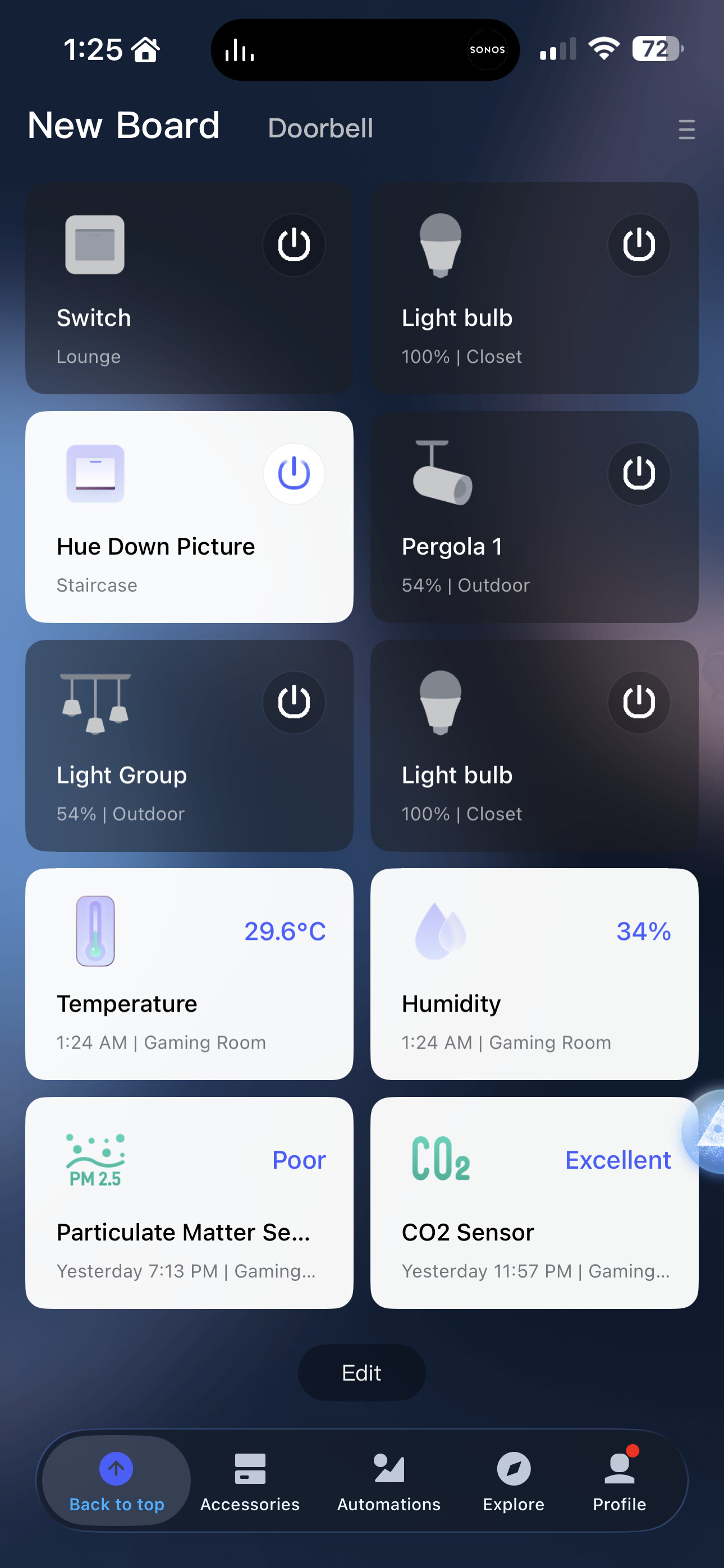

I took some screenshots from the Aqara app. You can see that the last PM2.5 reading was at 7:31 PM, while the CO2 reading is updating normally and matches the current time, which is 11:57 PM.
I’m not sure what’s happening or whether the PM2.5 sensor is actually working properly.
Hmm, the missing PM1.0 and problem with PM2.5 sync really looks like the app or hub problem
Well then how do you explain that high readings on PM2.5?that has nothing to do with the hub also this sensor is not an TVOC to measure volatile compounds.also he mention me that have others 2 sensors one from ikea and measure well.
I was talking about the fact the readings don’t update in the app. And yes, they’re high in the app. Both may mean that the hub doesn’t update those values properly (or doesn’t sync correctly those values with the cloud). Or the hub gets the raw data from the sensor, but then (due to a bug), formats the value wrong, which makes the number high.

I checked the data logging for PM10 and PM1, and both readings have remained exactly the same over the past 24 hours. However, the CO₂ and humidity readings are fluctuating normally throughout the day.
I also performed a factory reset and reinstalled the device, but the issue remained exactly the same. The PM readings immediately returned to the same fixed values.
