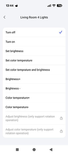

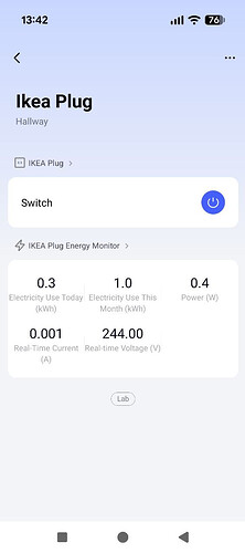

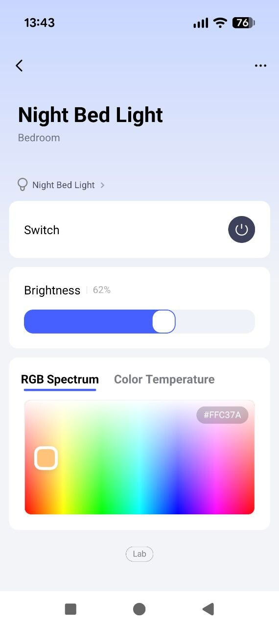

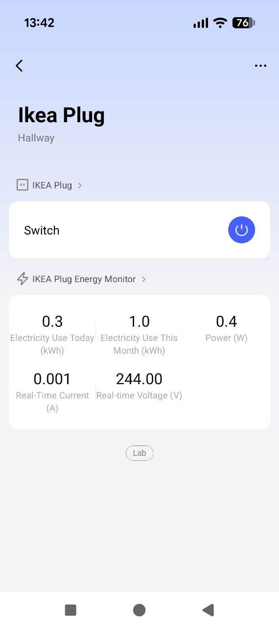

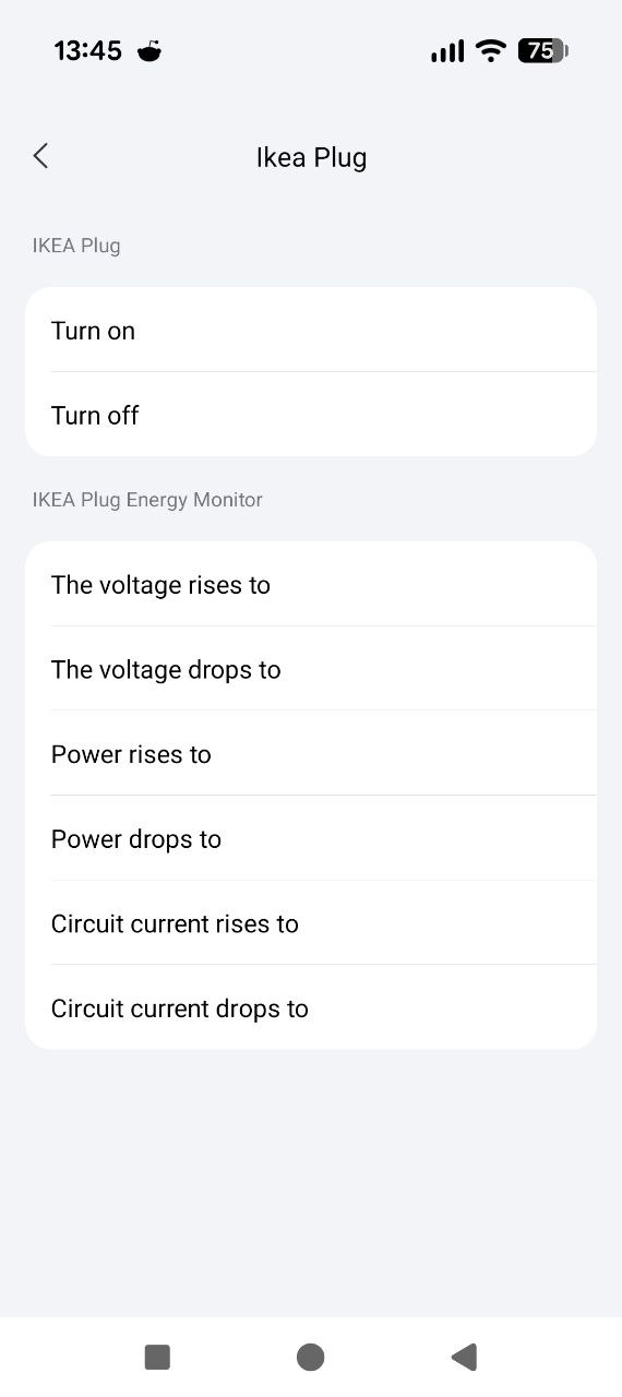

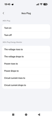

I have integrated several IKEA devices to the Aqara M3 hub without issue. I use the plugs in automations with an FP300’s to turn on lights.
