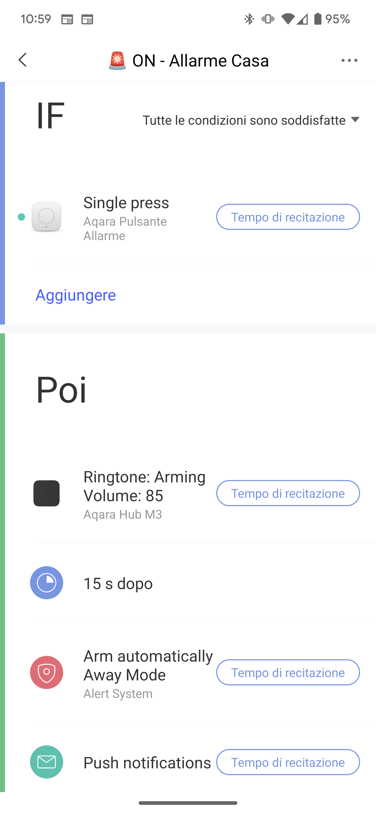

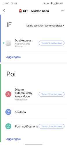

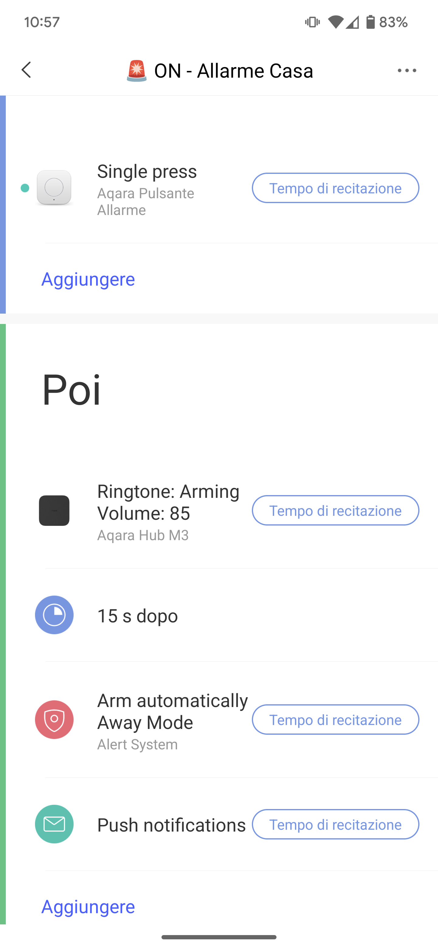

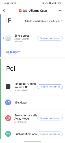

Hi, thanks for your help. I tried what you said, but when I open the door even after disarming it, M3 hub announces the disarming delay with its sound. This is not working for me. I checked the settings in the alarm security panel. In Away mode the door sensor arrived while in Home mode I added mini switch with two taps as other trigger events, but nothing changes. Why? Thanks for any help.
That are my automation

In practice this happens when by pressing the mini switch button once the away mode is activated, when I open the door connected to the aqara door sensor again and press the mini switch twice to deactivate the alarm this automation does not work as it should. In fact, by opening the door again, the alarm starts with the countdown for the entry delay. I can’t figure out how to fix the problem.

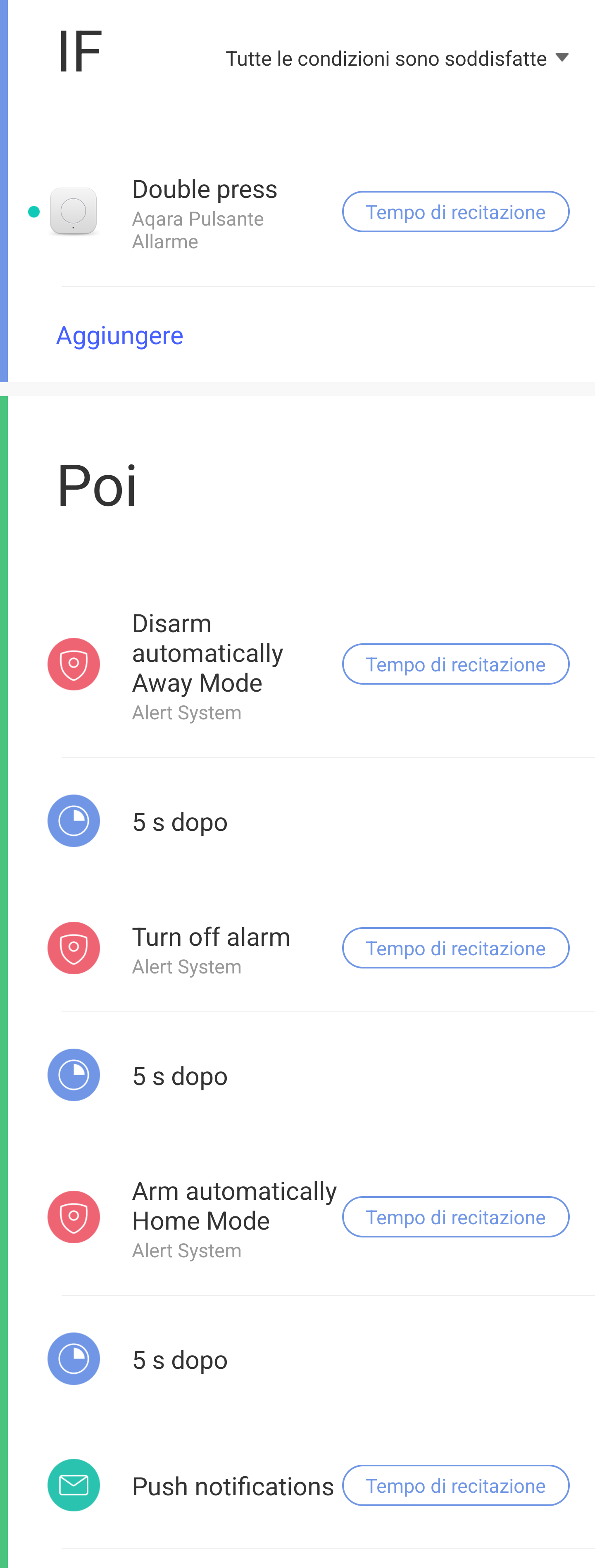

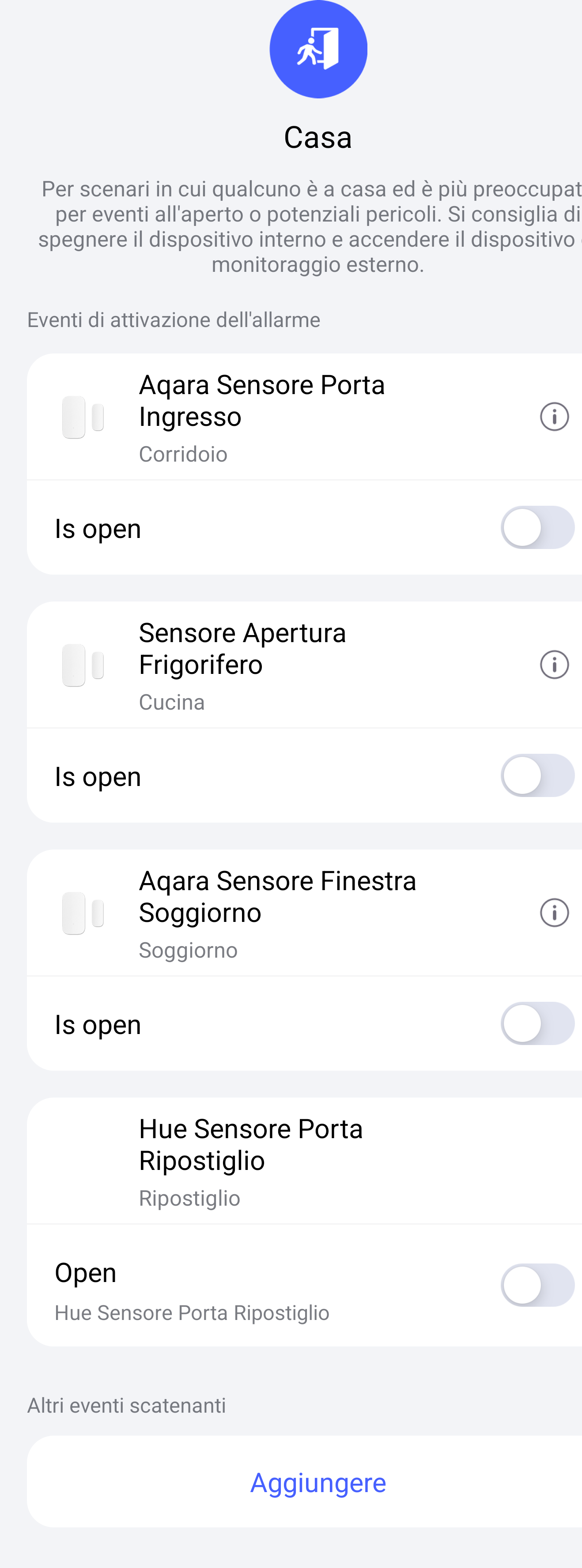

From the screenshot of your automation, after double press the wireless switch, the system will disarm the away mode then arm the home mode, so after double press, your security system is still in arming state. If your door and window sensors are also added to the home mode, then it means that if you open the door will also trigger the alarm in the home mode. So if you want to double-press to disarm the system, then you need to modify your automation to remove arming home mode, if you want the door/window sensors not to trigger alarm in home mode, then you need to remove door/window sensors in home mode in the security configuration.
Thanks for your reply. I changed settings in the security and automation center, but it still doesn’t work. After deactivating the alarm by double clicking, if I later open the door, the alarm starts ringing again.
