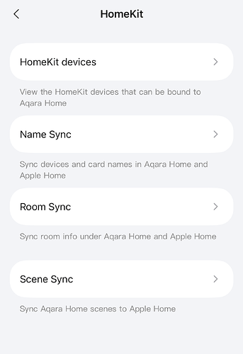

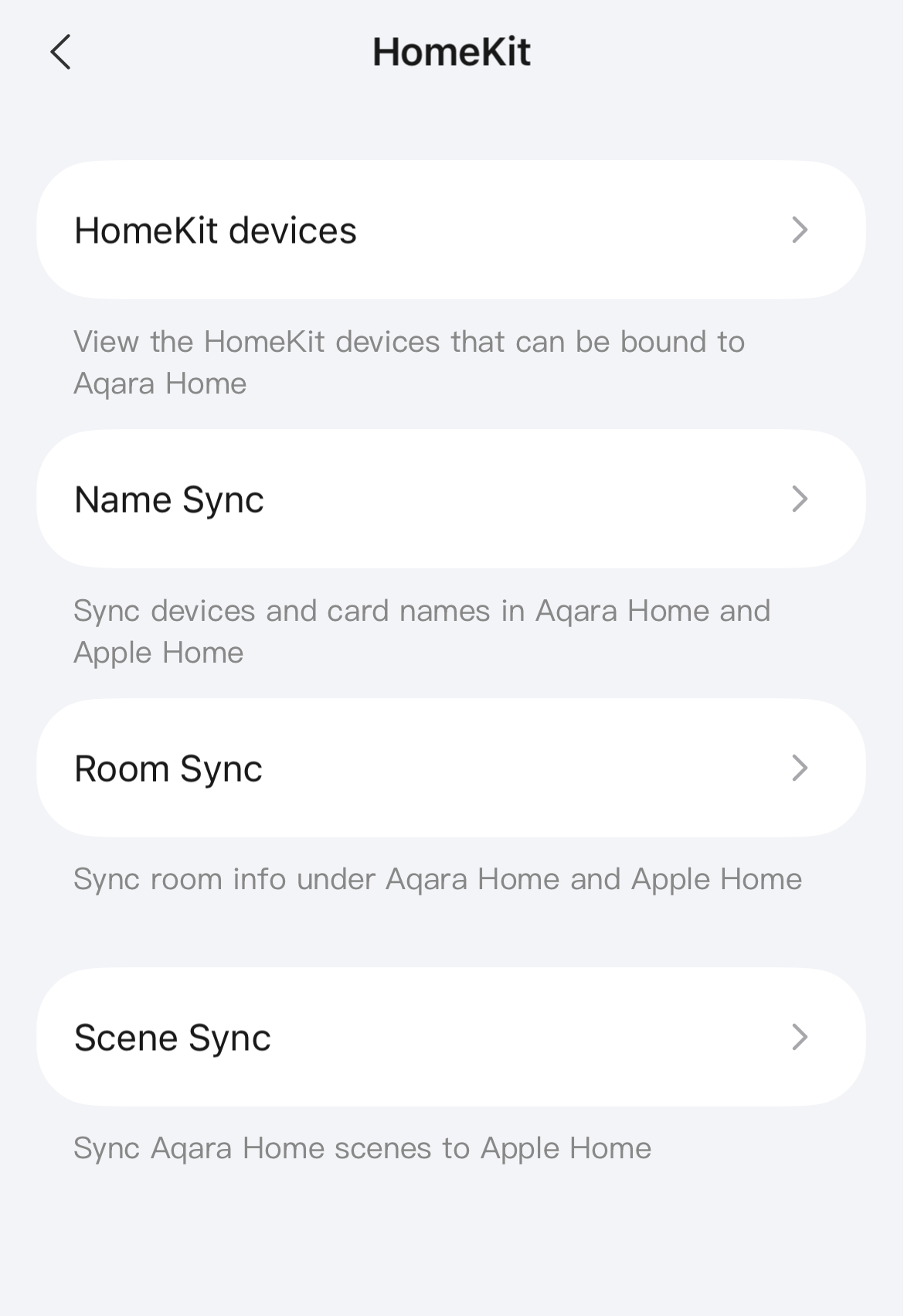

It is possible to sync Aqara with Apple Home, but not the other way around.
Aqara Home app → Profile → Connect to Ecosystems → Apple Home
The only workaround to syncing the devices other way around is to use Matter devices/ecosystems. If you have a Matter enabled hub like the M3, you can add all your Matter devices to Aqara (you will find the Matter pairing code in Apple Home > hold device icon > settings > scroll to “pairing mode” or something like this)
