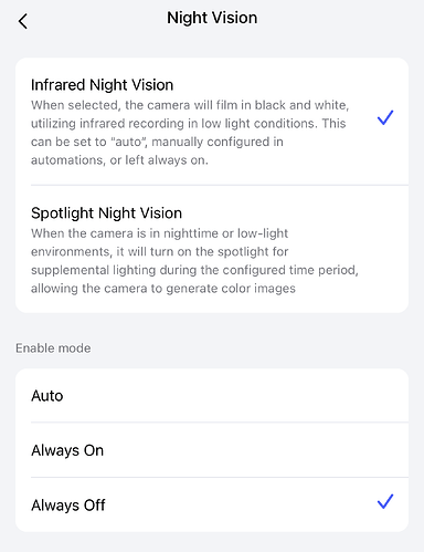

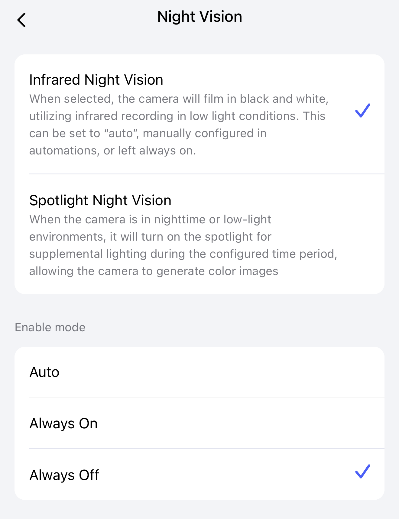

I have a g100 also, and it’s in a basement utility closet with low light and had issues detecting motion as well.
Two things helped me:
1- update firmware to latest
2- enabling night vision with spotlight can help if it’s extreme dark, under video settings
