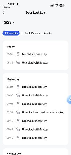

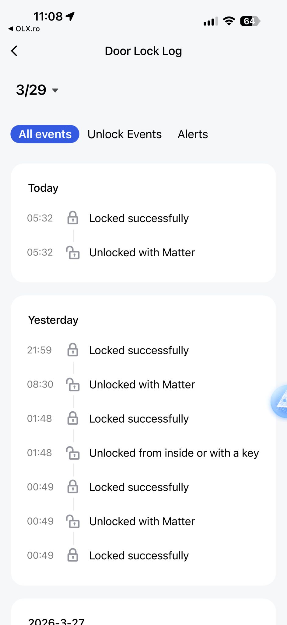

Last night I encountered a very strange situation. My Smart Lock U200 just unlocked itself in the middle of the night. At that time, I thought maybe i’m dreaming, but after checking the log in the morning, I saw the door just got unlocked and locked at 05:32 in the morning by itself. I consider this is a very serious security breach, and I am curious if anyone else encountered this problem.

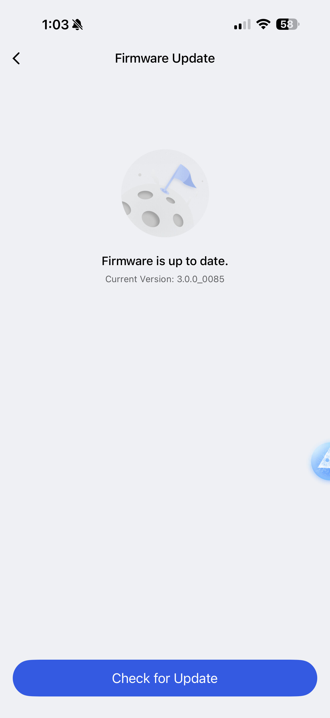

Hi @Andrei.C this is definitely a serious thing! I also mean that I could remember such an issue at the beginning through the beta test - but this issue was fixed through a firmware update. Can you tell me which firmware are you using?
It’s on the last firmware as far as I see.
Yes! That’s also latest for me - please contact @KinseyCreateGoods or the Aqara support

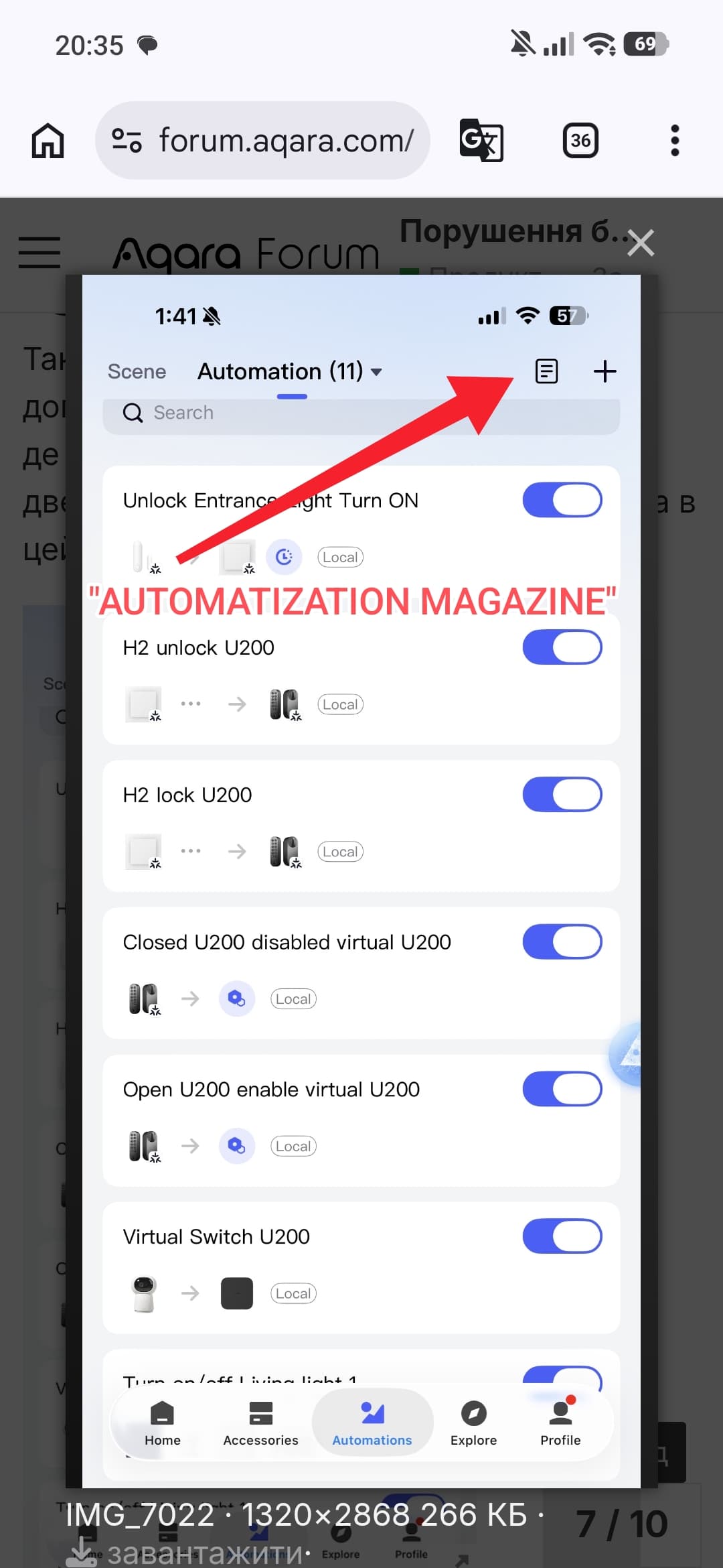

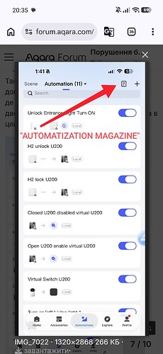

Check your automation logs. See if the automation was triggered, its at the top that looks like an A4 letter next to the plus symbol

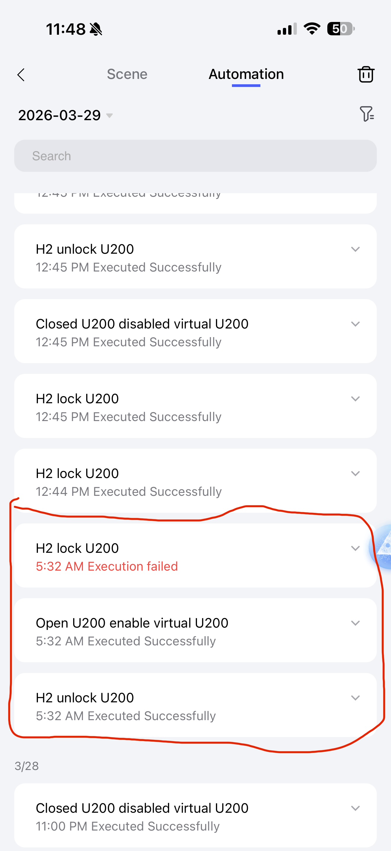

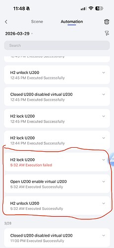

Here’s the log
If you click here, you will see who initiated the automation.

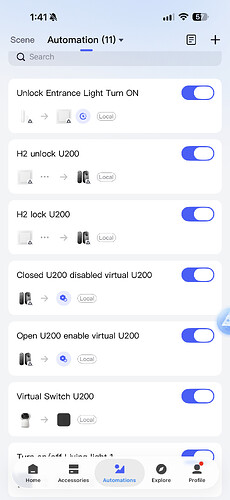

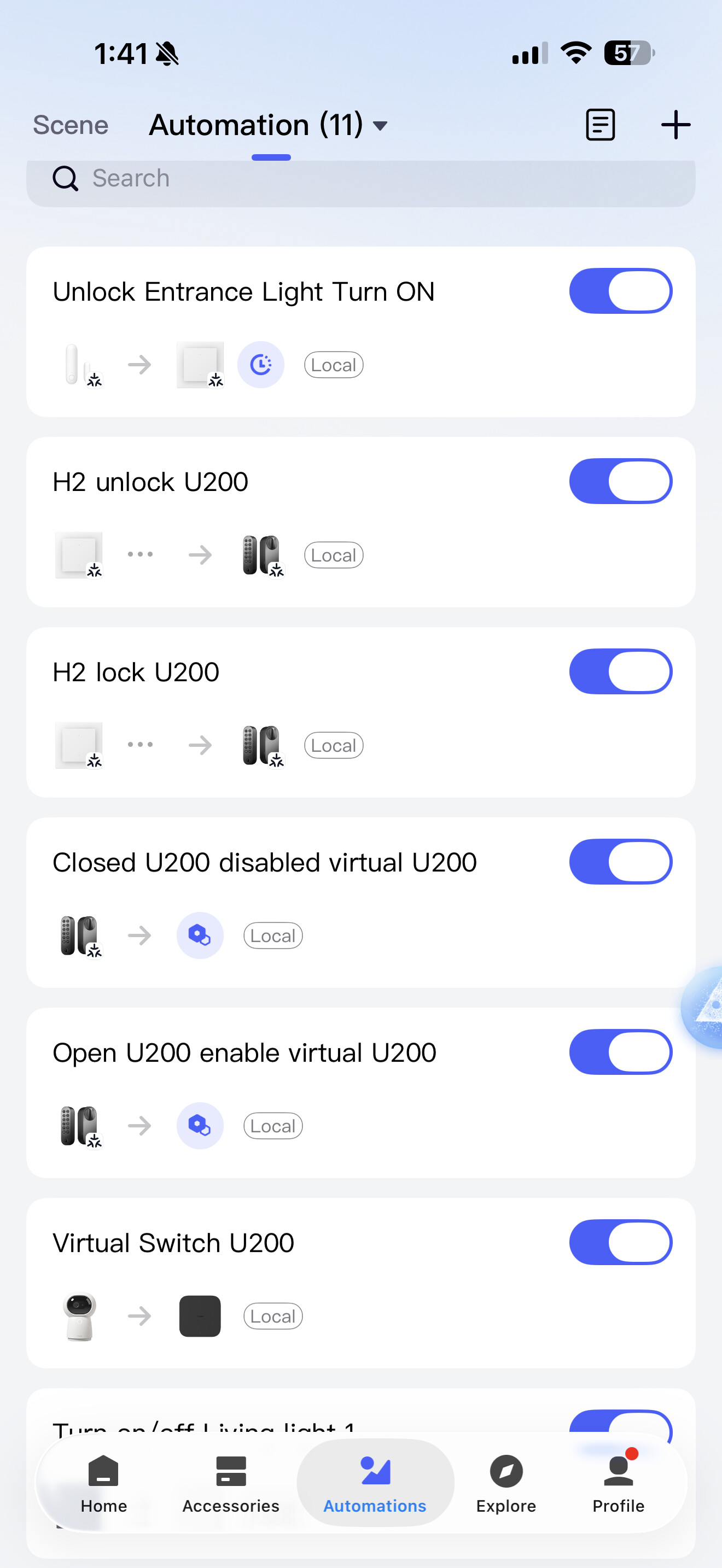

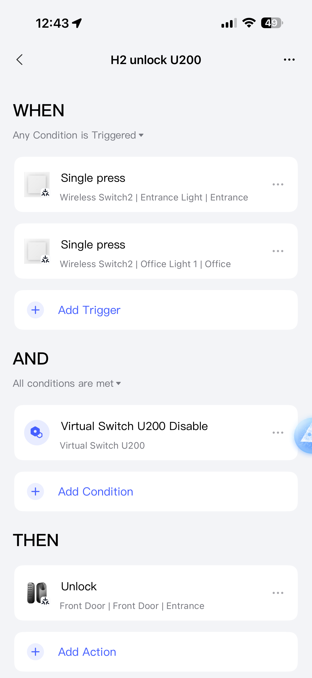

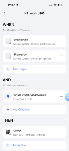

Can you take a screenshot of the „H2 unlock U200” automation? It looks like „Office Light 1“ triggered it.

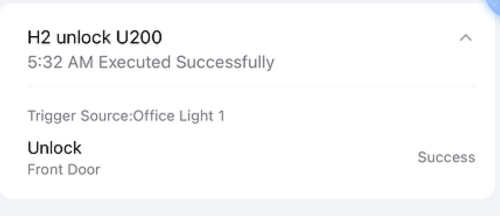

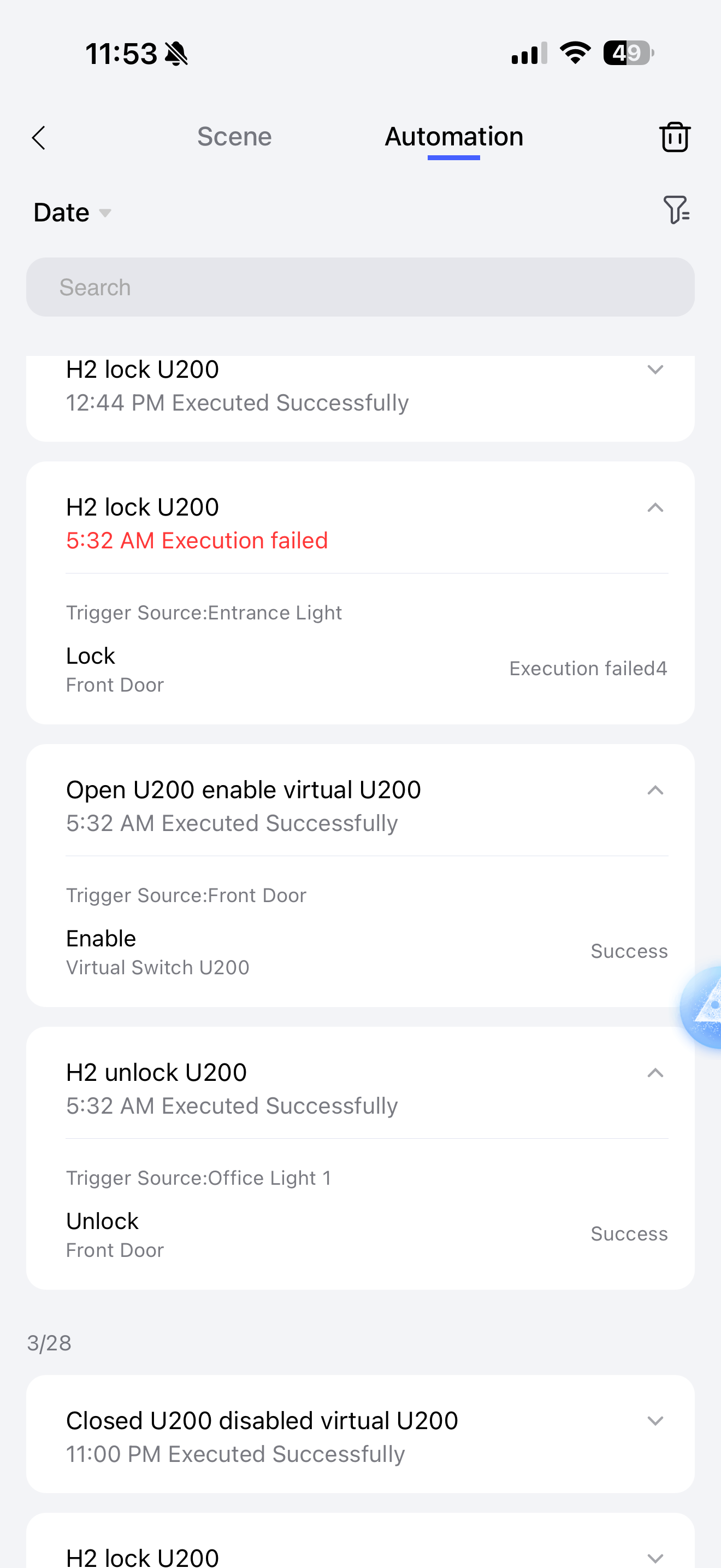

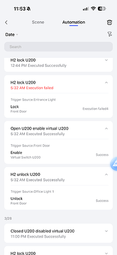

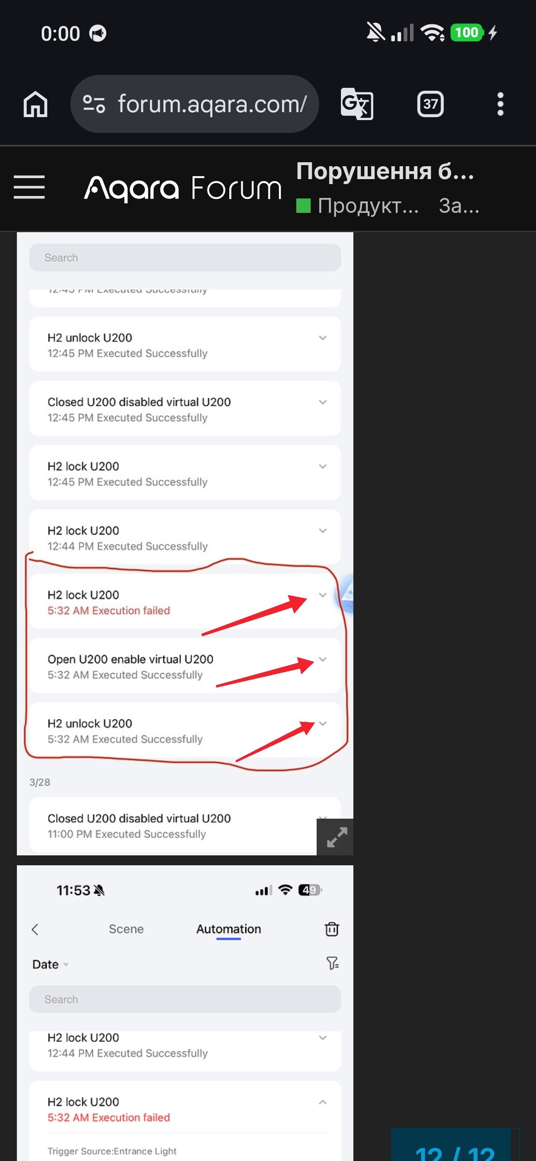

I have attached a 2’nd photo with the log expanded. It looks like the Office switch unlocked the door, still strange for me since everyone in the house was sleeping that time.
You click on the little triangle, I showed it with an arrow. You will see the sequence of automation operation, which switch has been triggered.
By the way, what automation immediately closed the lock, what trigger worked?
It looks like the office switch triggered the unlock, and immediately the entrance switch triggered the lock
This is indeed a weird behavior and as said a very serious issue. Good thing is, it‘s not related to the U200 itself as it seems. Now we have to find out how/why the automation got triggered. Wanted to ask if the automations are running local or via cloud but one of the screenshots you shared shows „local“.
