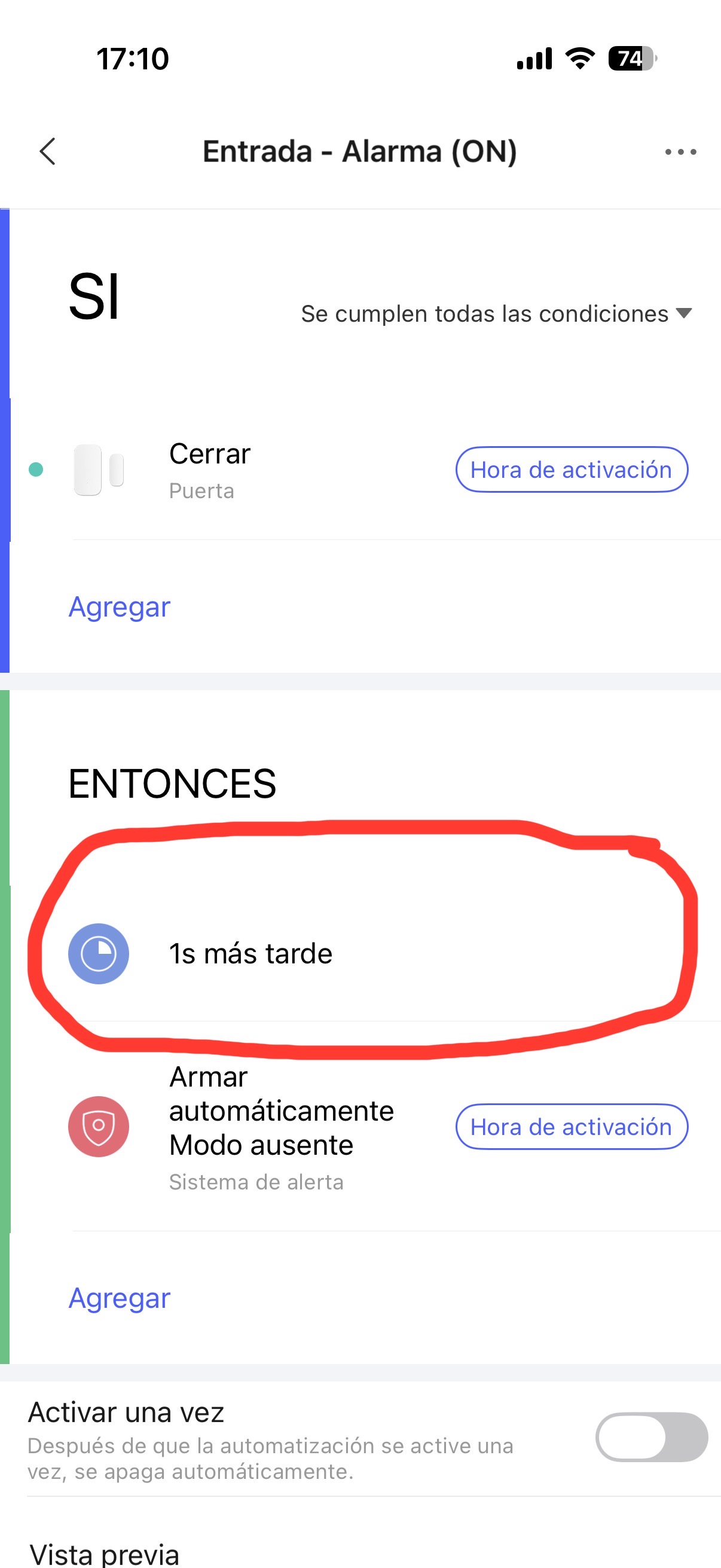

I hope this post could be helpful for anyone… I programmed that when a door was closed, the alarm system should be activated. This action normally took 5-6 seconds to be performed. For this reason I thought that the problem was caused by the door sensor. However, I tried to trigger another action (switch on an aqara lightbulb) when closing the door, and it worked perfectly without delays. I contacted aqara team and they suggested me to include 1s delay before “alarm system activation”. This workaround solved my problem, but it is clear that something has changed, because this behaviour did not happen some months ago…
