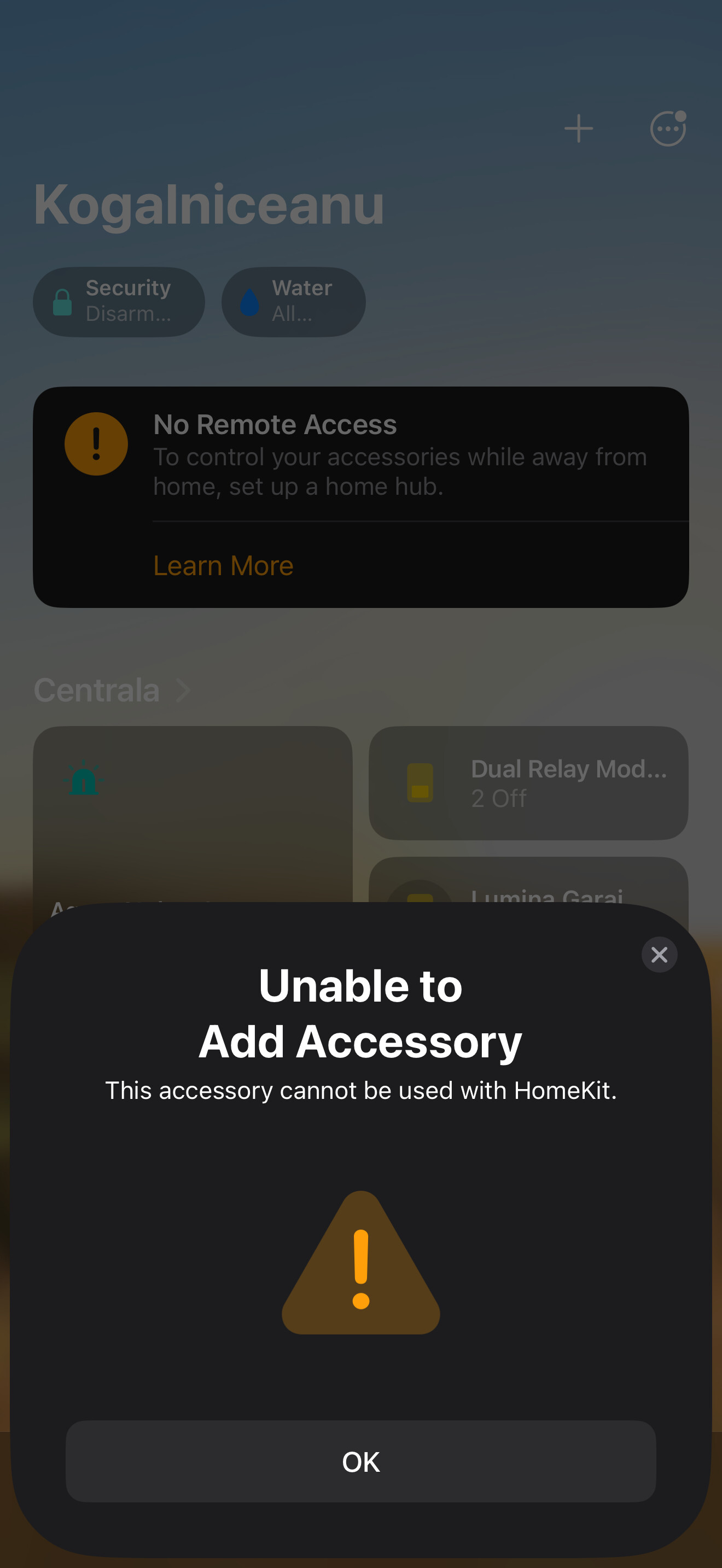

Hello, I bought an E1 camera and can’t connect it to HomeKit. It connects fine to the Aqara app but whatever I try it will not connect to homekit.
One of the messages I get is “This accessory cannot be used with Homekit” which shouldn’t be the case.
Did this happen to anyone, any advice?

That’s the point I tried all combinations i could think of including what you suggested. Also went to “connect to ecosystems” and the E1 does not show under homekit, other cameras/hubs do.
So this would be inline with the message that the accessory cannot be used with homekit. But why…?

Tried all that and same result.
I tried with 3 different Iphones, 2 running IOS 18.6 and an older one with IOS 16.7.11, all the same. I’m beginning to think FW 4.3.6_0012 is somehow buggy or the camera itself is broken.

Yes, both with the camera added to Aqara app and fresh after resetting, both with the same result. Also on the same 2.4G WIFI.
I tried your suggestion, still the same result. Also what I noticed I have HA setup also, and from there it’s the same behavior, the camera is discovered but can’t connect.
So seems to be an issue with the Homekit controller part.

Yes, this is what I tried, but didn’t have what to remove from the Apple Home app because I couldn’t add it in the first place.

Also with the E1 I tried adding it to a fresh/empty home/account and still same output.
Something is wrong with the camera, next thing I would try is a different E1 camera. Start fresh and keep it simple
This is also my hunch, but don’t have any other E1 at the moment.
