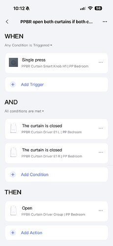

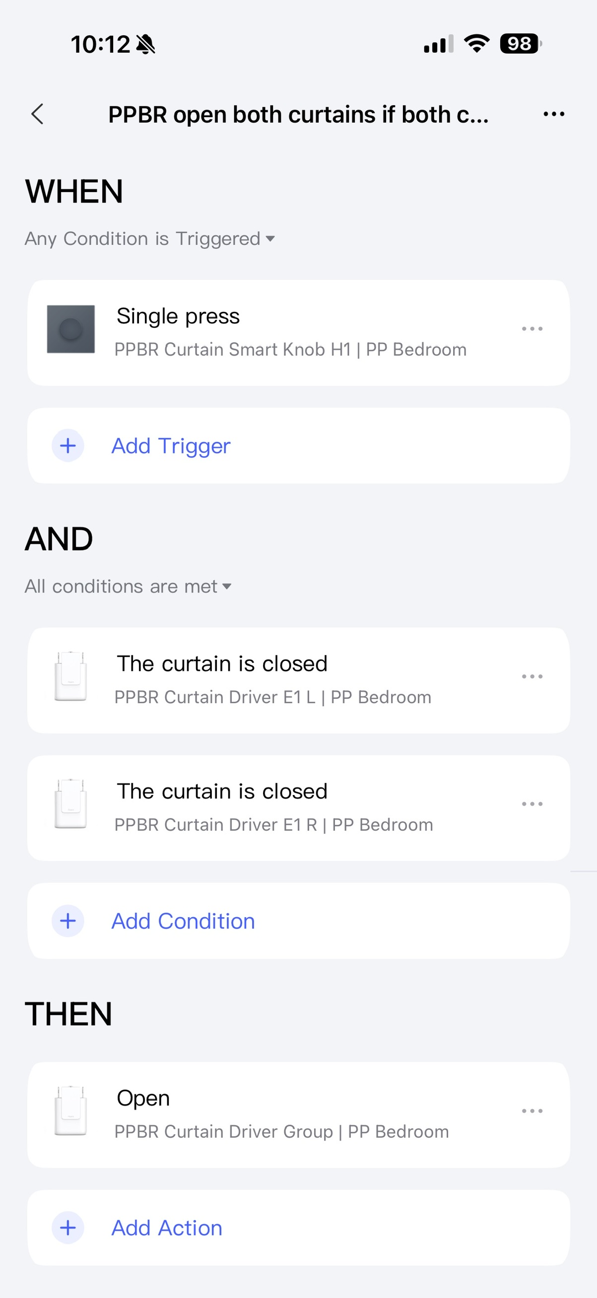

Here’s a screenshot of my automation. Yes, using Automation 2.0

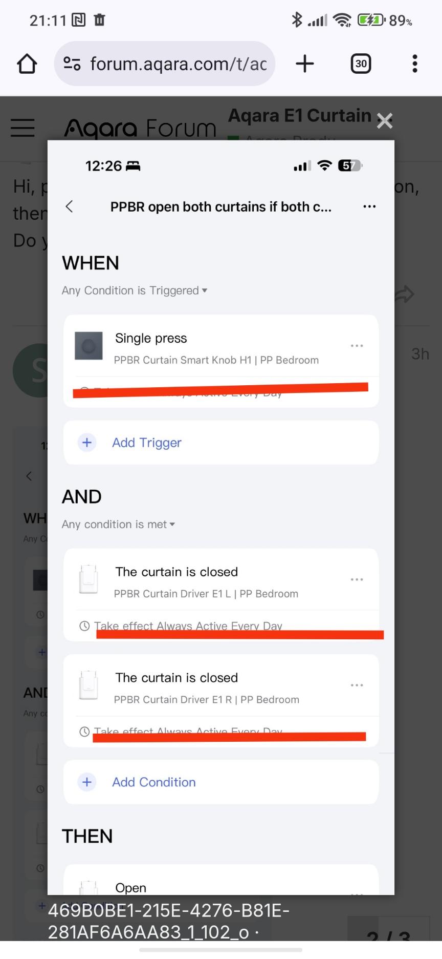

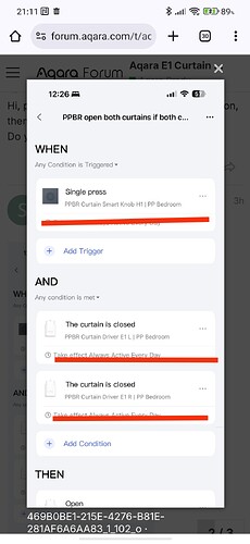

Hello, remove this setting, it blocks automation for you.
I removed the acting time and it still doesn’t work…

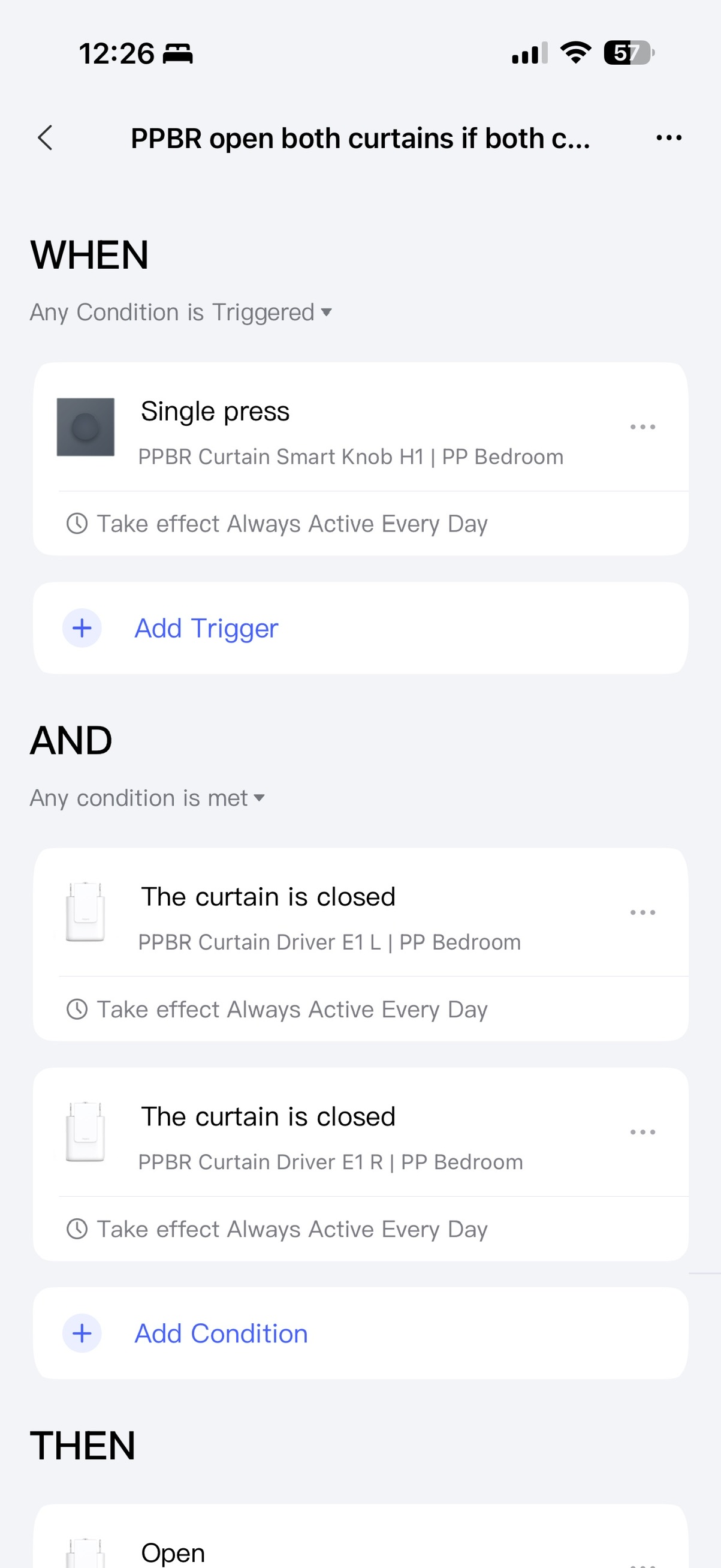

What you are doing is not visible on the screen.THEN

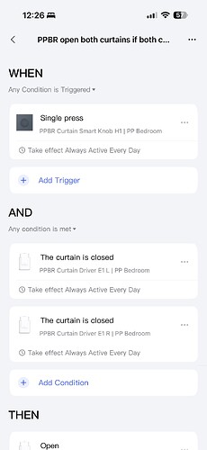

This is how it looks like now. I removed the acting time and screenshot shows then THEN condition.
If I remove the AND conditions and leave them blank, the automation works perfectly. That’s why I am wondering if somehow the curtain open/close state is not defined or set up properly. I went through the setup process again just to be sure but it still doesn’t work.
Just to narrow down the error, what happens if you change the AND condition logic from “all conditions are met” to “any condition will be met”?
and for the experiment, put one arm of the curtains. And remove all additional conditions. In your version, they are unnecessary

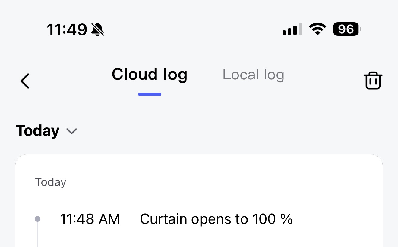

Also look at the E1 driver event log, is there “closed” there?
Removing all of my conditions. Triggered the automation to open the curtain. Checked the log and it does say it’s 100% open.
I think perhaps the log updates what action was taken but not what state is the curtain in?

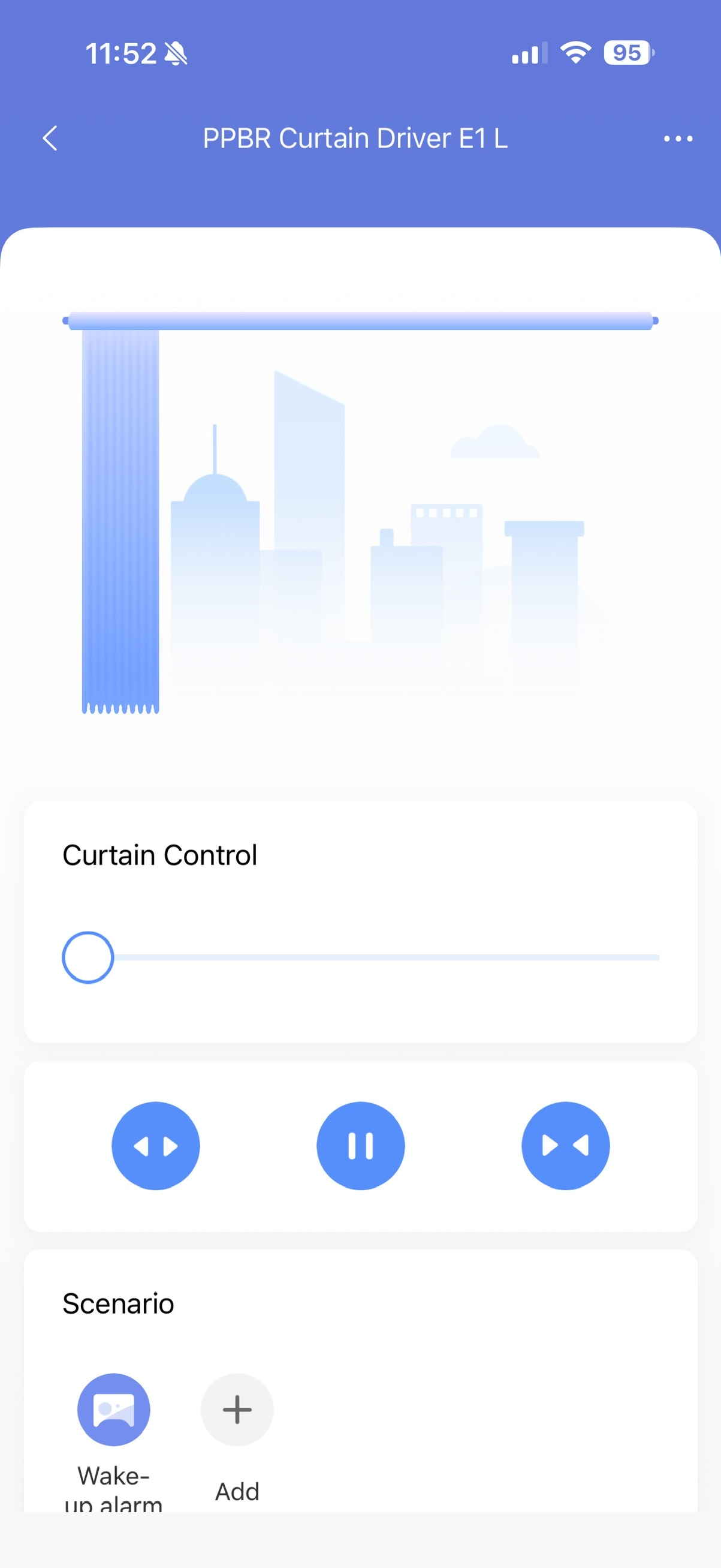

I would suppose this shows the status of the curtain? This shows it is open

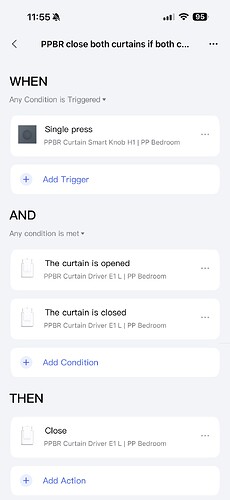

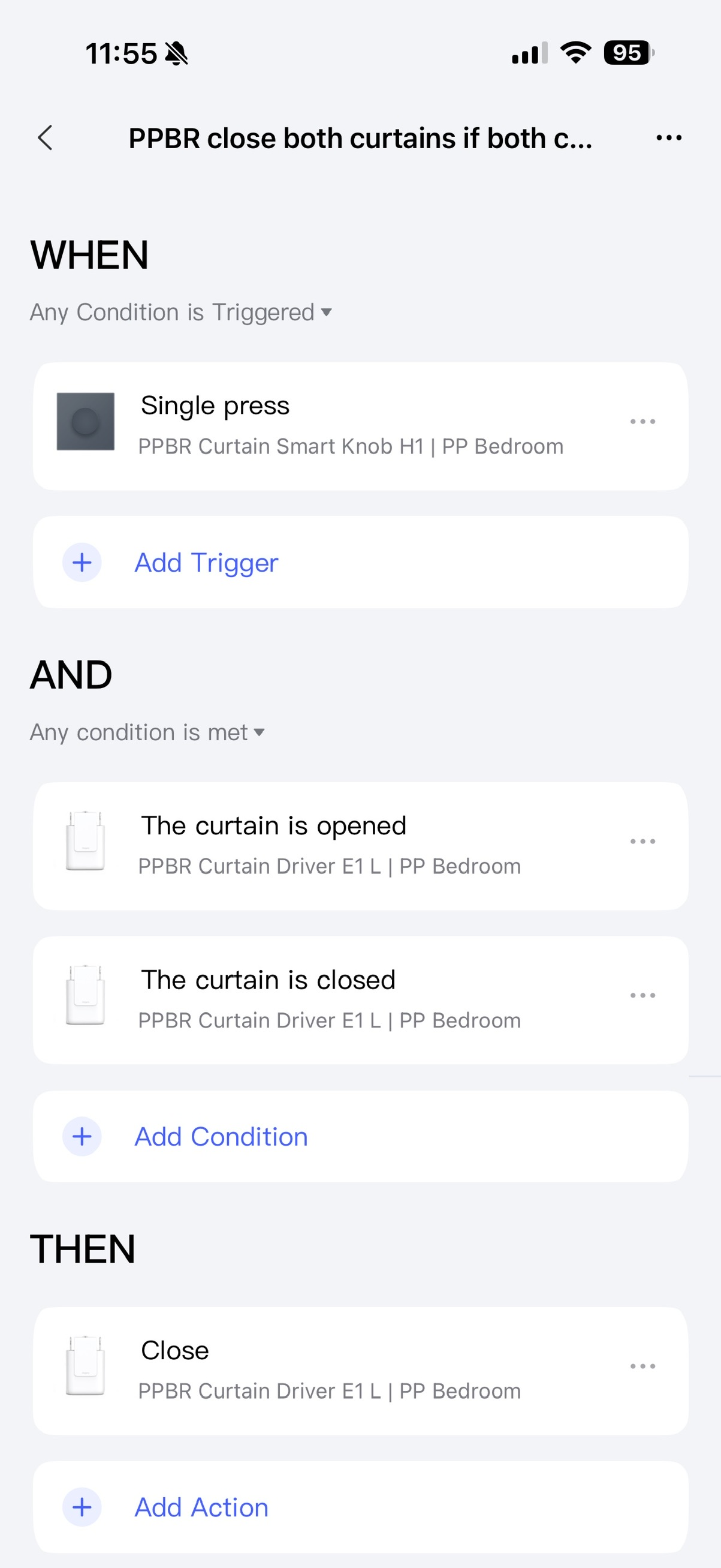

Just for the heck of it, I set an ANY condition for the curtain to be closed if the curtain is currently open OR closed. It still doesn’t work.
