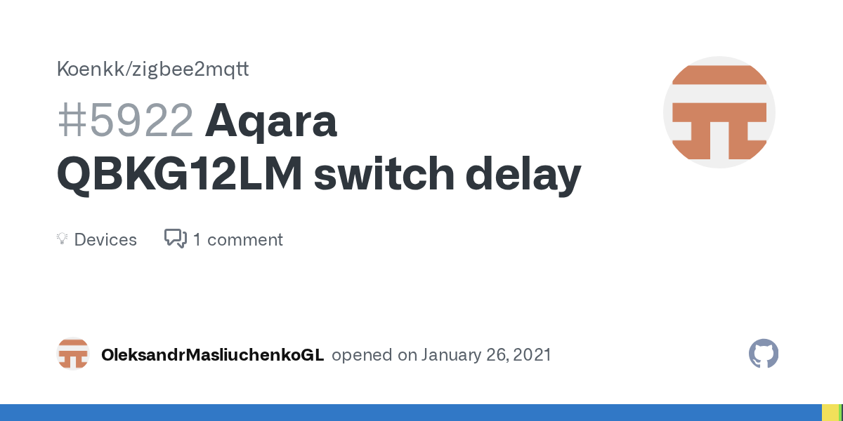

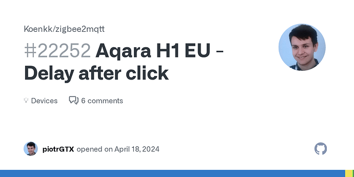

I’ve come across this issue on numerous GitHub pages also, e.g.:
It seems rather bonkers that a wireless switch has instant interactions, but wired switches have very noticeable delays… seeing as this is an issue that has been ongoing for years, without Aqara releasing any firmware updates to fix, I don’t imagine they ever will do anything about it unfortunately…
