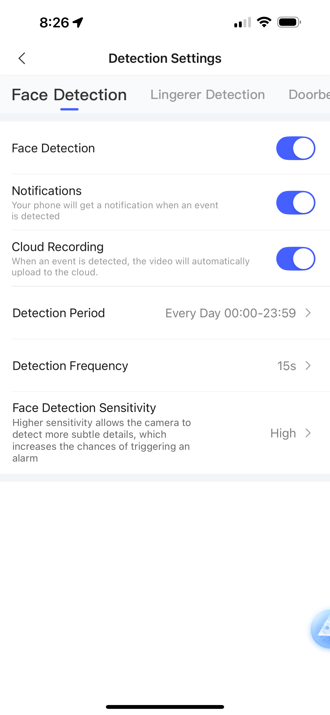

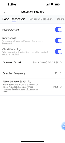

I got a g410 doorbell and Face recognition doesn’t work properly for adults. It does work for kids if they come close to the doorbell and pause for couple of seconds. Is it a problem with the height of the camera (installed about 1.20 m from ground) or just the picture added when I setup the face recognition ( I used a selfie)?
I would first turn on the face detection for 2-3 days and then name the faces in the Aqara app. Then the camera directly has the appropriate facial data. And in Apple HomeKit you need iCloud+ which is not necessary for this automation. I don’t think it’s bad if it’s not quite that high. Maybe you set the speed for face detection to the smallest duration (if you have a power connection)
Here are my settings for face detection. Please let me know if I should change anything. I will assign faces and I hope it will make a difference :slight_smile:
I have the same settings, but without Notifications.

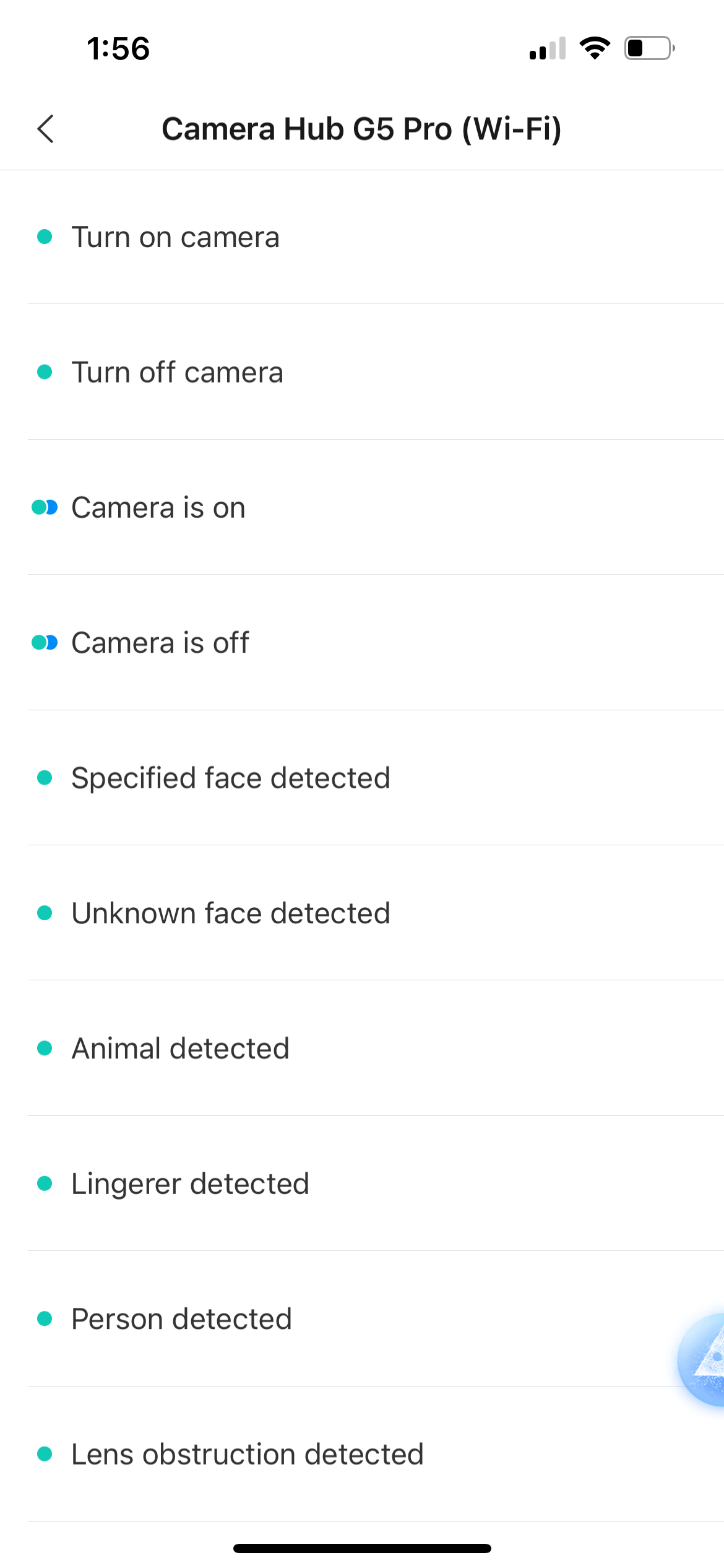

Expose the face recognition with a matter occupancy sensor in HomeKit via aqara matter controller and the trick is done
That’s what I’m trying to do right now. I have already managed to integrate it into HomeKit.

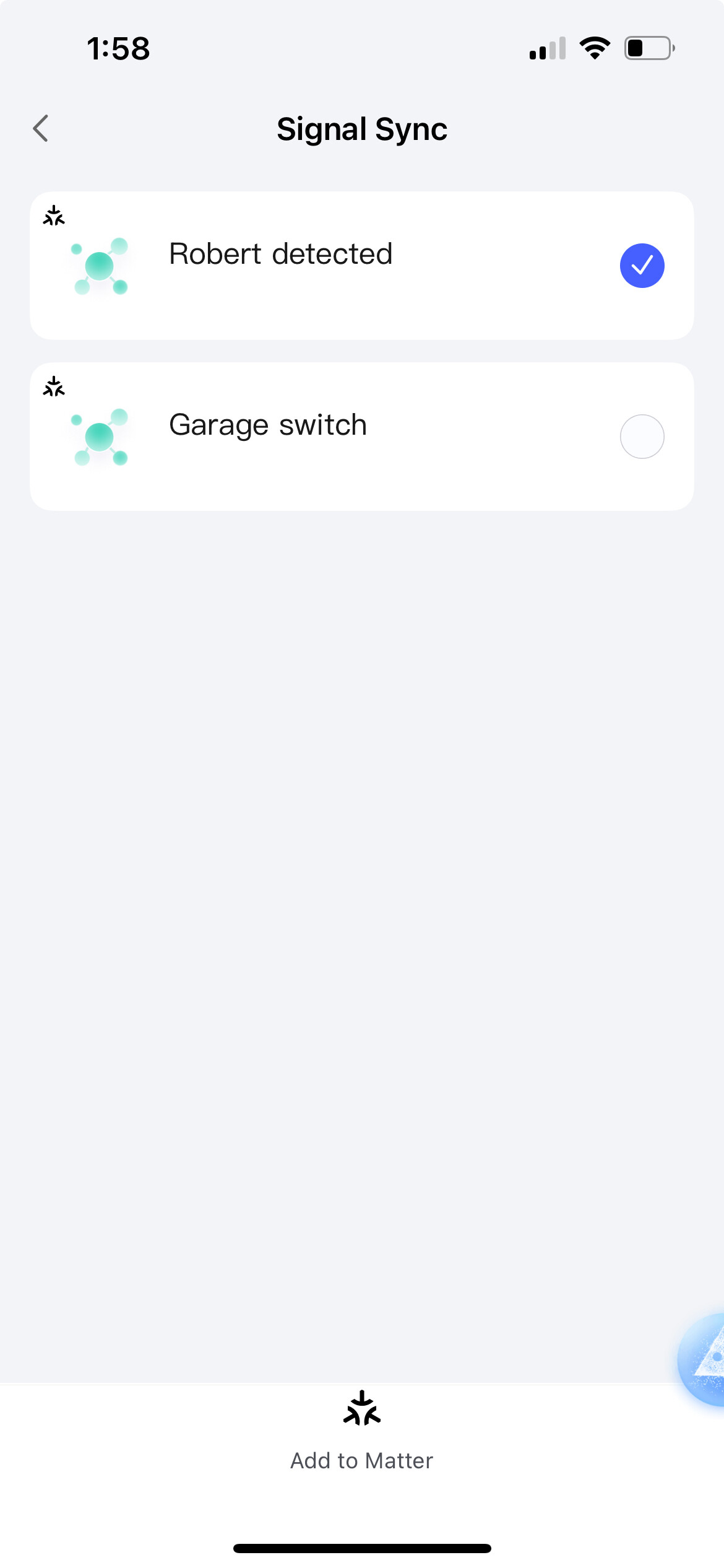

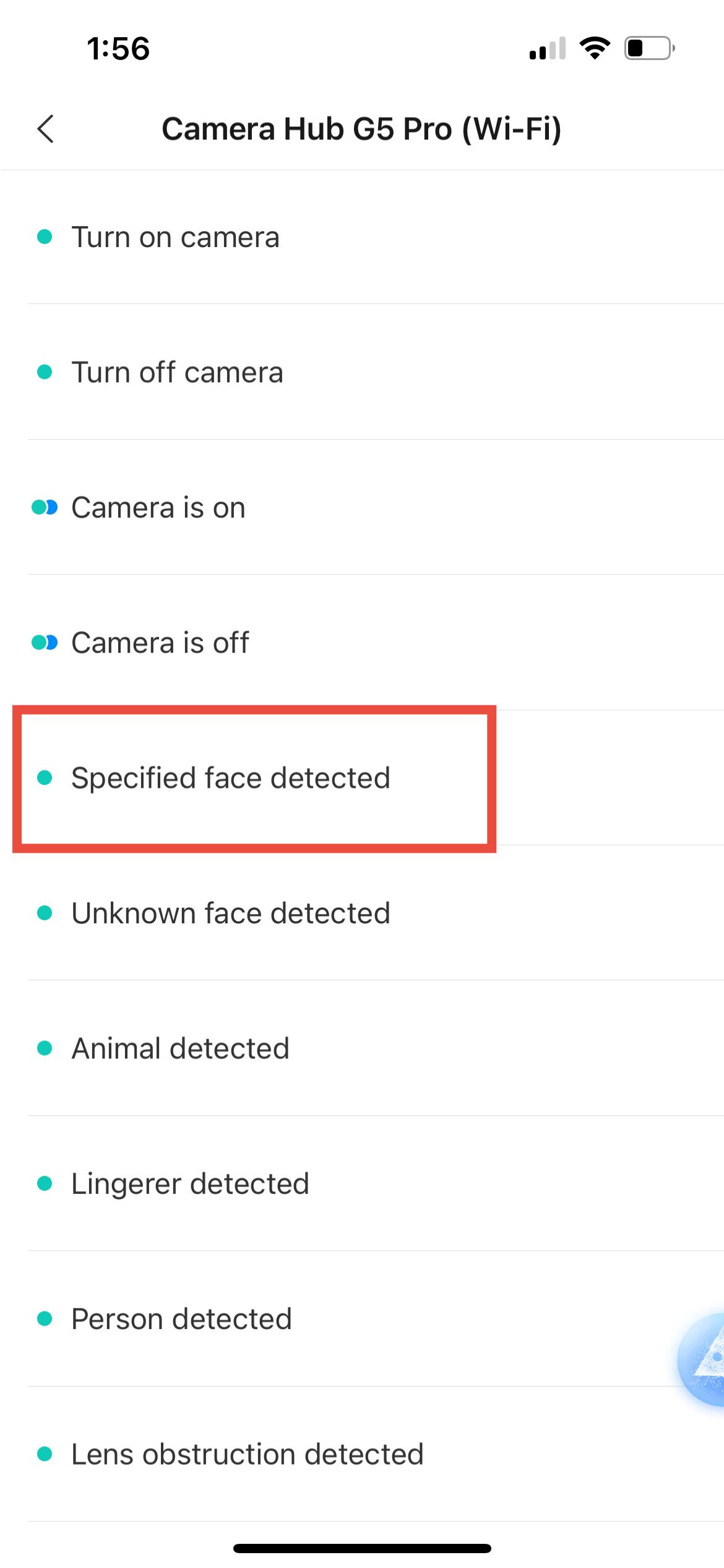

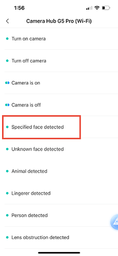

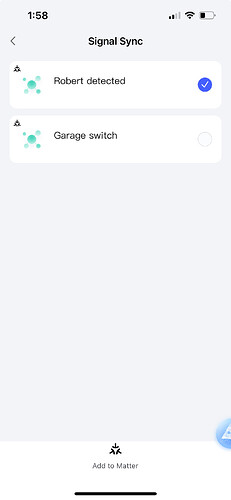

Use Matter Signal Syncs for this>
In the Aqara app go to profile, then
  1. Connect to Ecosystems
  2. Matter
  3. Scene and Signal Sync
  4. Signal Management
  5. Click “+”
  6. Search for your camera, then select signal.
  7. Choose “Specific Face detected.” and then choose the face.
Now you go back and view “signals sync” select your signal and click “add to matter.”
