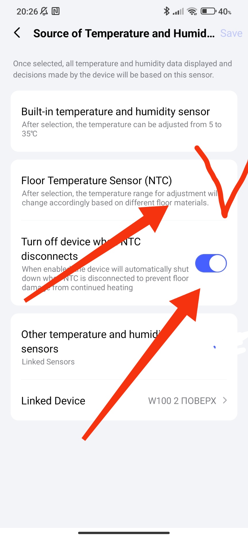

Hello, welcome to the forum. Yes, the built-in NTC sensor control will always work when it is 40°C, provided that it is not selected in the temperature control settings. If you have selected the NTC sensor, the W500 controls the temperature using this sensor (NTC), depending on the floor covering, you can select the control range (maximum 27°C, 29°C, 40°C). If you turn on the additional switch, when the NTC contact is broken, the W500 will turn off until you restore the contact.
For control, you need to select NTC.

I understood you right away, so I suggest you choose an NTC sensor and set the temperature you need to keep on the floor. The disadvantage of this method is that you need to use an additional temperature sensor that will be involved in complex automation (example W100+NTC).
The W100 can work as a thermostat (you control the temperature of the floor control), but must be untied from the W500 (as an independent sensor)
At the moment, it is not possible to use NTC+built-in sensor simultaneously.
