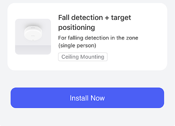

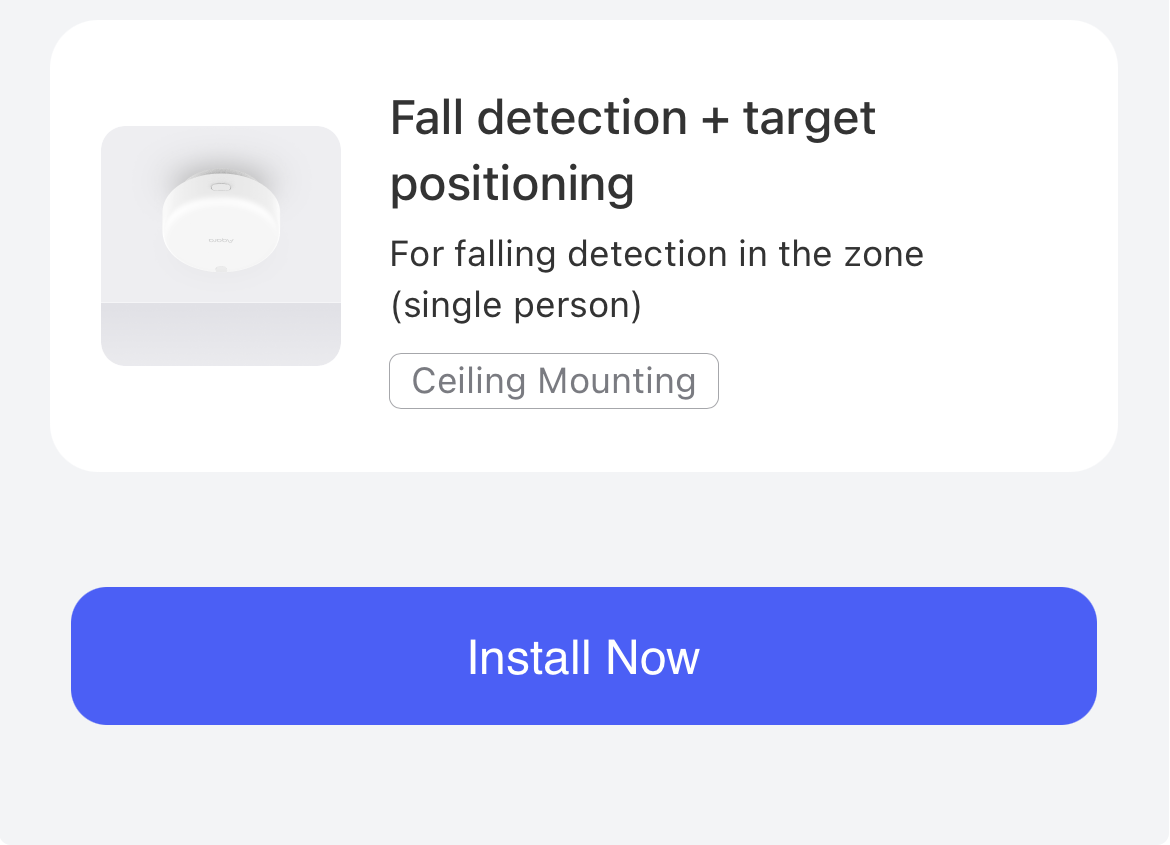

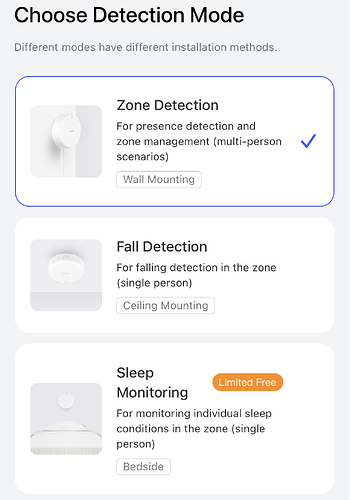

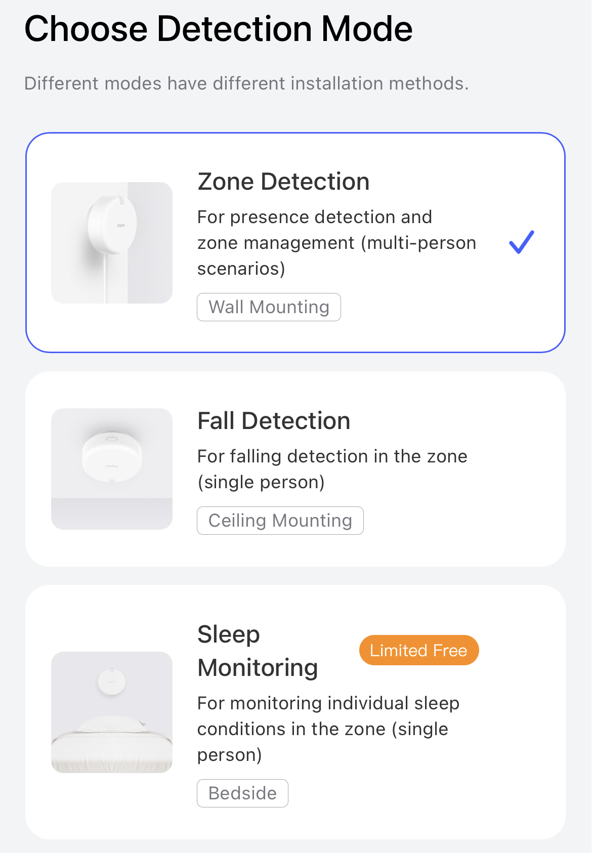

No, not really. In addition, you have to choose a detection mode during installation:
