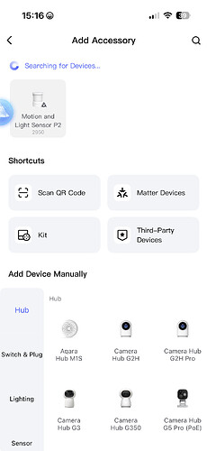

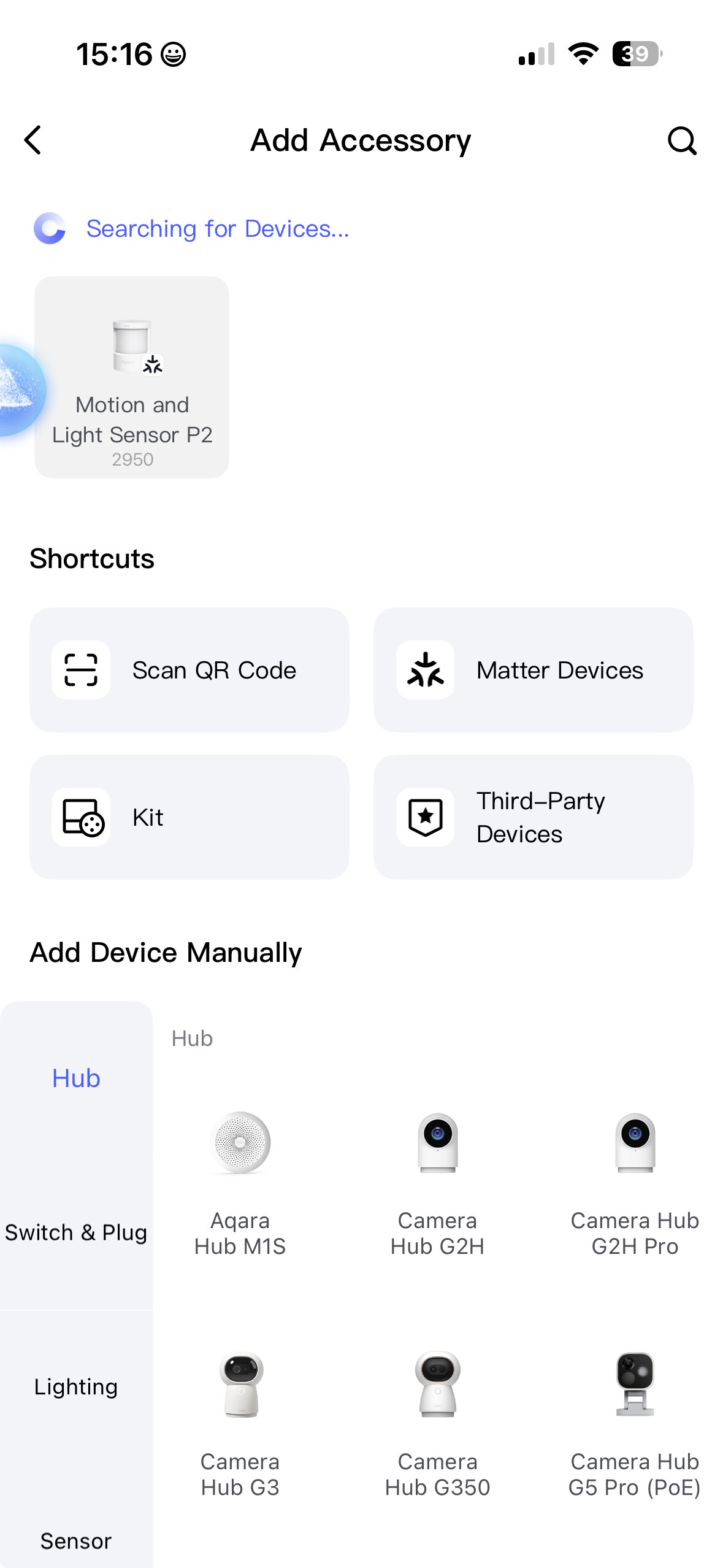

Hmmm. Doesn’t look anything like my app. Every time I select the FP2 it immediately takes me to Matter. This is all I see.

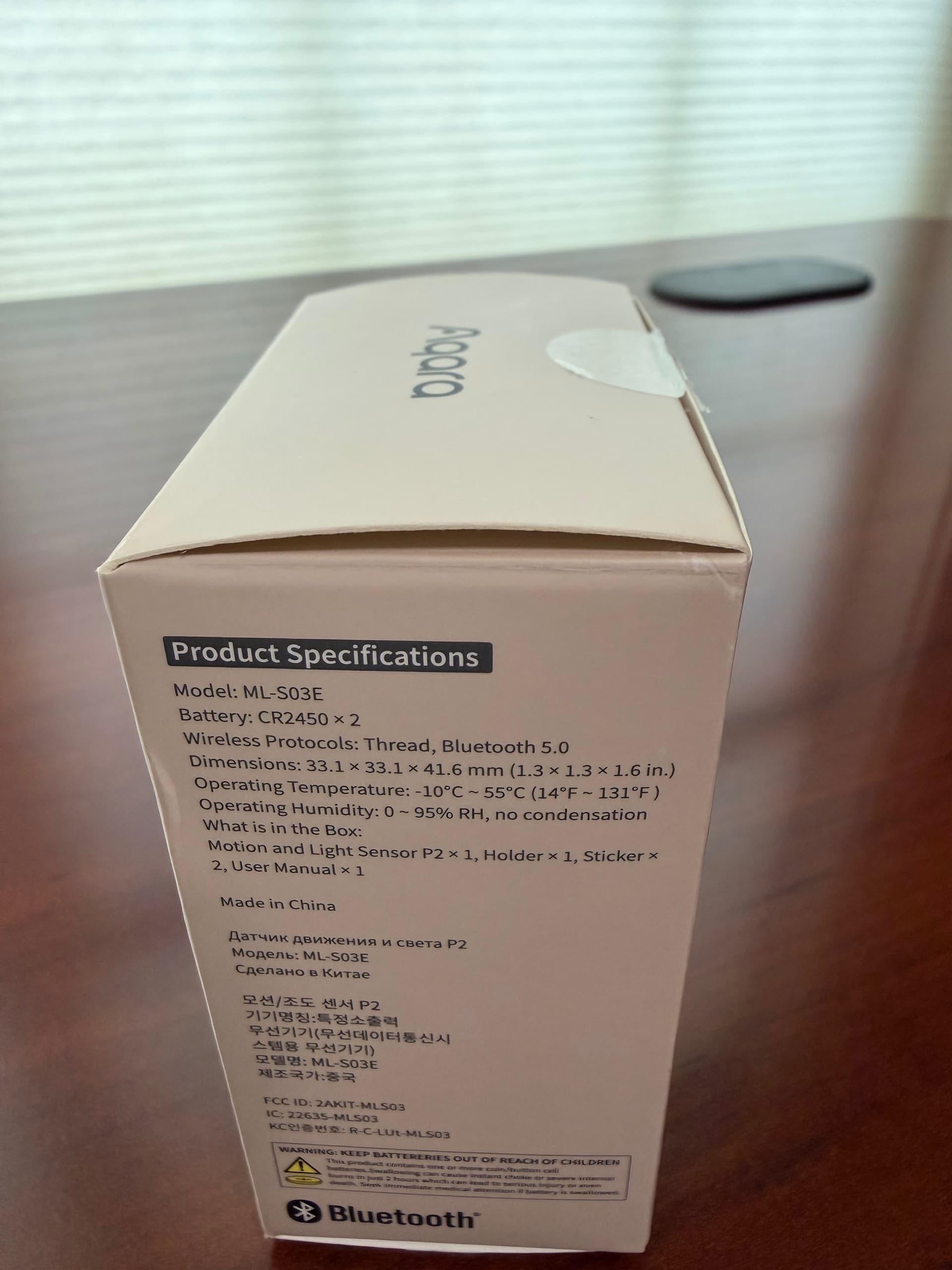

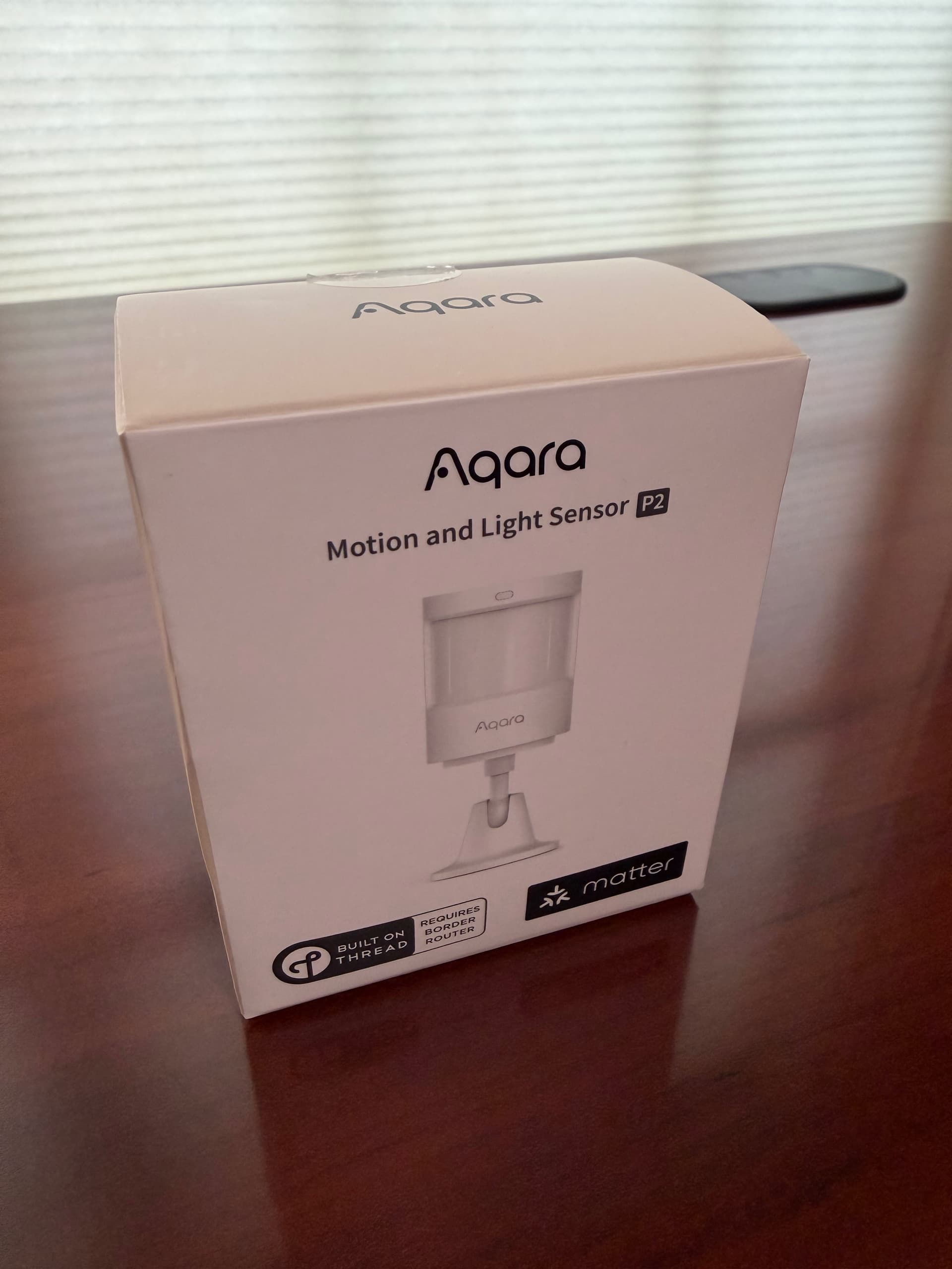

Are you talking about the P2 (on the screenshot) or FP2? Those are two different devices
Hi, @cezary806 , I ran a little ahead, you know what. :joy:
Haha, most of the newer Aqara devices allow to switch protocols, so it was safe to assume it was possible here
@lss_1 if you’re talking about the P2, then it’s Matter only, sorry. You cannot pair it with the M2. If you had the FP2 (scroll down to see how it looks like) then you would be able to pair it.
But honestly I don’t remember any update of the P2 so I don’t think you’re missing anything
Oh! Yes. Sorry. I have stared at so many different Aqara devices, I get them confused.
I don’t think the Aqara Motion & Light Sensor P2 has the Zigbee option. It’s a Matter over Thread device (only).
