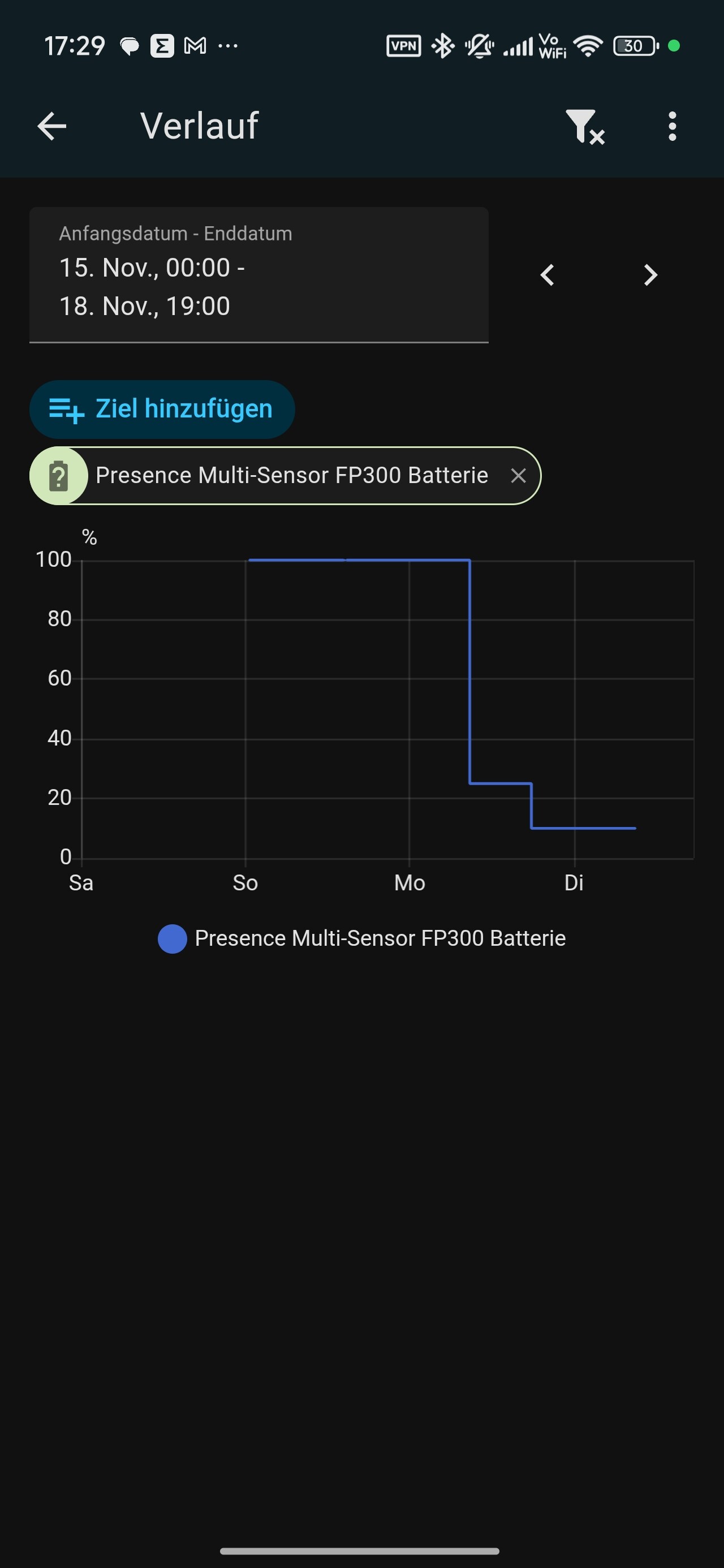

My fp300 died after 3 days, battery empty… Using it via matter over m100 hub and integrated into homeassistant.
