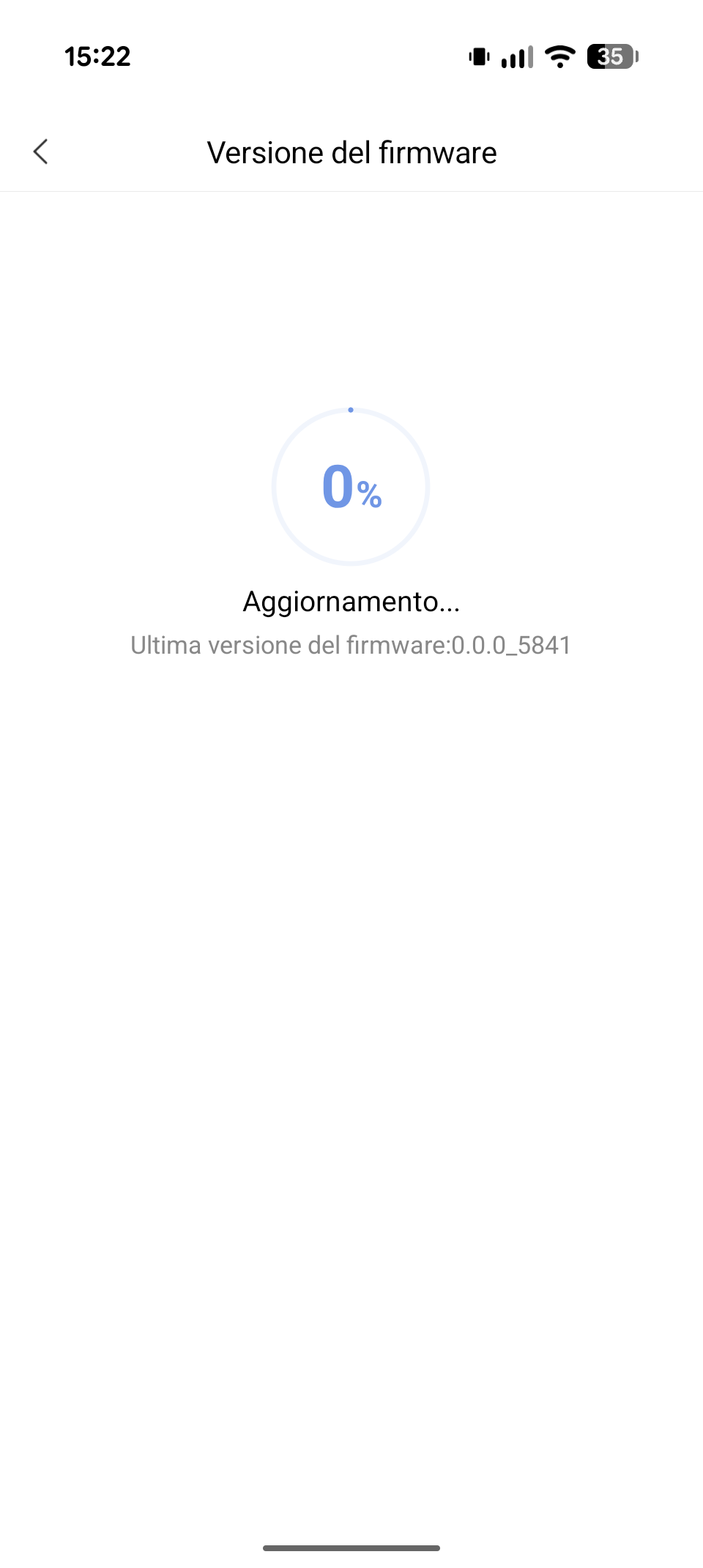

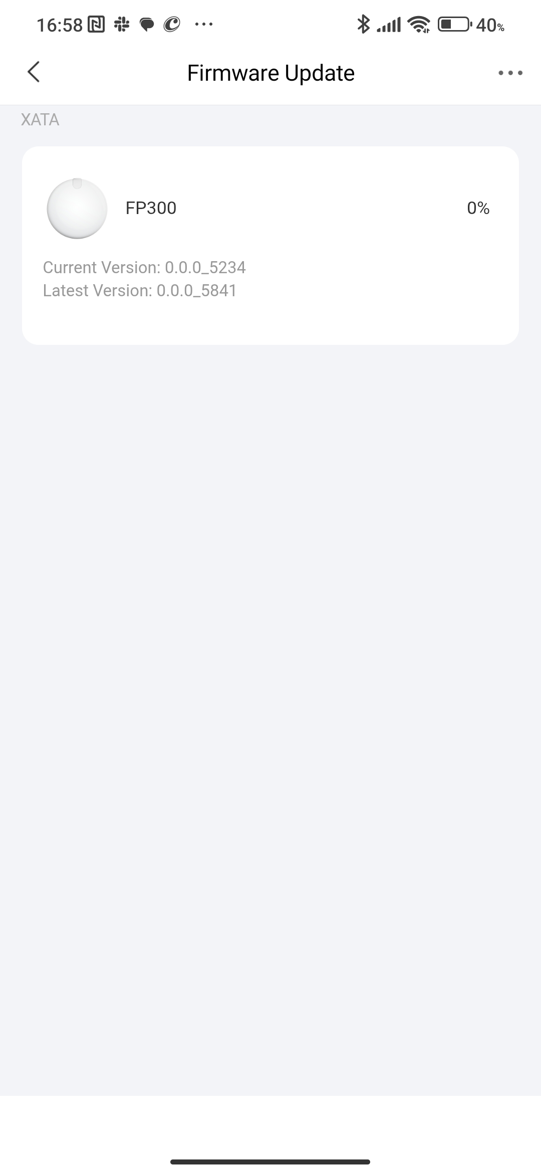

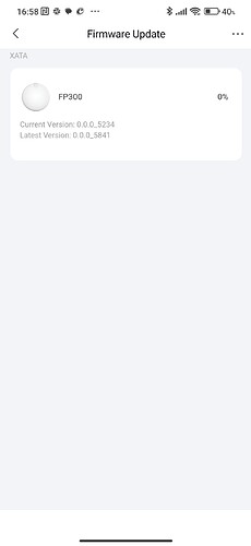

Hi everyone :wave:, today I received an update for my Aqara FP300.
Current version: 0.0.0_5234
Latest version: 0.0.0_5841.
So far so good, but as soon as I start the update, it begins and then stays at 0% without progressing. Has anyone else experienced the same issue?

Same here, it says to press the button on the device but that doesn’t help
Try taking the batteries out and putting them back in. I managed to do this with two W100 temperature sensors.
Doesn’t work for me.
Same here :face_with_monocle:

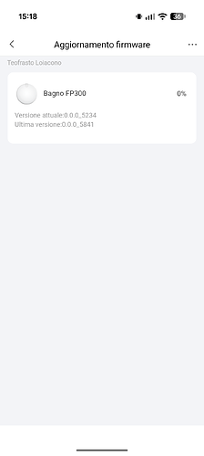

Hello, I have the same situation.
Mine took a time to update… It showed 0% all the time but direct in the device settings it showed the updated status!
If it really doesn’t start, I would press one time the button on the device to set an impulse
I had the same issue, pressed the button and it started moving faster. If it’s not updating maybe remove/replace the batteries and start again
Try temporarily moving nearer the main thread hub.
Also when initiating the update perhaps wake up the device with a button press on the device.
Thanks to all @experts, it work. Thanks a lot :pray:
Had same issue. After a few tries it worked. Closed the app and after a while reopened and it was updated. It might help if the fp300 has detected activity before updating.
I took the sensor to the hub, pressed the button, and the update downloaded and installed.
