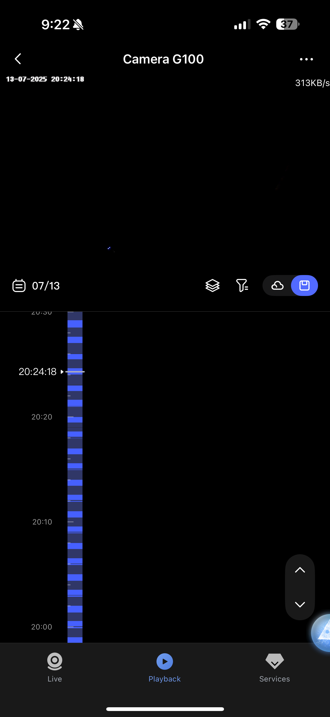

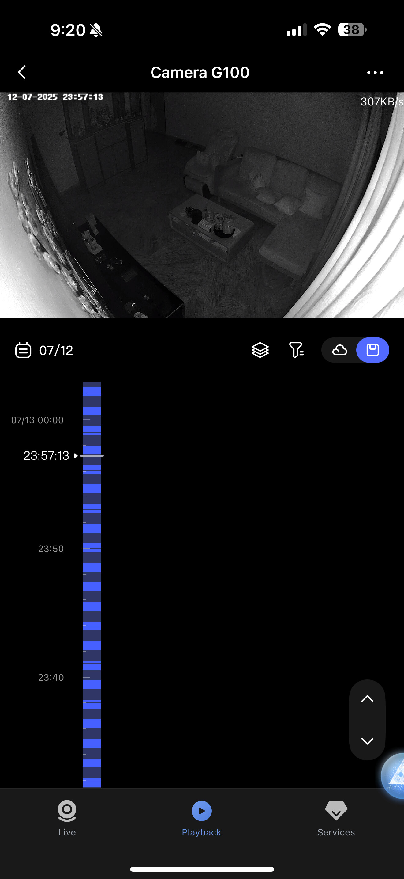

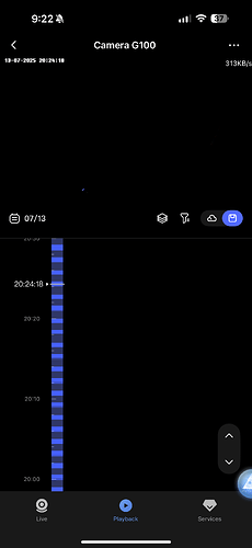

I’ve been experiencing an issue with my Aqara G100 camera where it keeps switching between night vision mode and normal mode throughout the night.
According to the event timeline in the Aqara app:
• The blue sections indicate the camera is in normal mode, but during those times, the environment is completely dark.
• The non-blue sections are when night vision (IR) mode is activated as expected.
The camera seems to incorrectly detect ambient lighting conditions and switches modes frequently—even when it’s pitch dark. This constant switching is affecting the reliability of the footage and may even impact motion detection accuracy.
Is there a known fix for this? Or is there a setting that controls the threshold for switching between modes?
I’ve already ensured the firmware is up to date.
Appreciate any help or advice—thank you!
