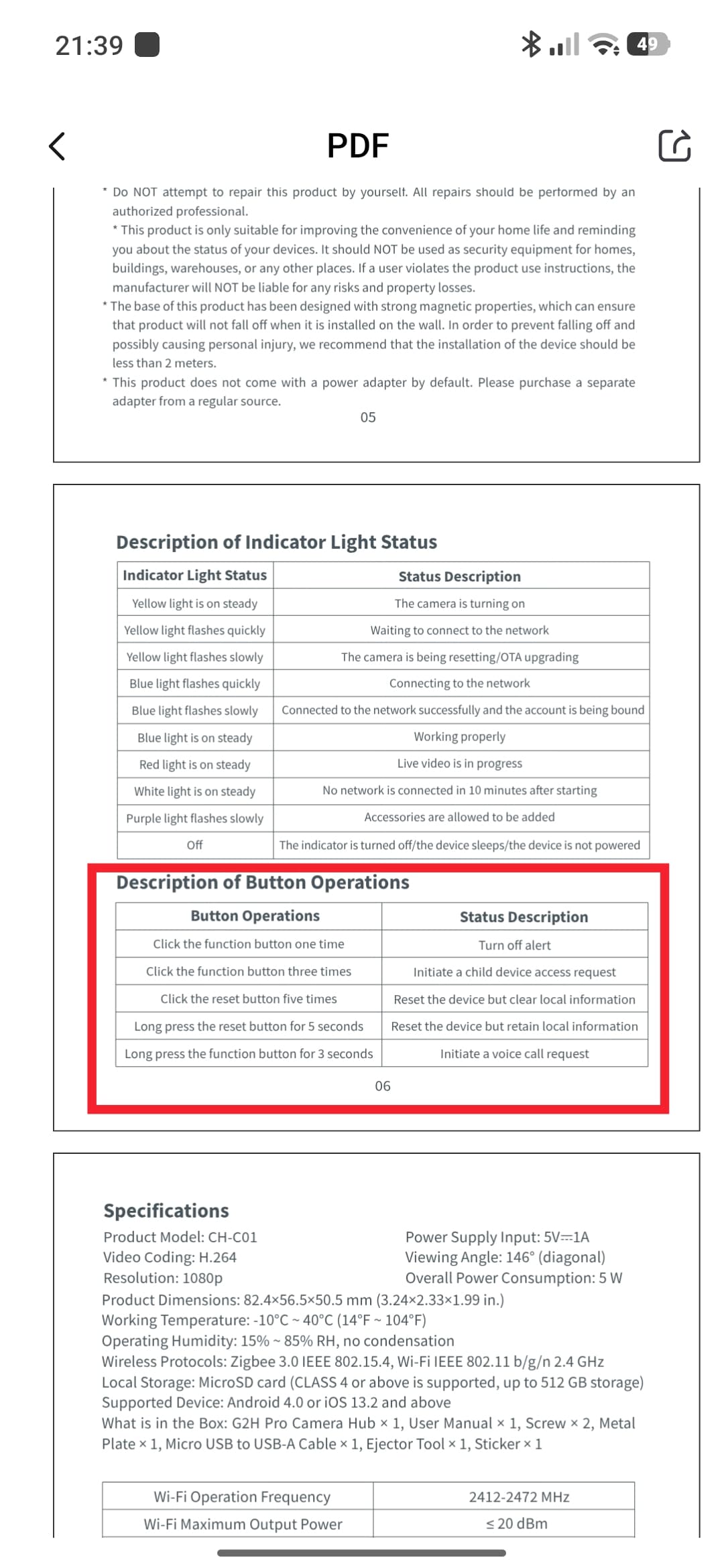

Hello, reset to factory settings (press 5 times quickly).
