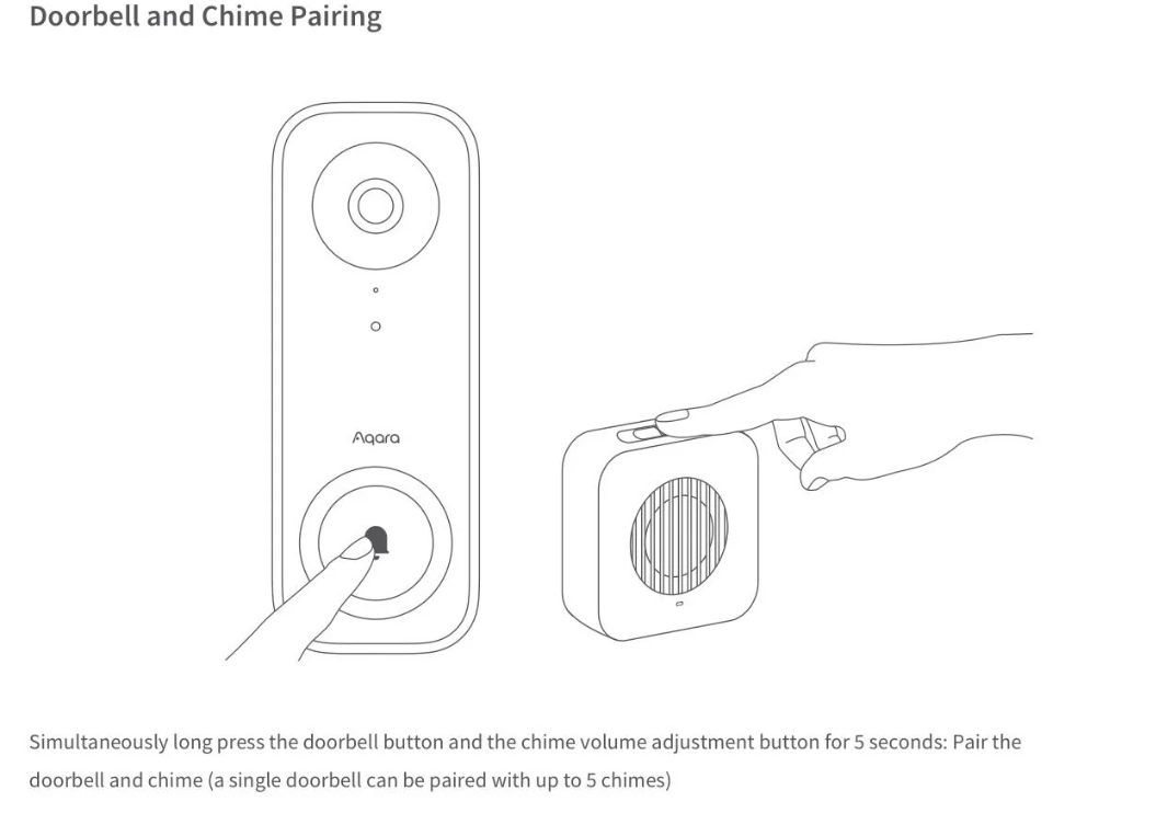

I’m super happy with my Aqara G400 but want to add a extra chime.
Can i buy the same one that comes with the G400 separatly?
In the manuAl has written that it’s possible to add up to 5 chimes i remember. So now i have one en want to add a second one.

I don’t think you can buy the chime separately. When the manual mentions supporting up to 5 units, it most likely means you can link multiple doorbells (for example, if you have different entrances) to ring together, rather than adding multiple chimes to a single doorbell.

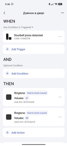

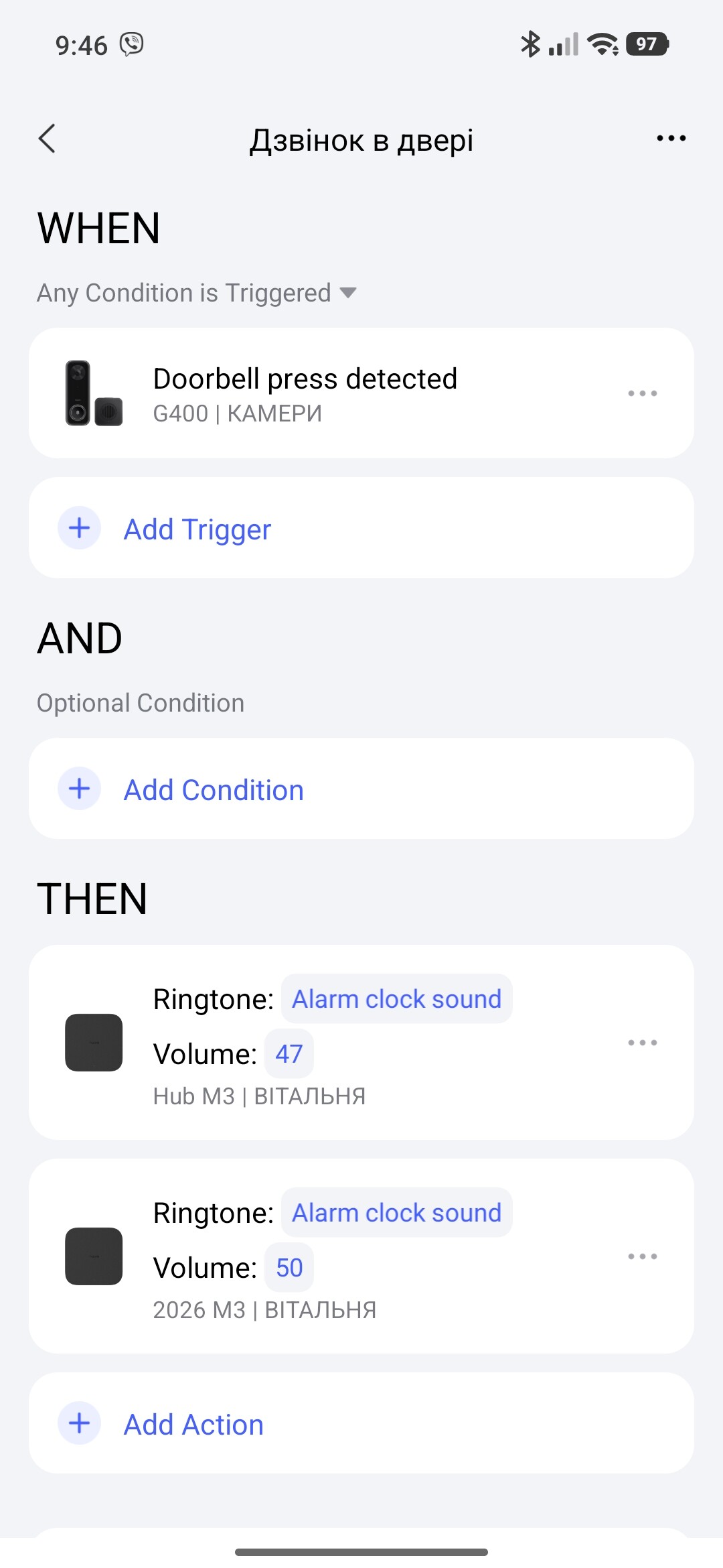

As a workaround, you can use almost any Aqara device that has a built-in speaker and supports ringtones. You just need to set up a simple automation:
  • Trigger: When the doorbell is pressed
  • Action: Play a sound/ringtone on the device
Excellent options for this include the Hub M1S Gen 2, the M3 Hub, or the Camera Hub G5 Pro.
Additionally, if you are using Apple Home, you can easily set your HomePod or HomePod mini to act as an extra chime, which will automatically ring when someone presses the button.
