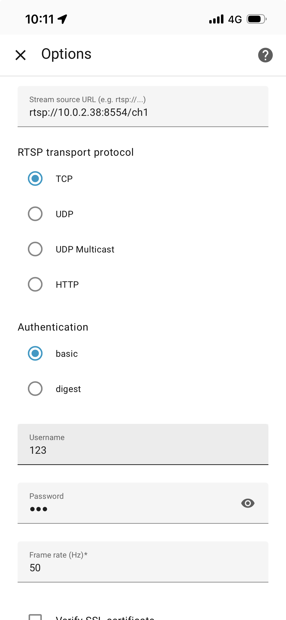

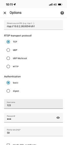

Mine is working using these parameters. The preview during the config flow is not working but the camera is working. Just check the « Everything looks good. » checkbox in the second step.
Doh! I saw the spinning preview and assumed it was not working so I never thought to just check the “everything’s ok” box and submit. It works fine now!

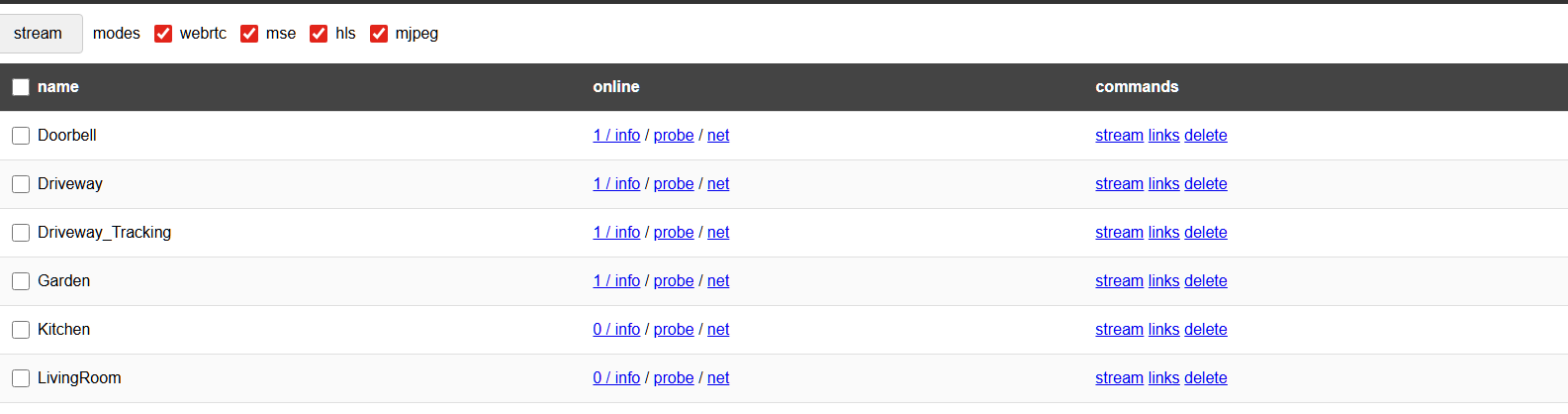

Bit late to respond to this as I have a pc mod project on, but I will give you one amaze moment for your HA setup, go to addons and install go2rtc, then follow guide to add your doorbell…
streams:
  Doorbell:
    - rtsp://509:183@192.168.86.230:8554/ch1
    - "ffmpeg:camerasideroad#&video_size=1536x2048&framerate=30#audio=opus"
once you add this to go2rtc config (go2rtc.yaml) start the addon
then when you open webui you get this
click on links under commands
Now you can use most of the rtsp links to add to home assistant (frigate one i use, but I run through frigate).
