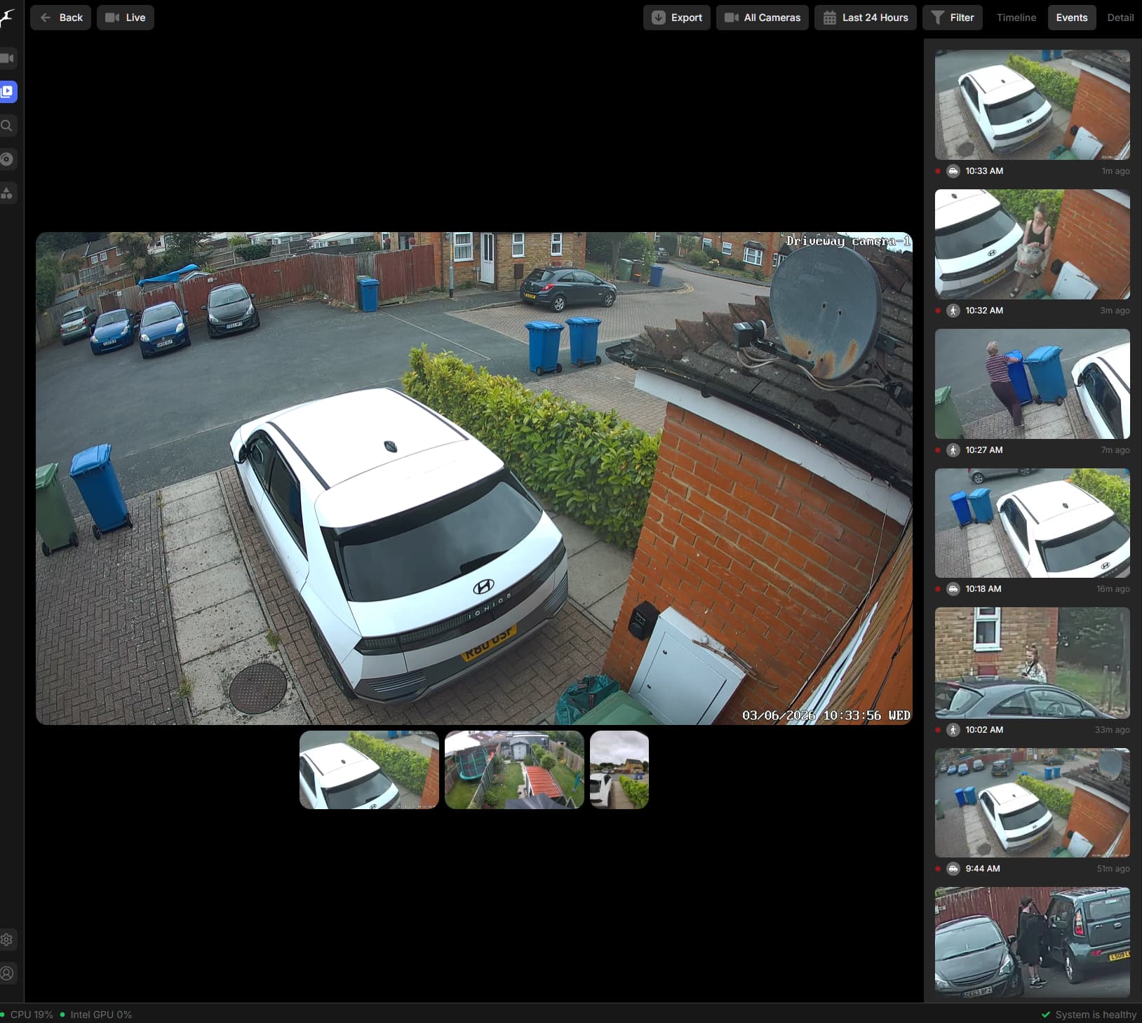

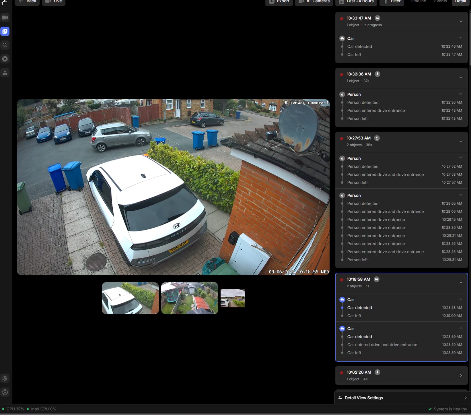

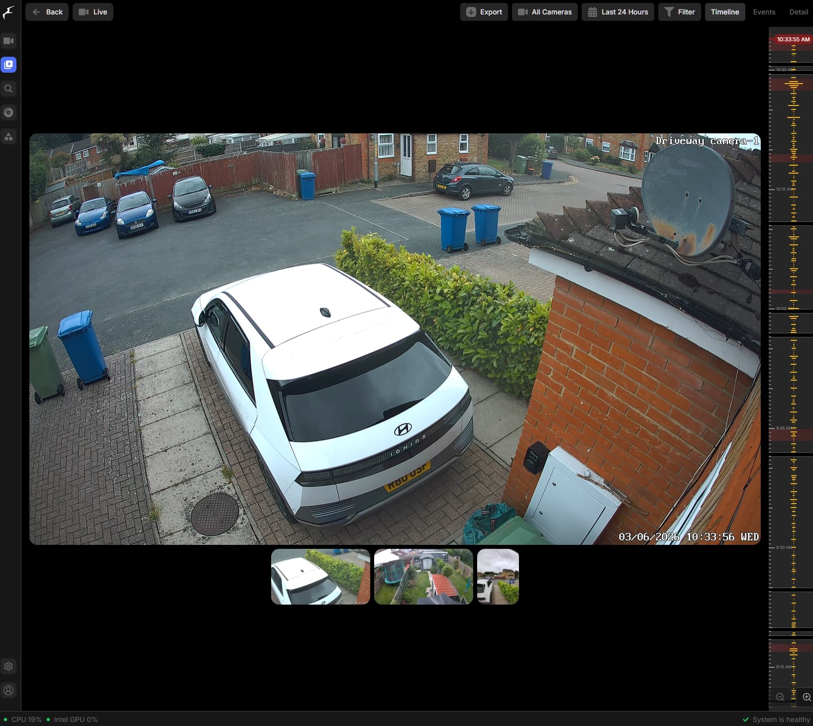

I need 24/7 recording to see who keeps messing around our driveway gare where our car is parked. And lots of attempted break ins happening recently so protecting our surroundings by having an eye is necessary at the moment, i plan to not need footage older then 2 weeks
for 24/7 recording a nas is a must, even better with a good cpu and memory because then it will likely allow you to install a container app, this will then allow you to install frigate, which for me is second to none at the moment.
