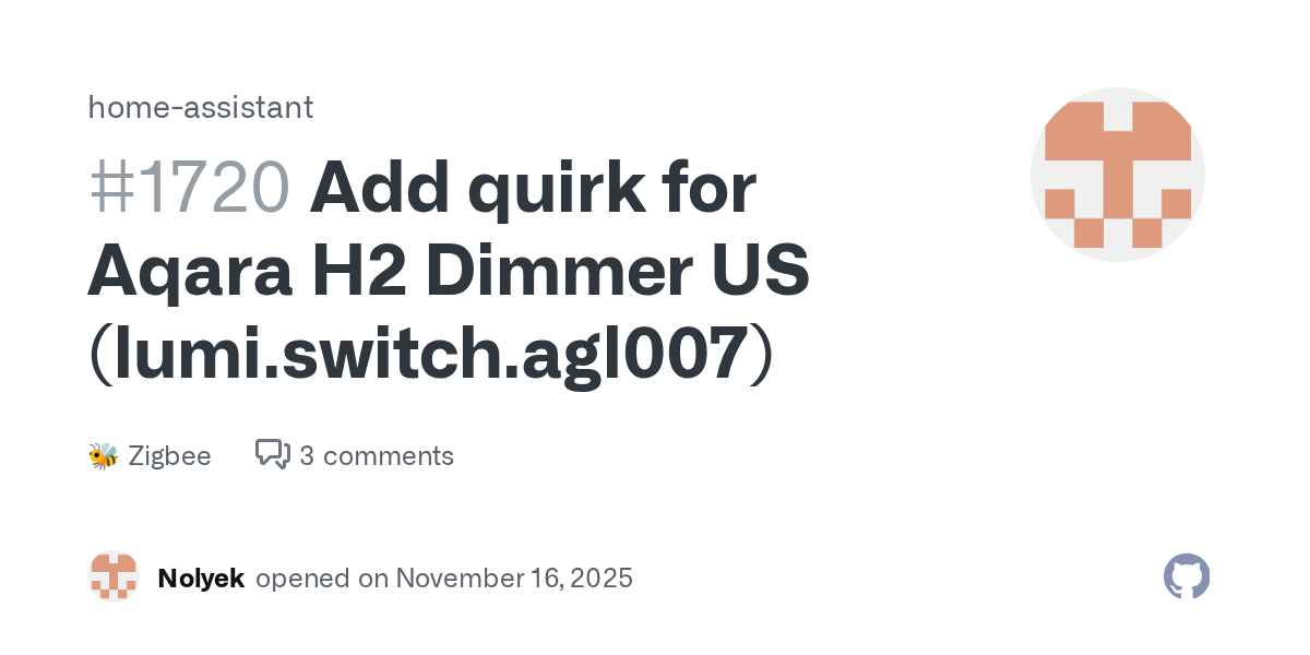

I finally got some additional help from Home Assistant GitHub. See below…
Aqara H2 US true dimmer support using Zigbee ZHA without Aqara hub
Took me a bunch of time figure out how to get Aqara H2 US interfaced to zha to work in “dimmer” mode vs just on/off switch. I needed to add a python quirk file to ZHA. Hopefully Aqara will provide this support out of the box at some point but I fear that they may just want to sell more hubs to people. In any case, I was happy to find this one on the HA GitHub site… Keep in mind you need to use the Aqara app to switch to the Zigbee device firmware first and then pair it with ZHA but install the quirk file below first.
This also took a little extra tuning to get device names properly aligned before it worked for me (with a little help from Gemini…)
