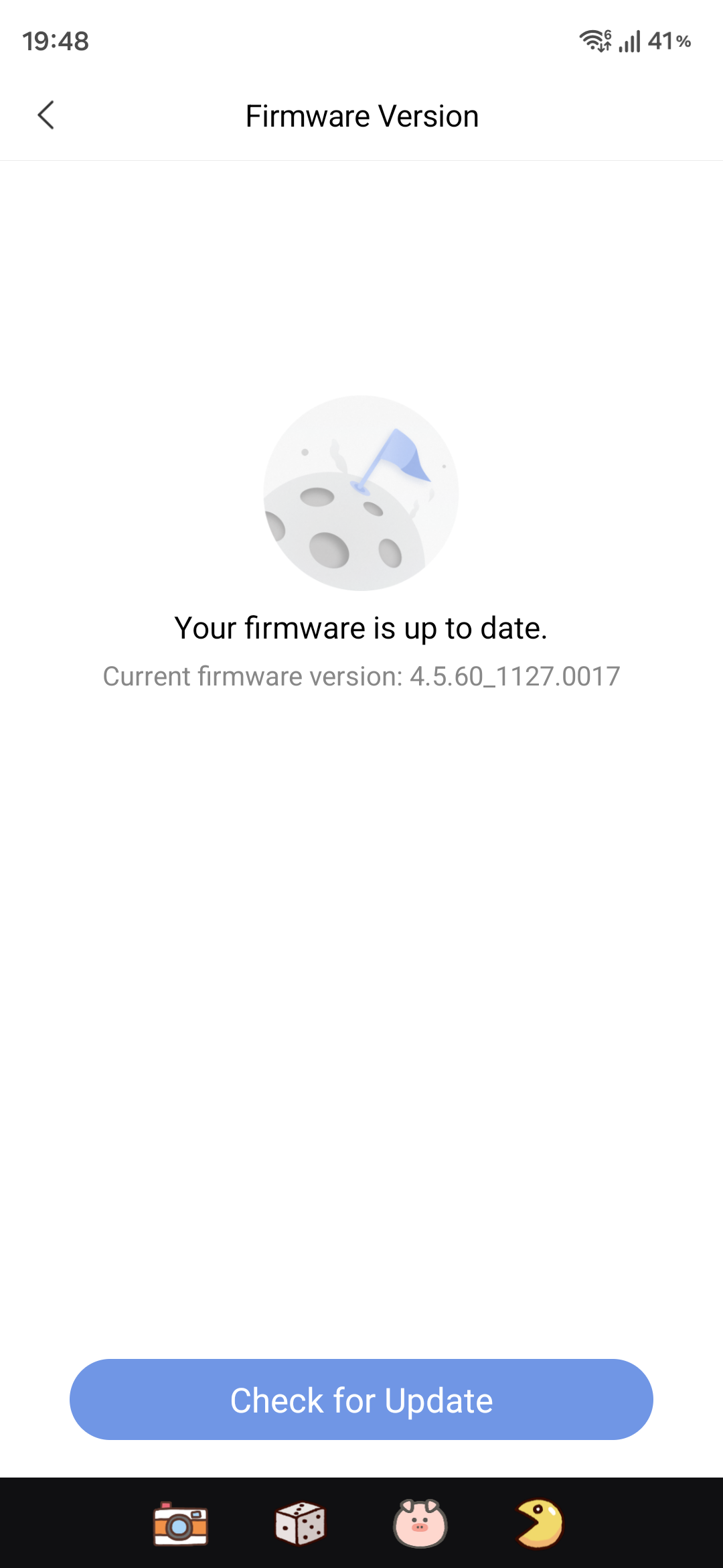

Followup… I had a few rounds of back-and-forth with Aqara support. There was also a firmware update to 4.5.60_0019.0017. I had no confirmation of any changes, but the issue went away. At the moment I’m not sure if the issue will come back at a later or if a fix has been put in place. I’ll update if it comes back…
Glad the Update has fixed the issue. Or does it came back?
I had similar issues, but they fixed everything with that firmware
