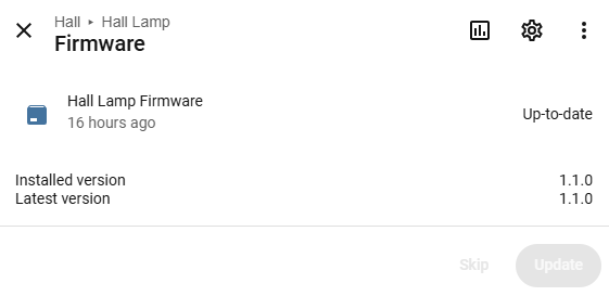

Best I have is 1.1.0
Mines linked through the M3 and then into HomeAssistant…
The updates normally show up here and apply to the bulbs.

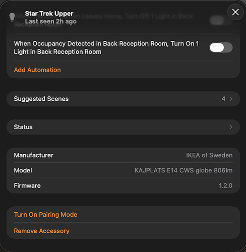

Well I have connected mine to Apple Home and because Apple have implemented the Matter OTA service, which Ikea also have, then it was available via Apple Home in my case.
Thanks , so I will give it a try over Apple!
It should just show up as needing an update. Mine did. BTW, I’m running 26.4 PB2
