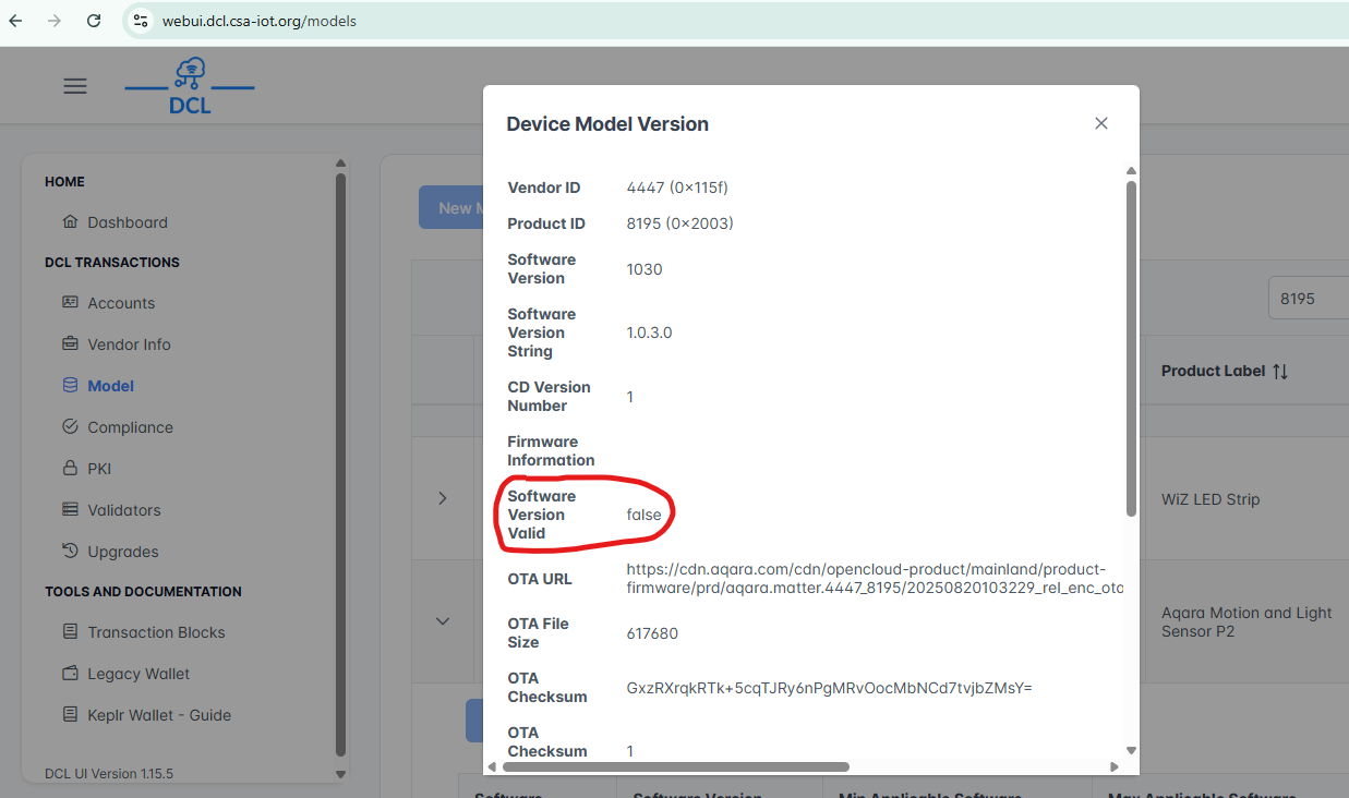

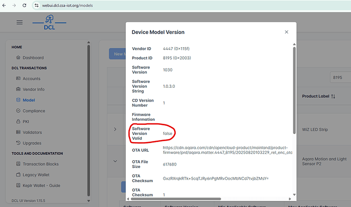

This explains why the update isnāt showing up for the sensors. Matter platforms like Home Assistant or Apple Home verify this ledger before offering an update. Since the version is flagged as invalid (either it was pulled due to bugs or hasnāt been fully certified for OTA yet), these platforms are strictly blocking the update.
No, it is not a server outage or a scheduling issue.
I was actually able to manually download the .ota file from their server, so the infrastructure itself is definitely online and working.
The āValid: Falseā status in the DCL is a deliberate āflagā set by Aqara. Think of the DCL as a public safety catalog for Matter devices. Even if the firmware file is technically still on their server, Aqara has updated the catalog to say āDo not install this.ā
By setting this to false, they have effectively engaged a kill switch for the update. This confirms they intentionally pulled the version, likely due to bugs found.
I am a software developer myself, and this looks like a standard āstaged rolloutā procedure. We usually release updates in waves to small groups first. If Aqara receives error reports (telemetry) from users, they can make the decision to stop the rollout. In my opinion, this is the most likely explanation.
