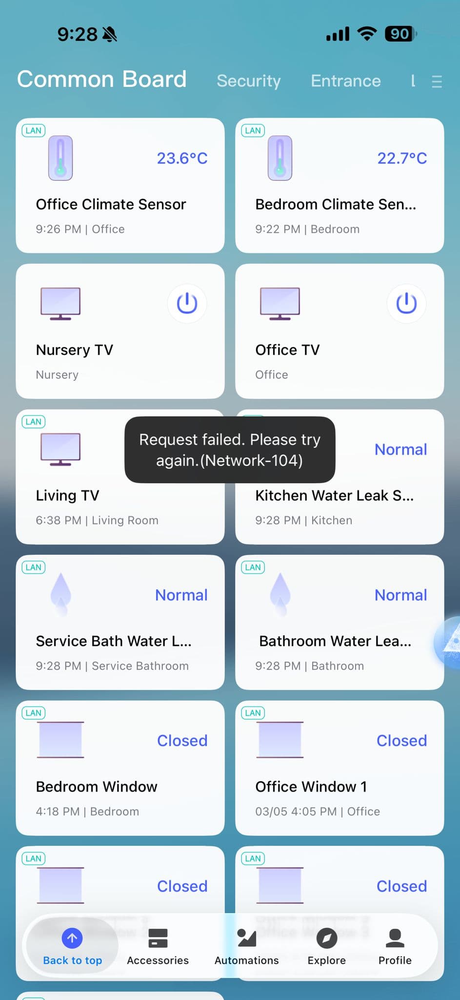

I recently replace everything in my house with Aqara products. I choose to connect them thru Matter over Thread instead of Zigbee. I will list down all the products, if have any importance. The problem is the app have a big delay. No to mention sometimes is not even taking the commands. One night i had to get out of bed to manually turn off a light because from the phone was unresponsive to command. Not to mention that sometime I get an error message. I will attach a photo.

That looks like a connection drop.
Adding more thread border routers might help stabilize your thread network.

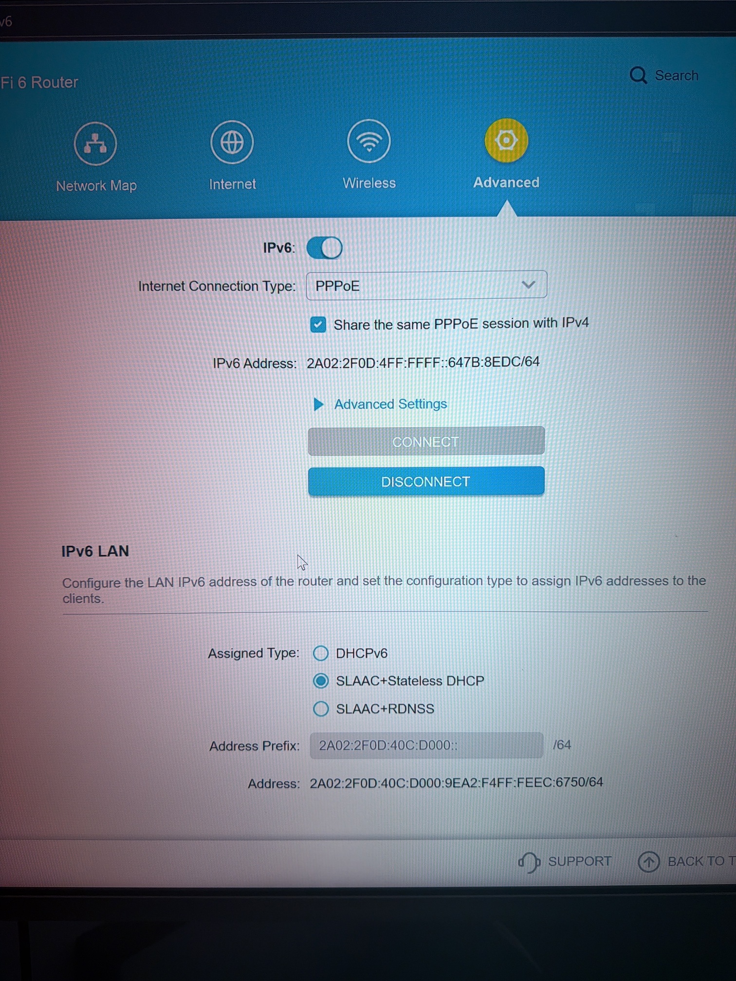

You should also check whether the devices are receiving IPv6 ULA addresses (Unique Local Addresses). And switch from a DHCPv6 server to SLAAC. For me, this has eliminated connection drops, as it makes the Matter network independent of the ISP’s frequently changing IPv6 prefixes.
There are 10 switches in all apartment, and the distance between them does not exceed 4-5 meters, every room have at least 2 switches.
Looks like it is on SLAAC
Yes, but those are GUA, not ULA. Those are exactly the addresses that are causing problems.
Yea… This Matter was supposed to make things more easy to use, but look like it’s just opposite…
It should actually be pretty simple. But I see you have a TP-Link router. Unfortunately, that’s a problem. According to the information I found, TP-Link has included this on their roadmap, but it seems that as of today, you still can’t assign a ULA prefix.
Yes, it’a a Tp-Link. It’s just strange how this thing was supposed to be a plug and play become a scout and modify router settings. I wasn’t expecting to that when I decided to use the Matter over Thread. Looks like sometime I’ll have to encourage myself and do the ugly part, to re-add all thru Zigbee….

Detected: eth0 (192.168.8.10/24, fd4f:9e82:e302:e2c2:f146:31fa:baa8:d767/64, fe80::2a26:b199:d168:c894/64)
Looks good! As the addresses start with fd, they are Unique Local Addresses.
Problems only arise if there is no ULA prefix and global unicast addresses have to be used instead, and if the ISP keeps changing the prefix.
It would be even more problematic if your ISP doesn’t support IPv6 and your router can’t manage a ULA prefix — as seems to be the case with TP-Link routers. There are also some very heated discussions online about the fact that you can’t use Thread in that situation.

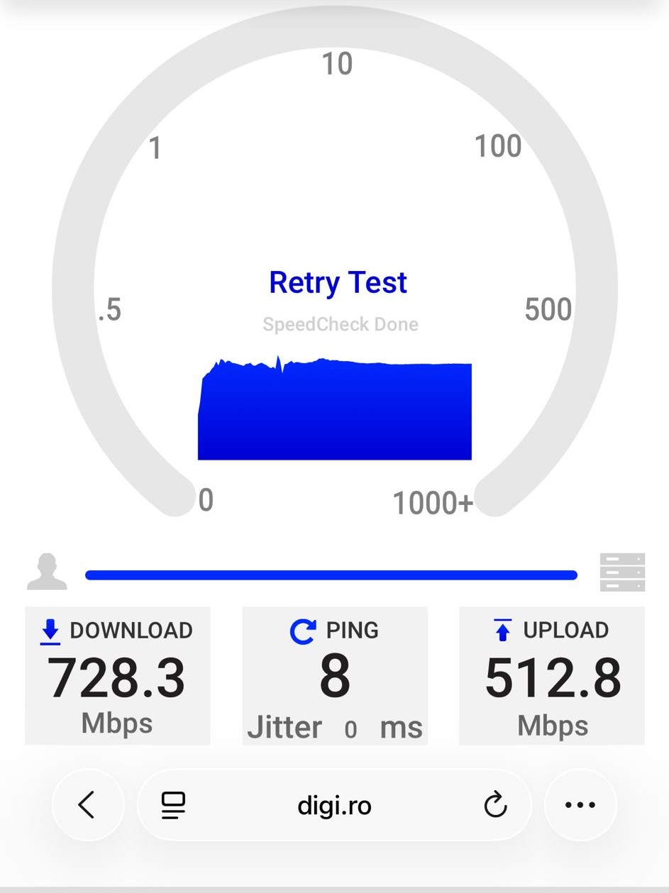

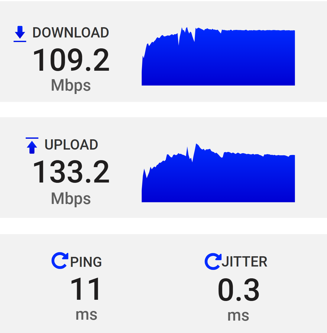

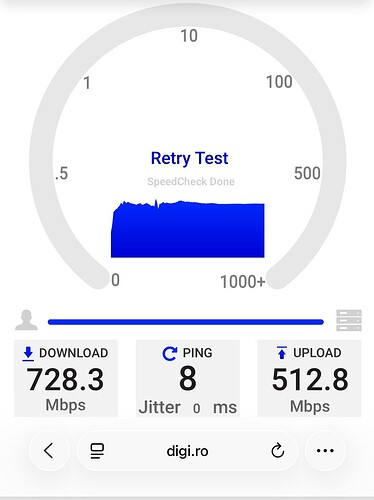

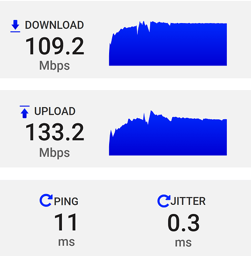

You think it’s too much? I am thinking in the condition that i already have a tp link mesh extender, and here are the results between near the router and the extender. I was hoping to get a better connection.
