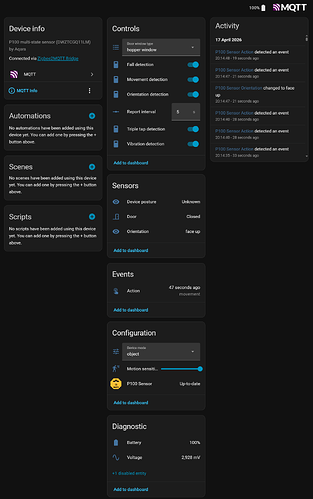

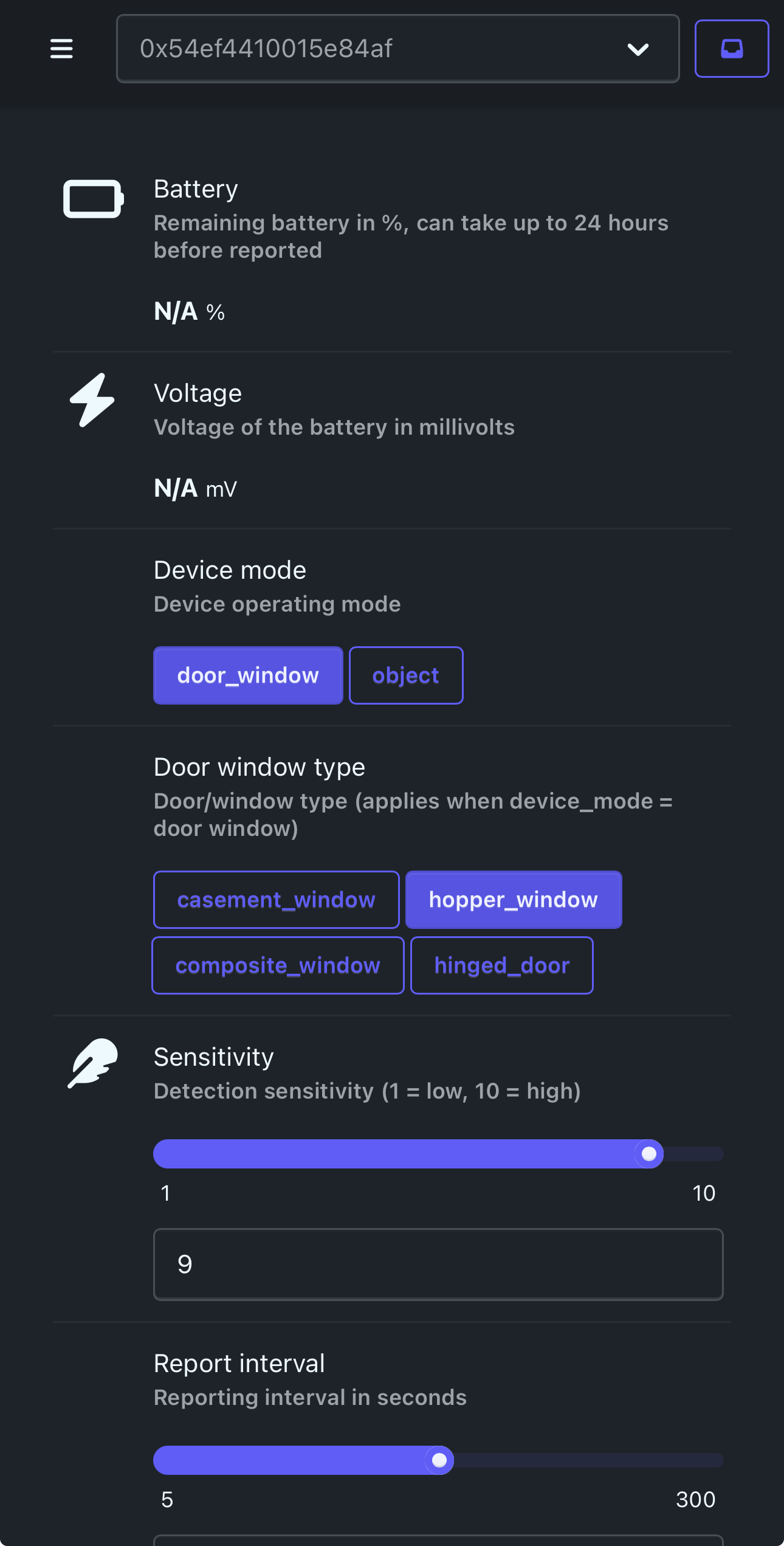

I just got a P100 sensor this afternoon and have a working Zigbee2MQTT converter done for it. It was reverse-engineered from Zigbee packet captures.
I think I’ve got every action and setting included, let me know if there’s anything missing. I’ll include any updates in the linked Github repository version.

Operating Modes
The P100 has two mutually-exclusive operating modes set via device_mode:
| Mode | Purpose | Active exposures |
object |
Watches an object for movement, vibration, tilt, tap, orientation, fall | action, orientation |
door window |
Reports a door/window as open/closed using internal motion inference | contact |
The event-enable toggles (movement_detection, vibration_detection, etc.) and door_window_type only have effect in their respective modes.

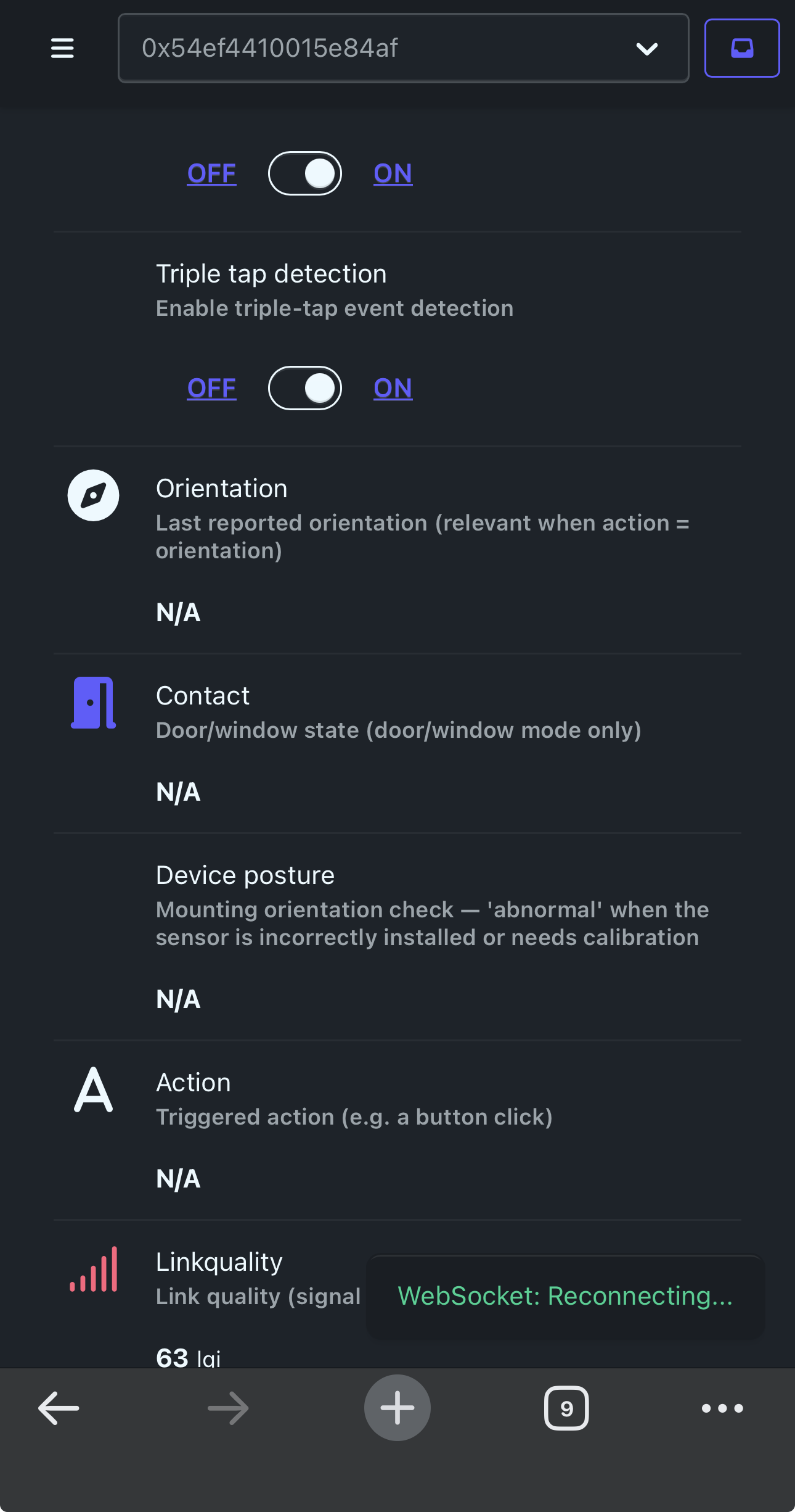

Exposures
Events (object mode)
| Exposure | Values | Notes |
action |
triple tap, movement, vibration, orientation, fall |
Published momentarily on each detected event |
orientation |
face up, face down, vertical, tilt |
Last reported orientation; meaningful when action = orientation |
Contact (door/window mode)
contact |
true (closed) / false (open) |
Derived internally by the device from its motion sensors — not an IAS contact sensor |

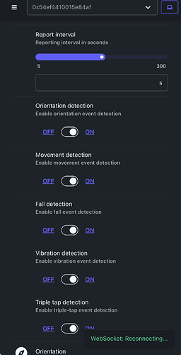

Settings
| Exposure | Type | Range / Values | Description |
device_mode |
enum | door window, object |
Operating mode (see above) |
door_window_type |
enum | casement window, hopper window, composite window, hinged door |
Door/window profile (only relevant in door/window mode) |
motion_sensitivity |
numeric | 1–10 | Detection sensitivity (1 = low, 10 = high) |
report_interval |
numeric | 5–300 seconds | How often the device reports state |
orientation_detection |
binary | ON / OFF | Enable orientation event reporting (object mode) |
movement_detection |
binary | ON / OFF | Enable movement event reporting (object mode) |
fall_detection |
binary | ON / OFF | Enable fall event reporting (object mode) |
vibration_detection |
binary | ON / OFF | Enable vibration event reporting (object mode) |
triple_tap_detection |
binary | ON / OFF | Enable triple-tap event reporting (object mode) |

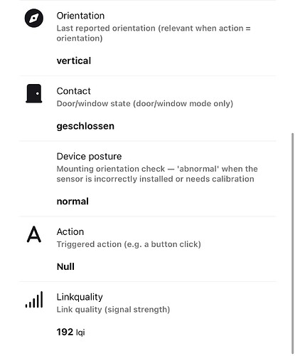

Diagnostics
battery |
0–100 % | From the Aqara bundled buffer (attribute 0x00f7, TLV field 0x18) |
voltage |
mV | From the same buffer (TLV field 0x17) |
device_posture |
normal, abnormal |
Mounting orientation check — abnormal when installed incorrectly or needs calibration |
How it appears in Home Assistant

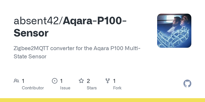

You can get the converter code from my Github repository (recommend), or copy it from below:
